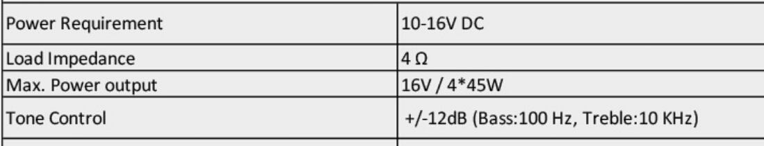

    Hello. Forgive me for creating a new topic. I have such a problem that I don't know much about car audio. I am going to buy a new navi radio for my Astra 2006 soon. Sxi version. I found one that is produced for Opel. But what speakers can I connect with what power? (I will buy the radio first, then the speakers) I attach a picture with the parameters of the radio.

    Why do you want to replace the speakers?
    You didn't attach the picture.

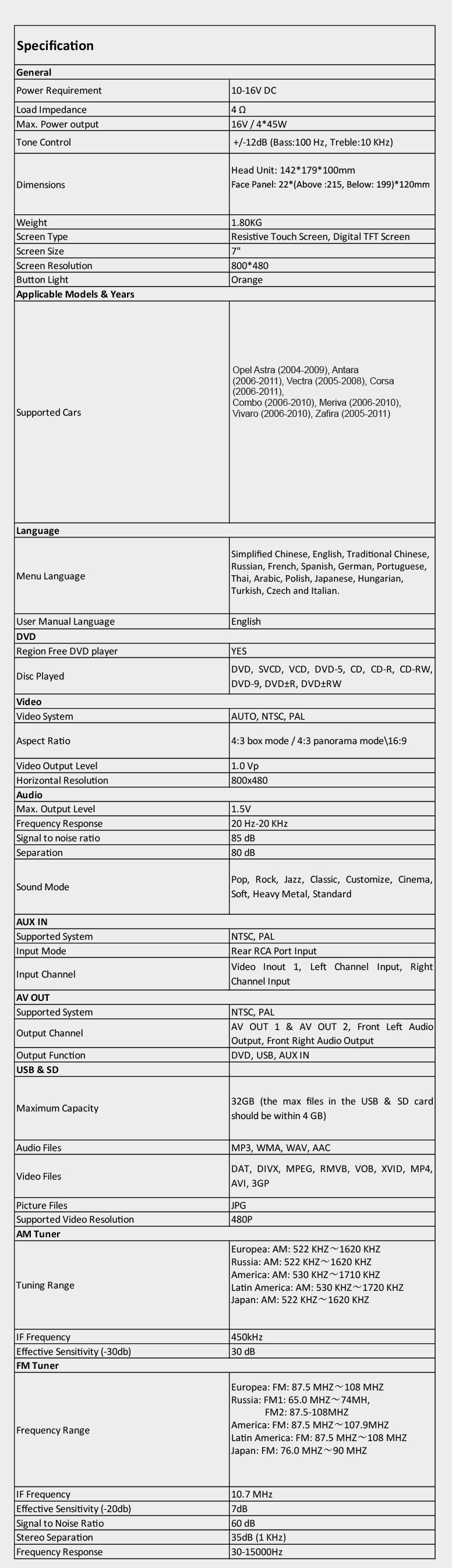

    Here are the full parameters.

    "Not clean" - means how? Wheeze?
    At the beginning change the radio itself, it can also be the reason for "dirty" playing, not the speakers themselves.
    What are your speakers there (16cm diameter)? Measure them and check that the diaphragms with the springs are not crushed / punctured / torn.

    They wheeze a little. Well, I'm going to replace the radio because it will be useful navi then see what is the reason. And I just wonder because the radio has 16v 4 * 45, or 45 is the rms value? If I replace the speakers with a speaker above this value, will it burn them?

    No, this is the maximum power. 4x45W rms radios have around 20W
    If you give a speaker that requires more power, the radio will simply not move, i.e. it will play quietly and practically without bass.
    So as they grunt, remove the grilles and check if the membranes are not able to disintegrate. If they are and you have to change them.
