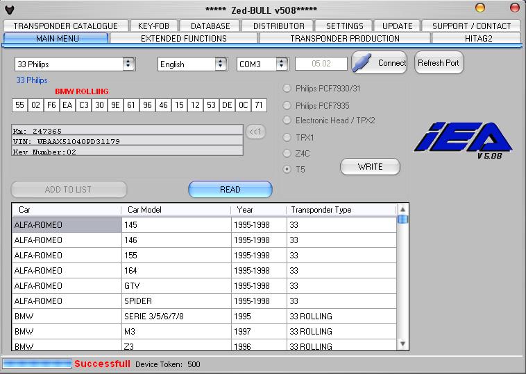

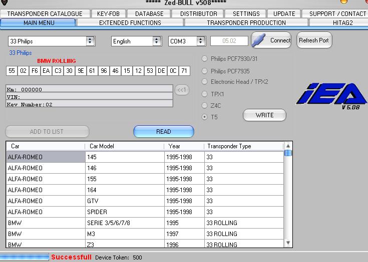

  • #3 16336546
    krzysiek.kris0016
    Posts: 26
    the first photo has an ori key and the second photo
    E46 Transponder Copying: Using Smart ZED BULL for N42B20 Engine to Assign New Key Code E46 Transponder Copying: Using Smart ZED BULL for N42B20 Engine to Assign New Key Code

    Rate: 5052
    Is it only reading from the key or was the device connected to the car and is it reading from the car or from the EWS file?

    Rate: 5052
    If it reads you mileage and VIN and there is no such thing on the second transponder, then make the conclusions yourself.
    Unless this data is made up by this device.

    Posts: 26
    Mileage and vin taken from the key and true.
