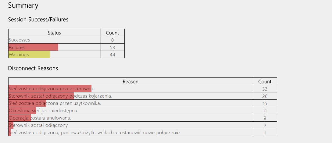

    - I followed the steps on the Microsoft website:

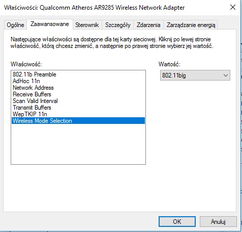

    - in the properties of the network card I turned off "allow the computer to turn off this device to save power" and changed the following values (it was: "long and short" and "Auto")
    ASUS K53SV Laptop (Win10, 64bit) Detects Only One Wi-Fi Network: Qualcomm Atheros AR9285 Issues ASUS K53SV Laptop (Win10, 64bit) Detects Only One Wi-Fi Network: Qualcomm Atheros AR9285 Issues
    (someone in a thread recommended it)
    - I turned off the firewall
    - I diagnosed the connection

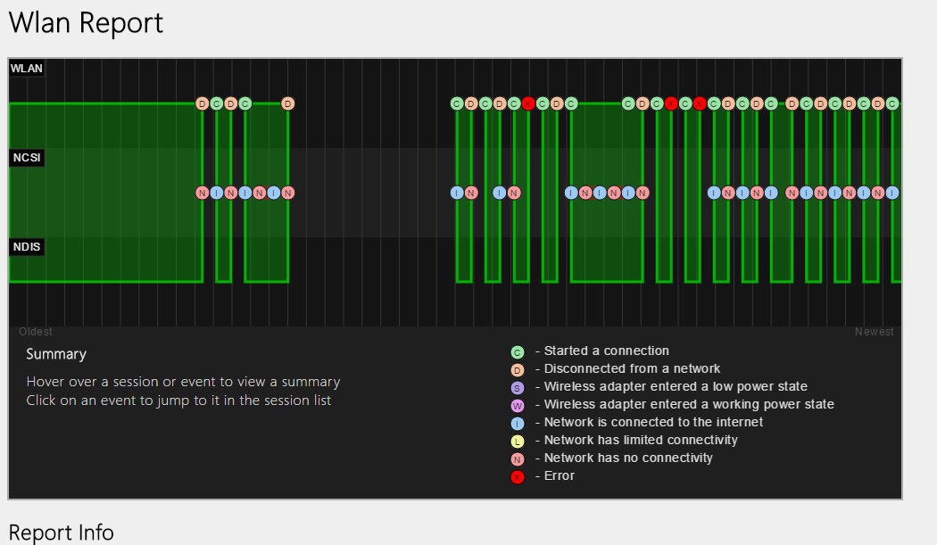

    - I generated the report via the command line (netsh wlan show wlanreport)
    even if something helped for a moment, it didn't solve the problem. He's still just catching one net and he likes it. I am asking for help and advice what I can do and what is wrong with the laptop. Is this Windows' fault? Cards?

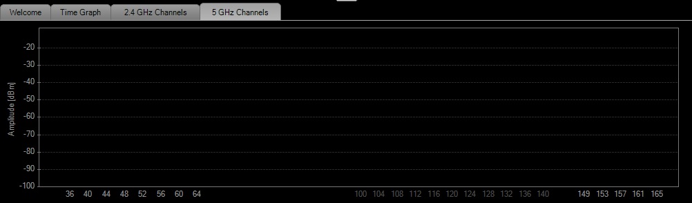

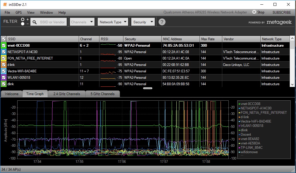

    Install inssider 2.x / home, scan the network, show tabs time graph, 2ghz, 5ghz
  • #3 16335988
    maggajwerPL
    Posts: 24

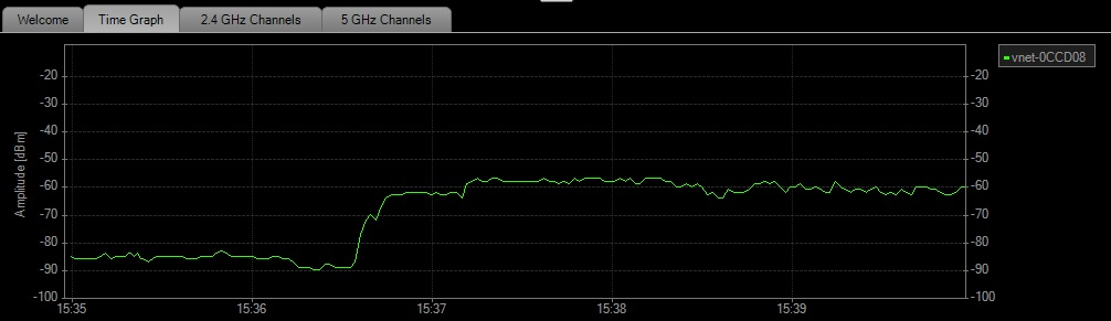

    Results from InSSIDera:
    in general, he found only one network:
    5GHz both closer and further away from the router

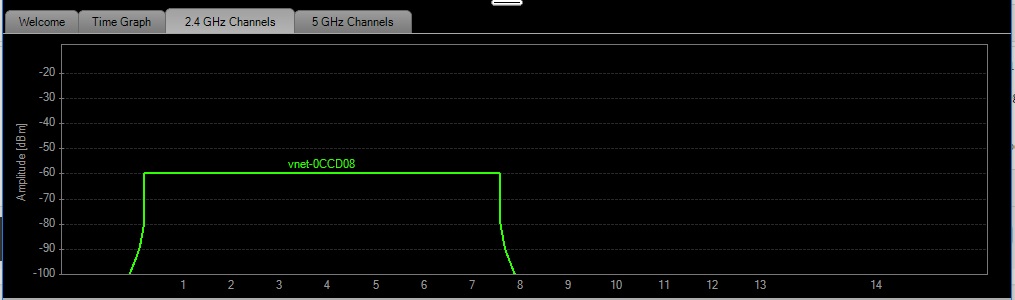

    2.4GHz closer to the router (approx. 5 cm)

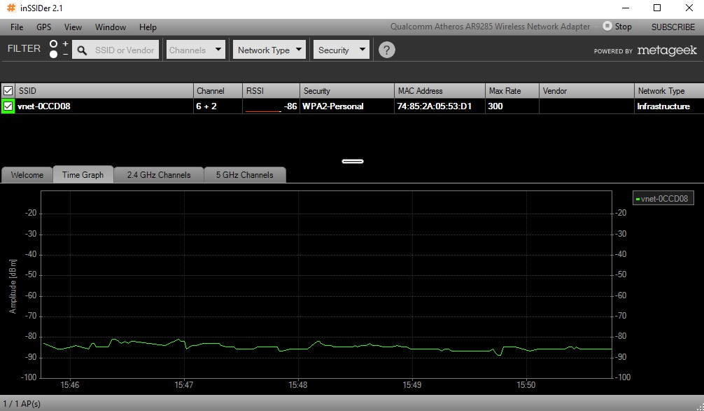

    Time graph closer to the router (approx. 5 cm) higher part of the graph (on the right), further away from the router (approx. 3m) this lower part of the graph (on the left)
    2.4GHz further from the router (approx. 3m)

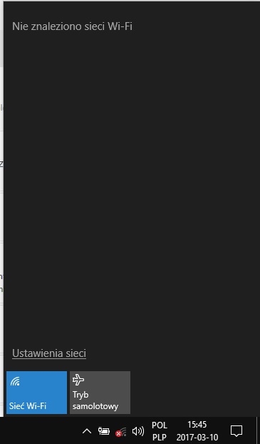

    Often, despite the available networks, it is shown:
  • #4 16336000
    bogiebog
    Posts: 24793
    Help: 2569
    Rate: 1530
    -80dbi - it will break and interrupt connections.
    Min you need -70dbi.
  • #5 16336016

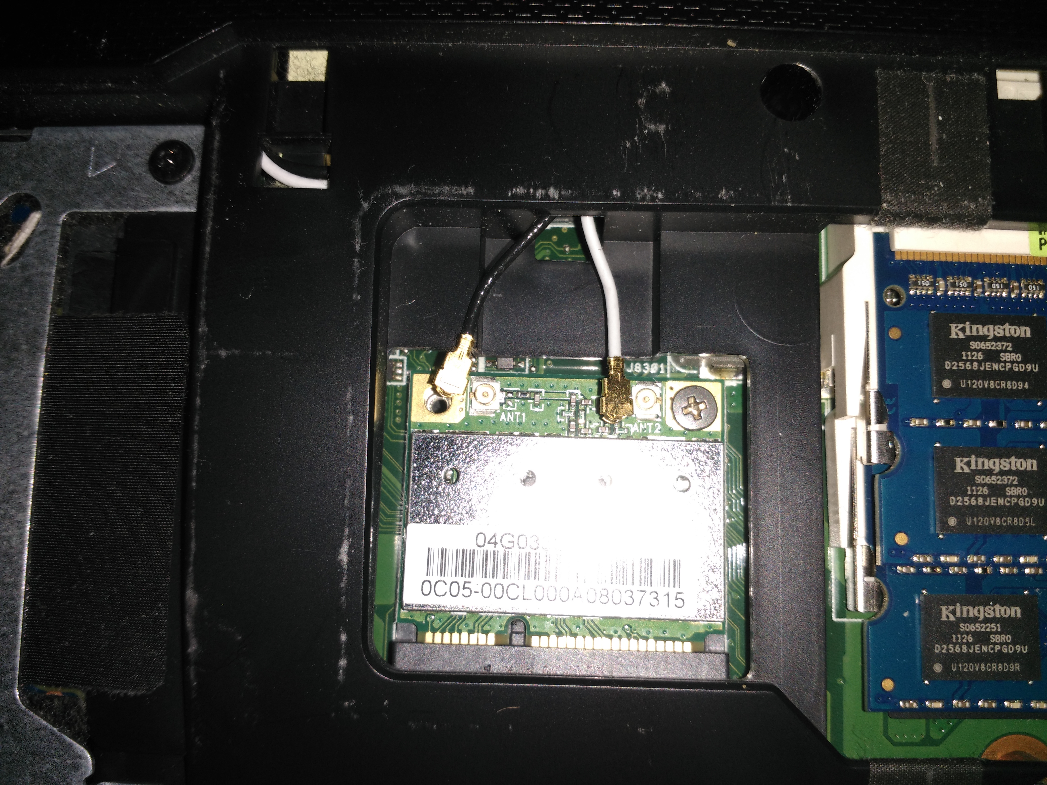

    As for the issue of loosening the antenna, this seems to be an interesting clue, because the computer recently returned from the site, where it had the power socket replaced ... Maybe the service mixed up something there.

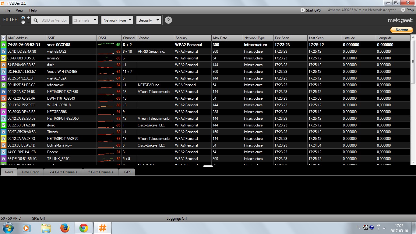

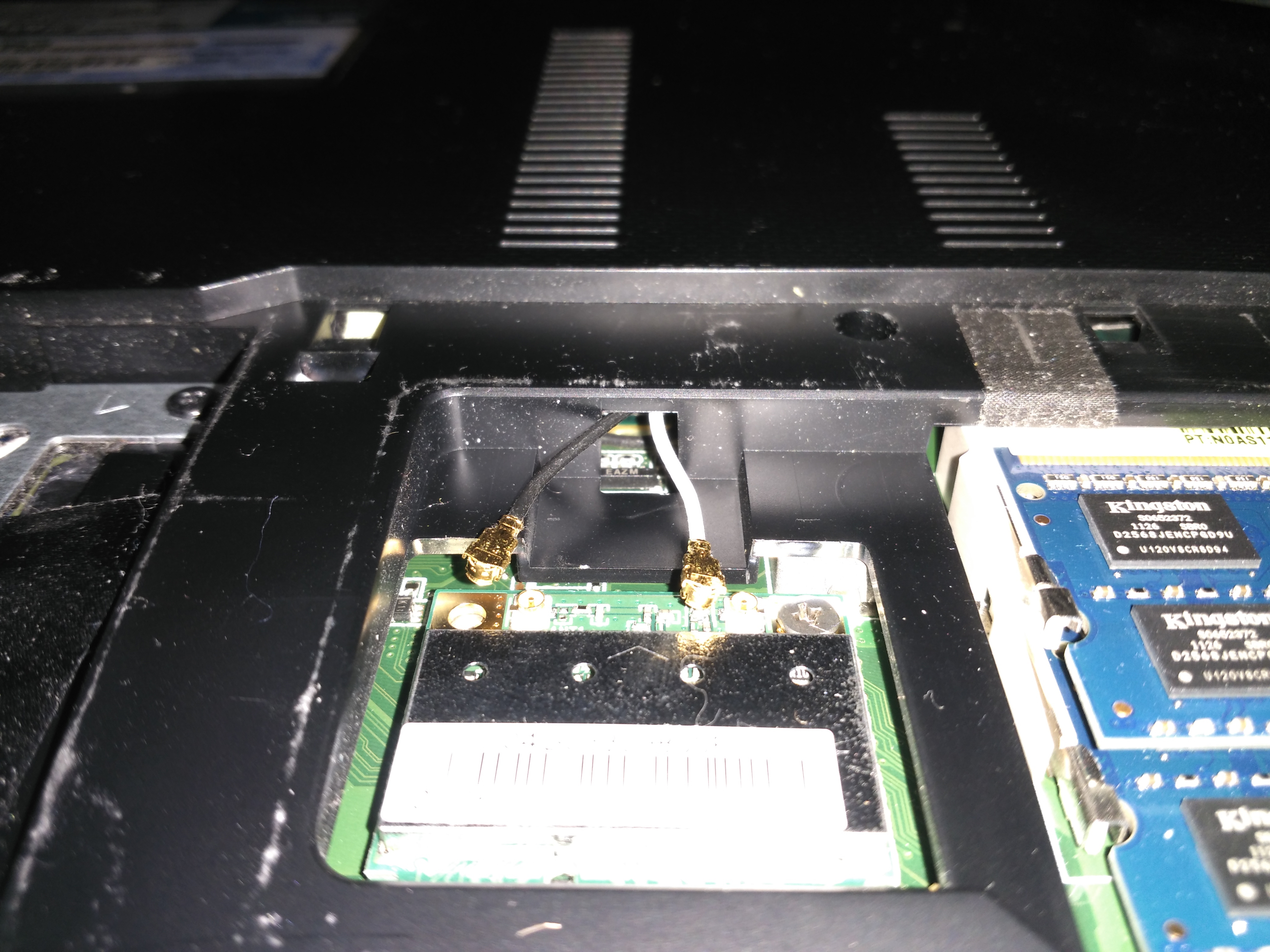

    Thanks a lot god! I think I've really done everything the internet has anticipated in order to get rid of this problem. Only your advice with connection turned out to be accurate :) I don't know much about computers, but access to the card in my Asus is very simple (2 screws) - I Google Google what it looks like and I managed to track it. It looked like this:
    Generally 2 of these cables disconnected, zero even contact. I put in 2, everything flashes.

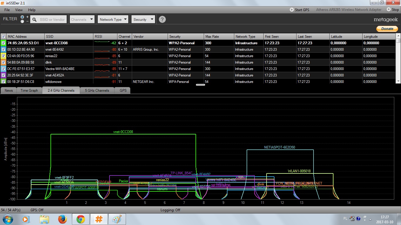

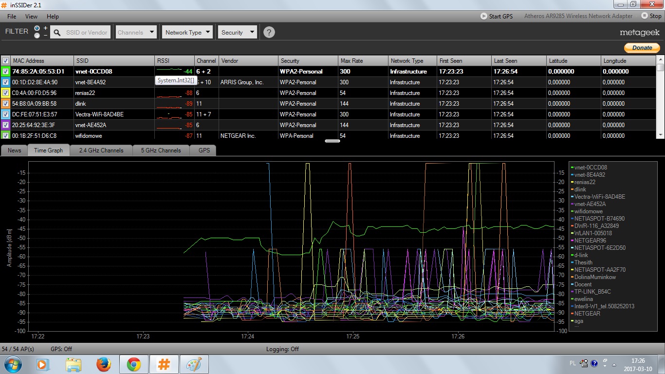

    Screen from inSSIDera now:
    Well, they changed the power socket but they didn't remember connecting the cables ... Thank you again :) greetings
