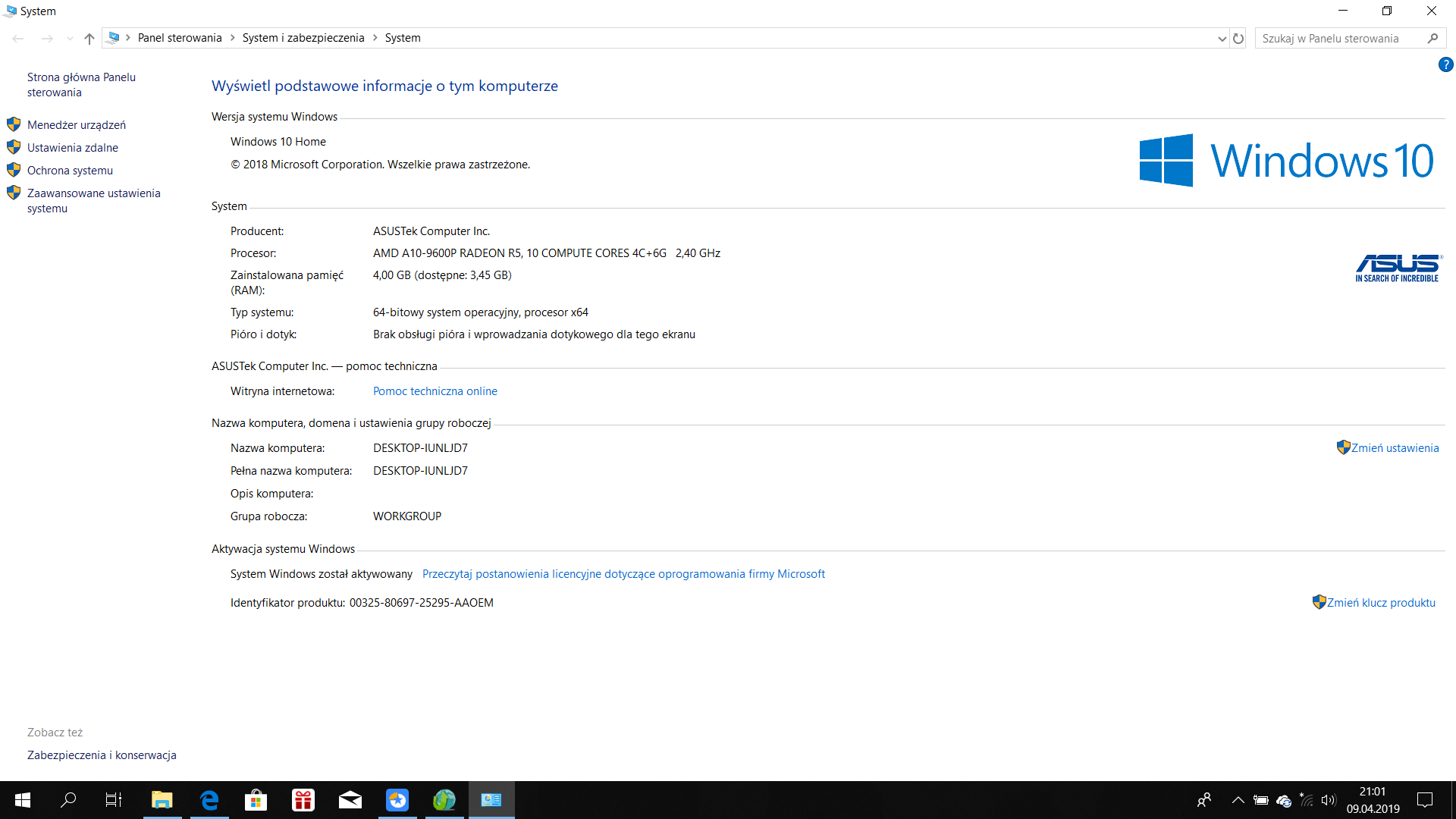

    I have a problem with the WiFi network. While using the computer, the network disconnected at some point and since then I have not been able to connect to it. When trying to connect, it shows the message "Unable to connect to this network".
    I know that the topic has already appeared, but in my case the solutions mentioned do not work.
    I tried to forget the network, clear the network memory in the system, change the router security and nothing.
    Unfortunately, I do not know computers at all, so I will be grateful for any help.

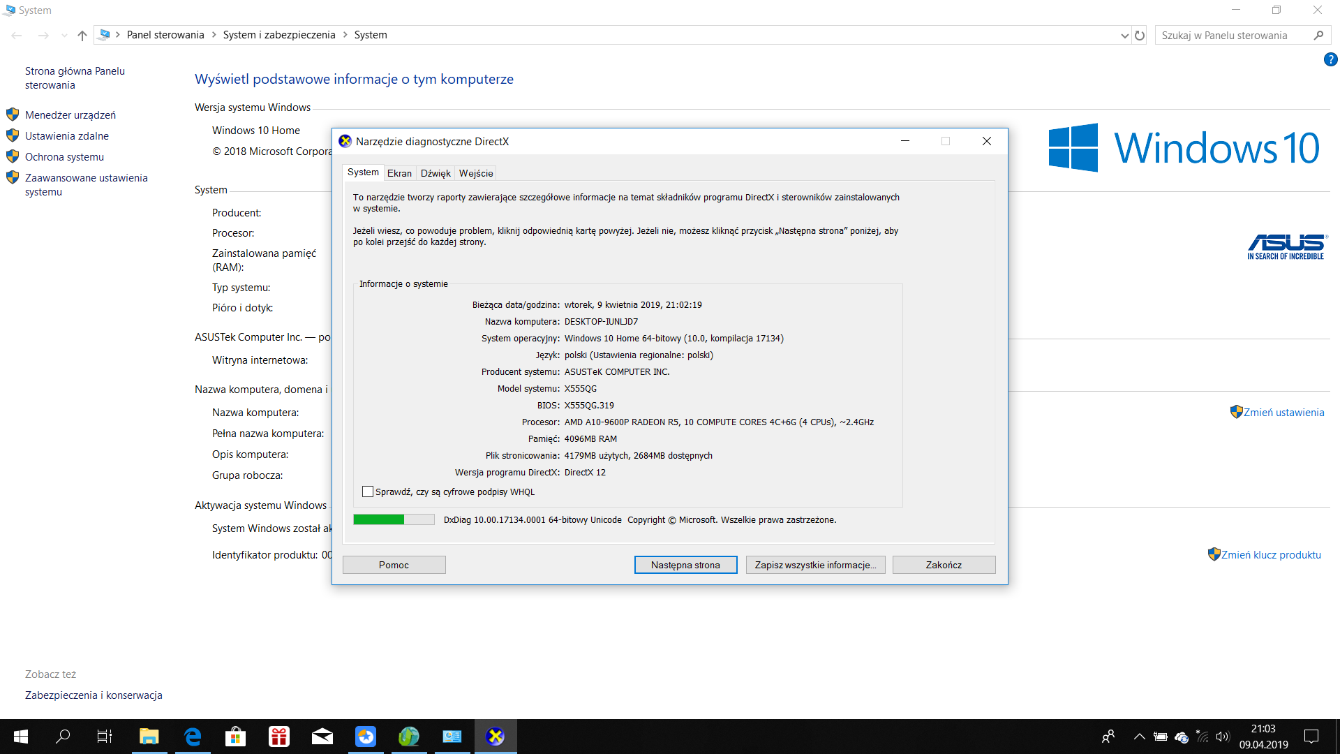

    Freia
    Posts: 9
    Rate: 18
    Okay, so in more detail, I have the ASUS X555Q laptop. In the screenshots I am attaching the system and network cards. Which model should I check? I cannot physically access the router, but there is Netia, it has the software version: 5.4.8.2.126.
    I'm sorry if I screwed something up and did it wrong, but I'm not serious about it: p
