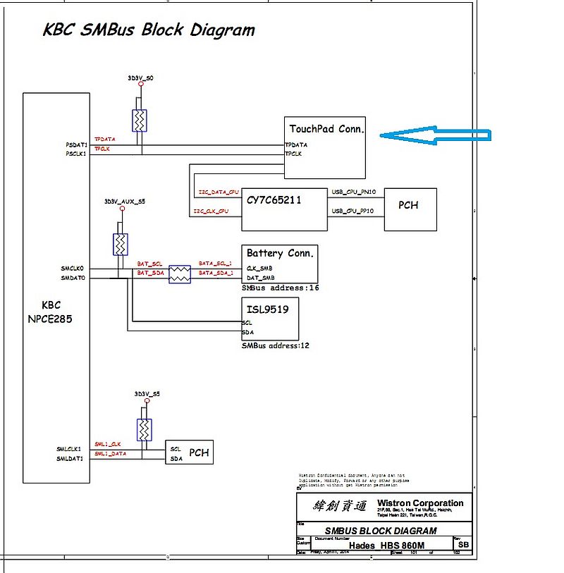

    I warmly welcome. I have had a little problem with the touchpad on my laptop since yesterday.
    When I touch the touchpad, the laptop screen automatically turns off, pressing any key, the screen turns on again.
    The mouse is connected to a laptop via USB and works fine. The situation is quite unusual, because the touchpad only turns off the matrices in the laptop, and the laptop works normally.
    I updated the drivers in the touchpad and looked for similar problems on the Internet, unfortunately I did not find anything similar.
    I will be grateful for any help on this topic.
    greetings

    In my case, the problem is the touchpad. I can press the case around the touchpad and nothing happens. I touch the touchpad anywhere, the screen turns off.

    Well, look for SM for this model
    Acer Aspire VN7-591G / and VN7-571G
    - eDP matrix
    - kbc NPCE285PA0DX
    - HM86 chipset
    -charger_switch. power supply of the BQ737
    - platform (Wistron HADES_HBS)
    * it should write on the disc: 14206-1 448.02W02.0011)
    Touchpad Screen Turn Off Issue - Acer VN7-591G Laptop: USB Mouse Works, Driver Update
    both signals go to kbc
    TPDATA on pin 71
    TPCLK on pin 72

    I would check it on another system - e.g. linux live cd.

    Good idea with this Live CD, and only the "spot" of damage will be credible.
