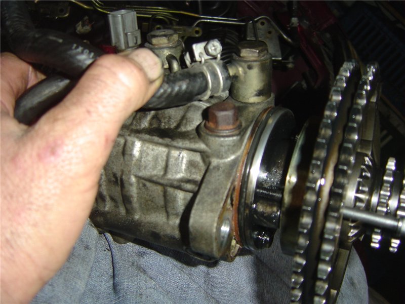

    Hello, I bought a Nissan with a damaged engine, everything assembled as it should be, the only thing I did not look at when disassembling the timing chain to set the injection pump, timing set on the signs, in the autodata there is no exactly described photo in what position the pump is to be located for me at 12 o'clock, I would be grateful if someone submitted a valve in this model for some information. A lot of information on the internet is about the D40 and this is already common rail and there is no such problem.

    The photo is not my own, found on the network, and the pump from the 2.2 engine with X-Tail not 2.5 but they are almost the same engines. Ask here.

    I don't know any other pump from your photo, it looks like this Nissan Navara D22 Engine Assembly: Injection Pump Timing, Valve Info, and Comparing D40Obraz 0...jpg (4.27 MB)You must be logged in to download this attachment.

    For me, this blockage on the mounted pump is so inserted and I just don't know if it's good, the problem is that when disassembling everything I did not turn the shaft until everything comes to the mark and I do not know if it was not a mistake, in addition to the pump in I didn't notice at all. Nissan Navara D22 Engine Assembly: Injection Pump Timing, Valve Info, and Comparing D40Obraz 0...jpg (5.66 MB)You must be logged in to download this attachment. Nissan Navara D22 Engine Assembly: Injection Pump Timing, Valve Info, and Comparing D40Obraz 0...jpg (5.63 MB)You must be logged in to download this attachment.

    No other, because it is a toilet pump with CR. I meant the blockade itself. It looks good in you. After that, there should also be "signs" on the bottom chain

    I have already established when it comes to setting the pump and it turns out that it is well set, i.e. as I thought, nothing can be moved because the pins do not match, but the car still does not smoke, the issue of immo, and the pump controller because after cutting the cables to the fuel dose valve no reaction 55w light bulb after turning the starter. The question whether if the immo is triggered such signal should be or not.

    Hello. Well in my opinion it is a pat pump controller.
