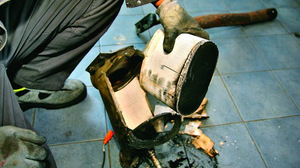

    I have vw golf V with 1.9dpi engine code: BLS 2009. mileage 220kkm
    It has a dpf filter which is slowly coming to an end, ie it is filled with 53 / 60grams soot
    I would like to delete it this year ie dpf and turn it off, of course, and also to blank off egr and turn it off.
    But I would not like to have any problems with the review, etc. So I would install a regular new catalyst also from golf v only from the 1.9Xi BXE engine. the cost of a new kata 1300zł so not so much and especially that dpf for sale for about PLN 500 and I will be quiet.
    And now the question was being done by someone like you?
    Cat should match p & p instead of dpf?

    Hmm, what's the catalyst for DPF? As far as I know, there are two different devices and they have a completely different role.
    The catalyst reduces CO, HX and NOx, and the DPF filter retains solid particles (soot). Some newer engines use a catalyst and DPF.
    Also, in my opinion, replacing DPFa with a catalyst will not give you much.

    Are you doing the eye or is it okay at the review? If for the second reason it does not make sense.
    Do you sometimes have a catalyst anymore?
    There should be a catalyst and filter in one housing.

    Well, this is the kat first and then the particle filter in one can. I would like to delete it but I do not want to leave an empty can. That's why I would install a much cheaper ordinary catalyst from a 1.9 tdi bxe engine

    You did not answer the question.
    You probably do not know what is the task of the catalyst and which filter.
    It will not meet the standards, so work only for the eye, if it's just for the eye to throw the filter out of the can and leave the rest.

    But for me there is an angle and a particle filter as one contribution I can not pull out the particle filter itself.
    I wanted to do this but unfortunately I can not do it

    I did not cut up but here the quote from another forum user in the subject of this filter "Sorry, I did not see the question, do not bother, generally turbo quite slows down the exhaust so no negative effects are silent, maybe only that at the final silencer a bit more turbo and so much but this As for the sequence, it is YES always the turbo first is the catalyst then the DPF and then the silencers, etc. In 1.9 DPF and KAT together is not in one sense only as one ceramic cartridge, "
    Added after 9 [minutes]:
    milejow wrote:
    Wyciecie is not the removal of the puff only to her, you now understand?
    I know what it is that the cartridge is thrown, not together with the can but for me, as far as I know, there is a kat and dpf as one ceramic cartridge and it is physically impossible to separate it
    Added after 12 [minutes]:
    Vw Golf V 1.9tdi BLS 2009: DPF Replacement with 1.9Xi BXE Engine Catalyst - Experiences? Vw Golf V 1.9tdi BLS 2009: DPF Replacement with 1.9Xi BXE Engine Catalyst - Experiences? Vw Golf V 1.9tdi BLS 2009: DPF Replacement with 1.9Xi BXE Engine Catalyst - Experiences?
    That's how it looks
