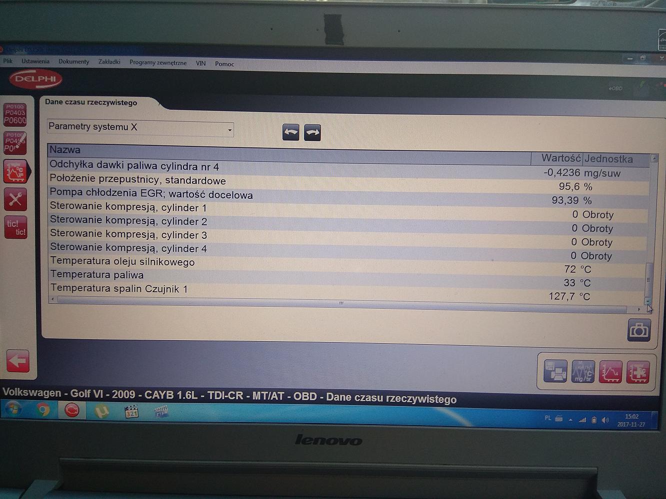

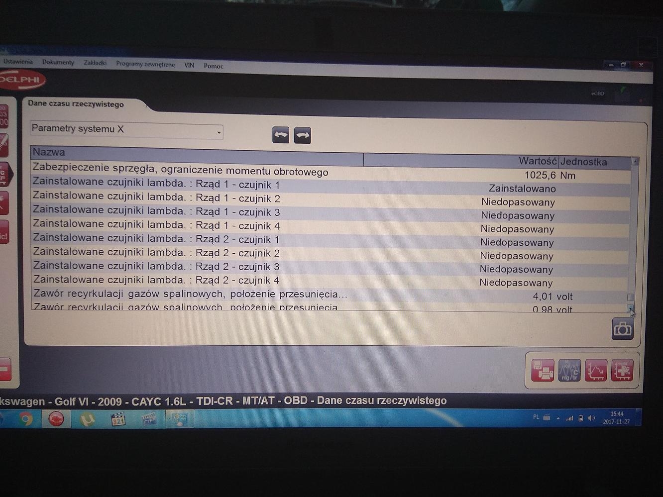

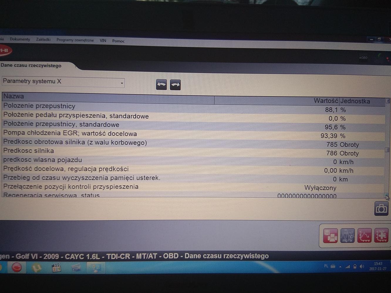

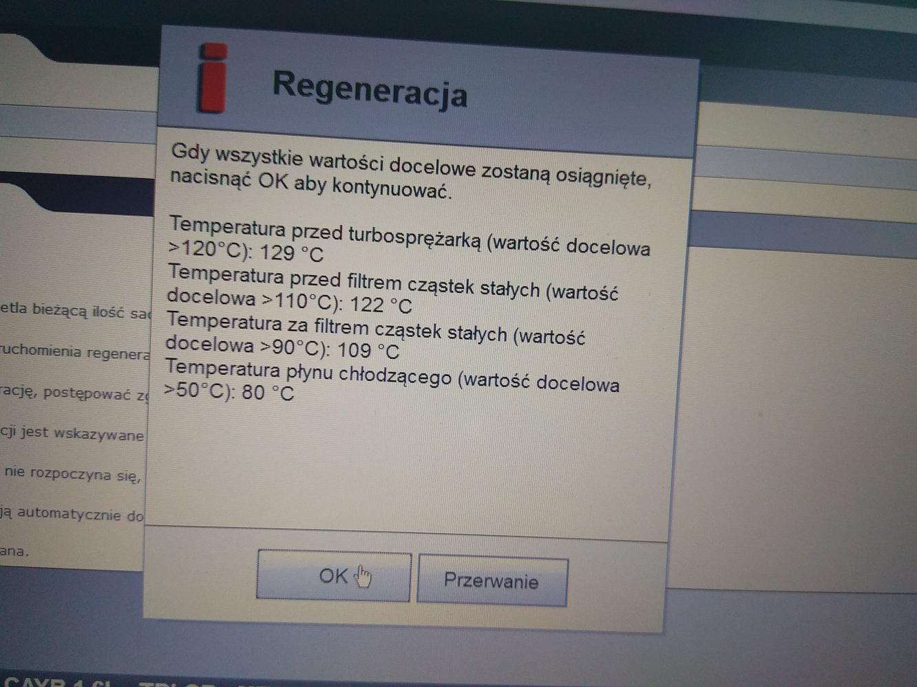

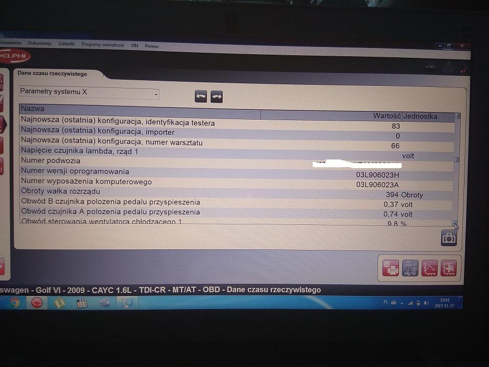

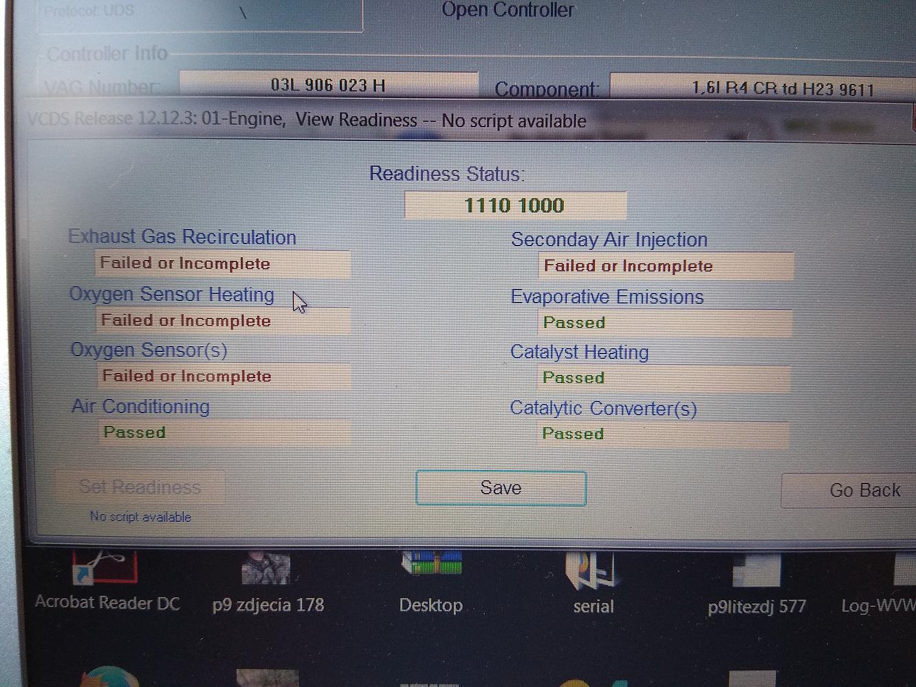

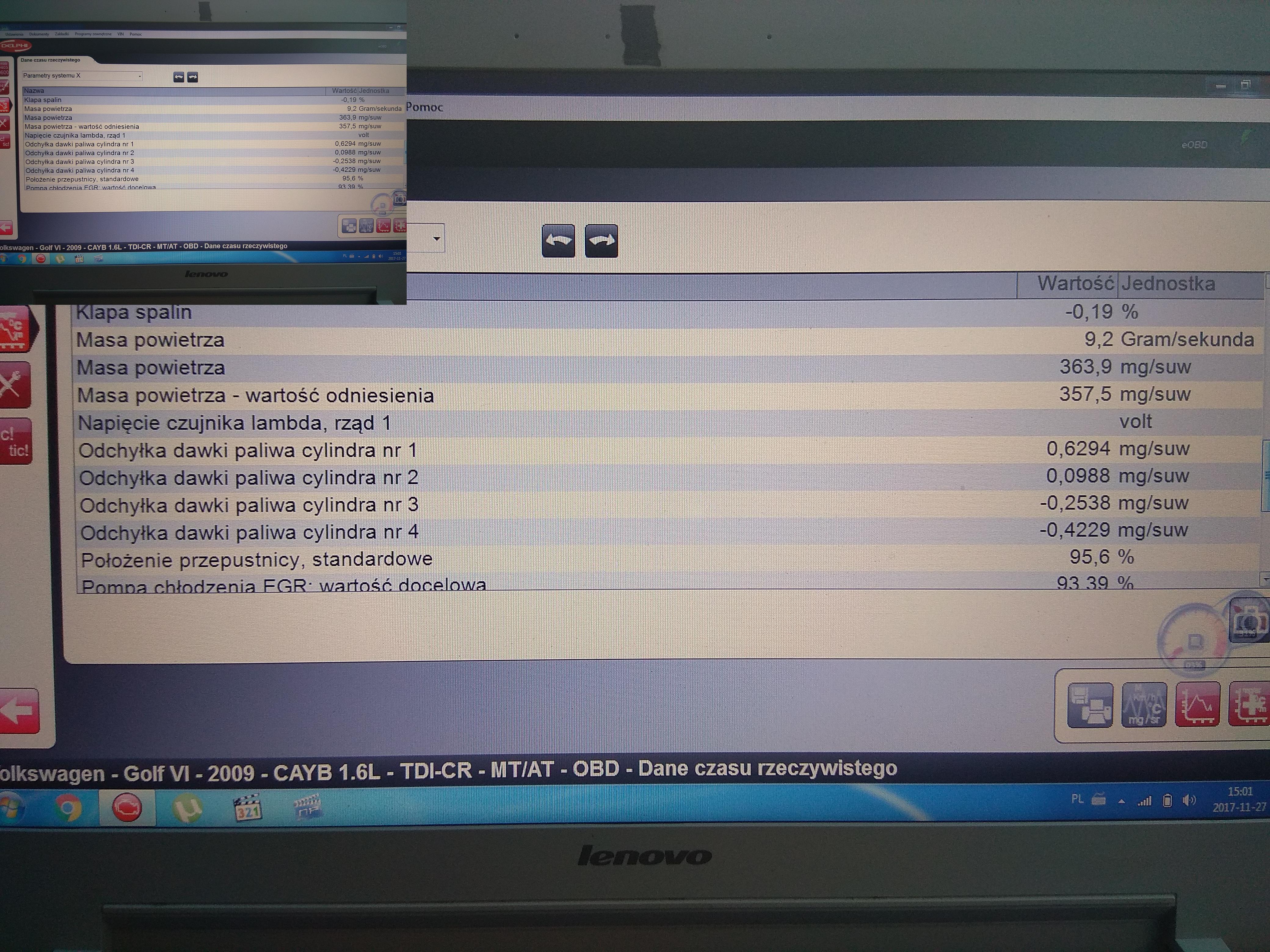

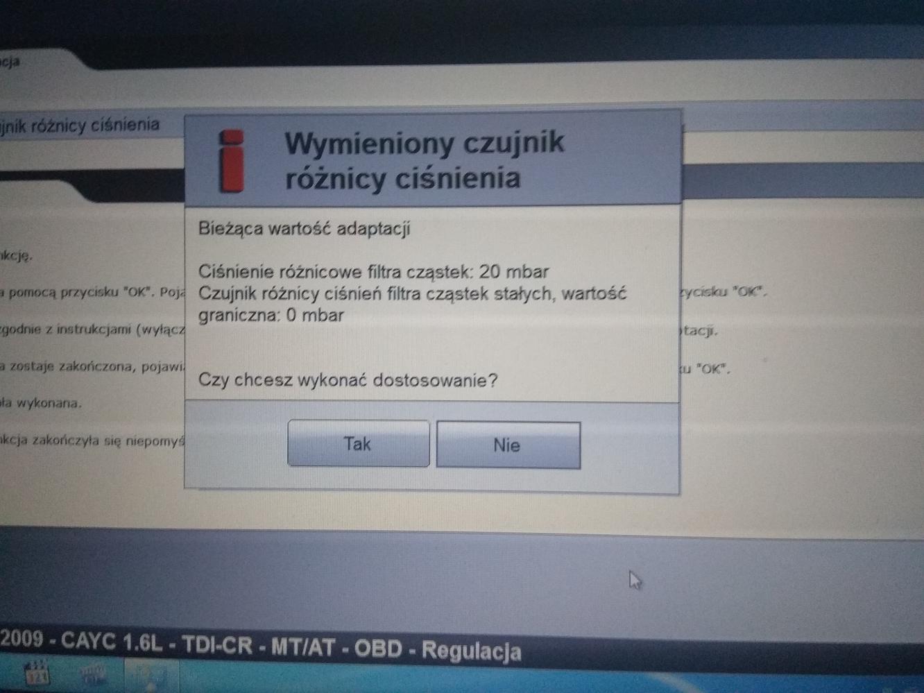

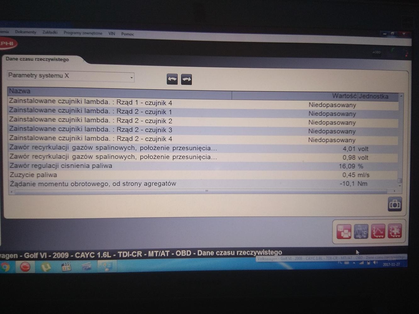

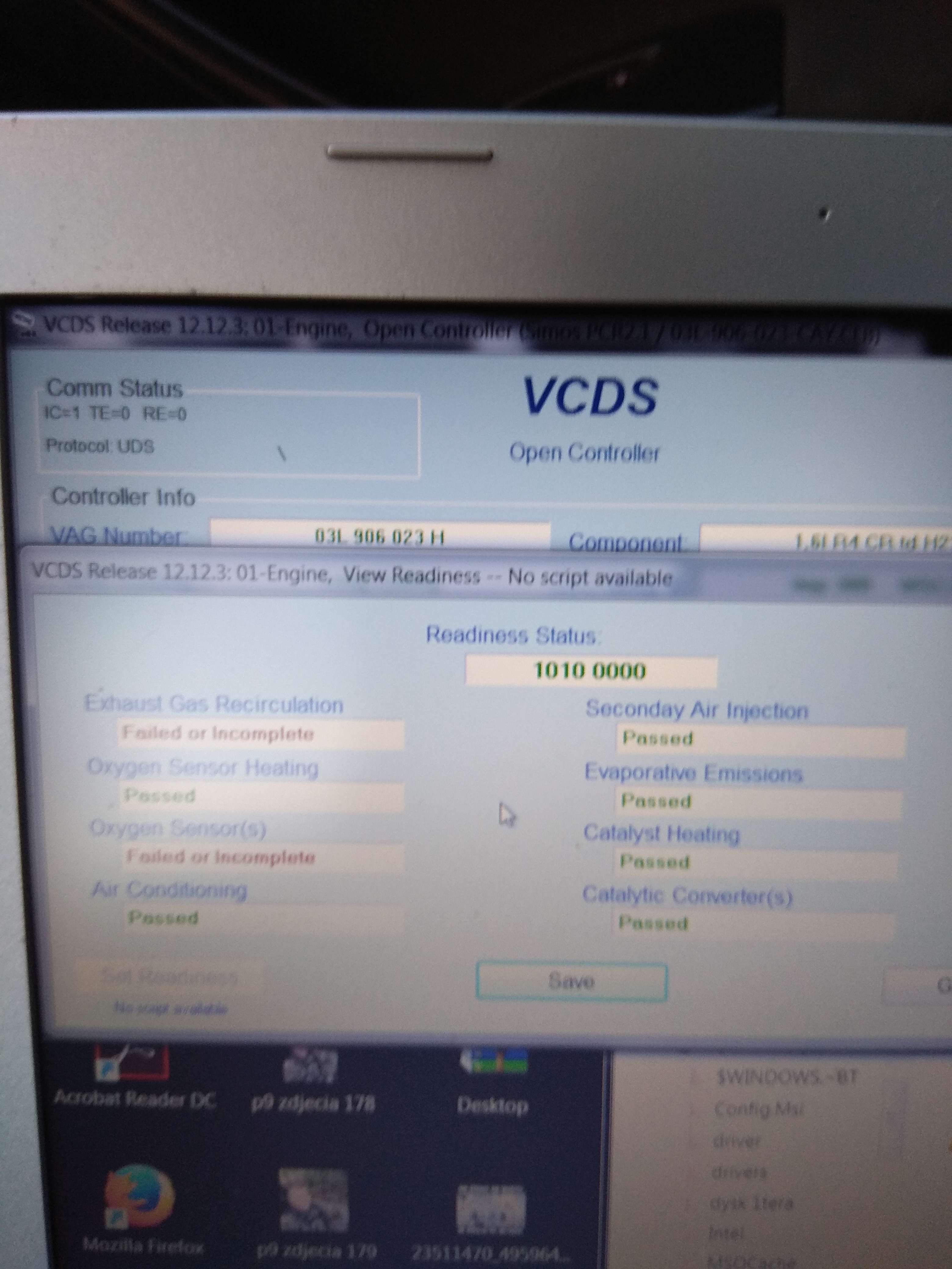

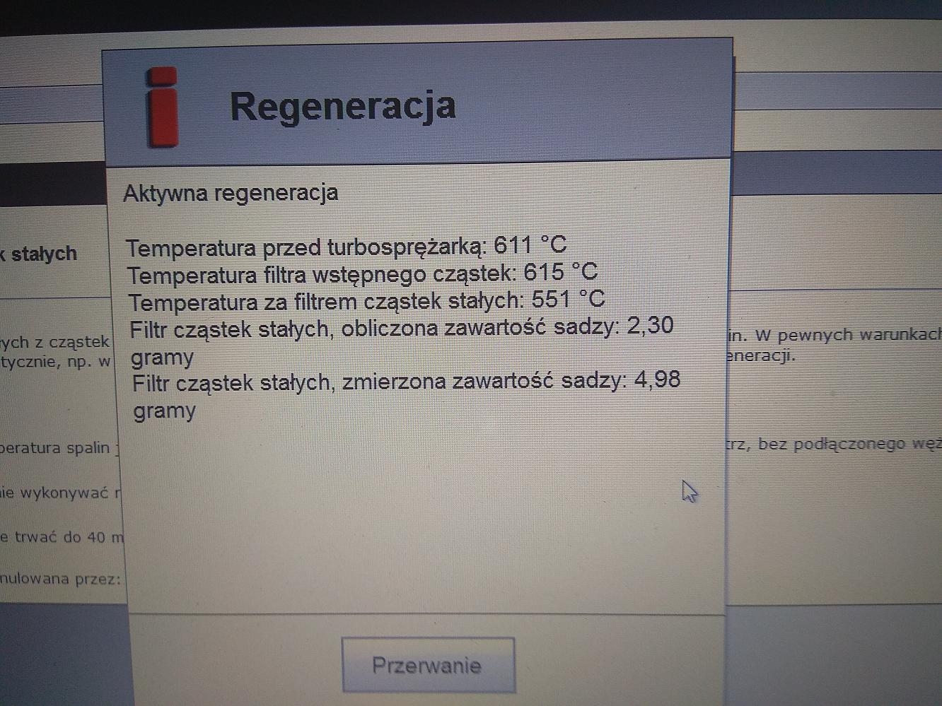

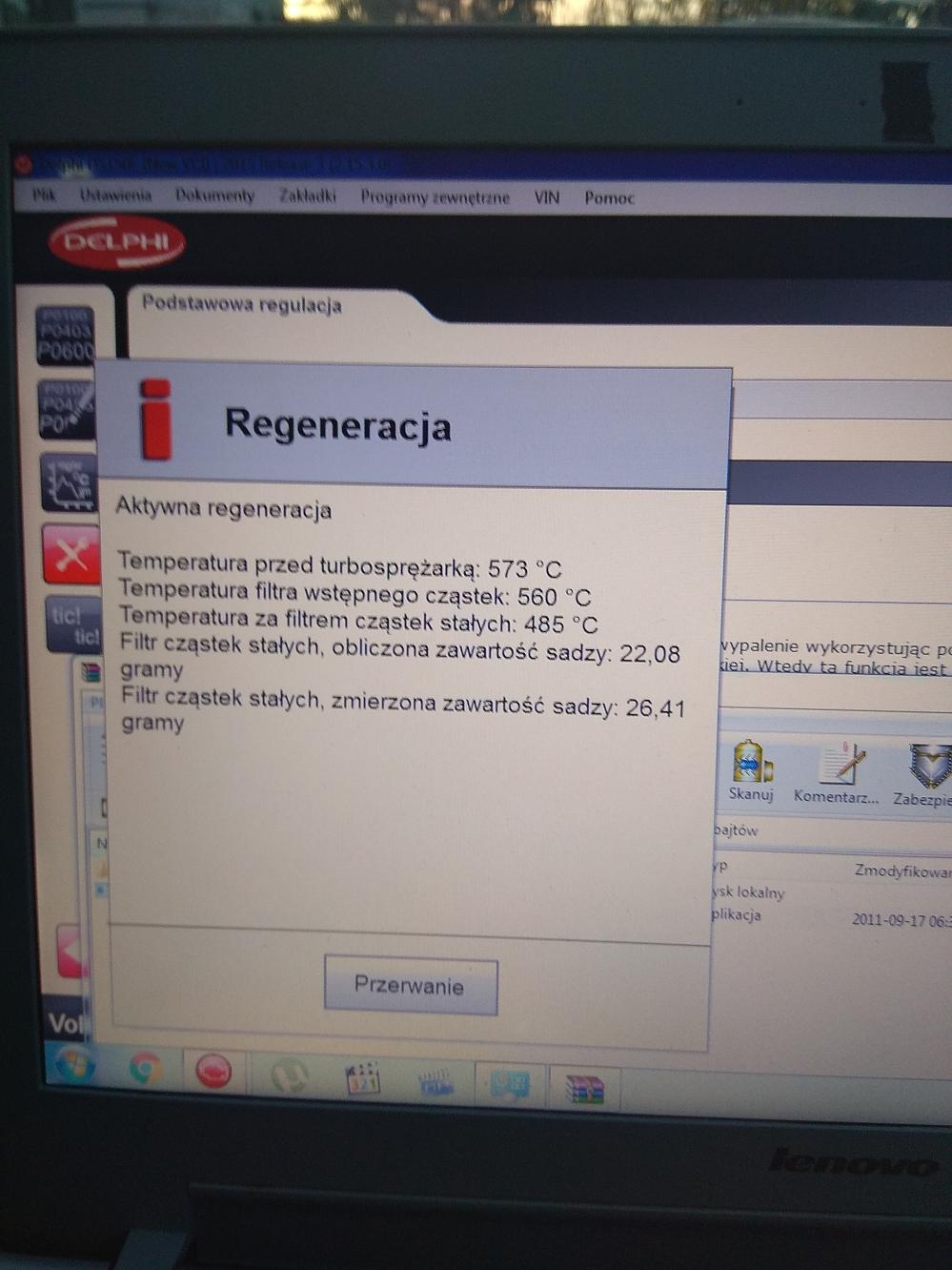

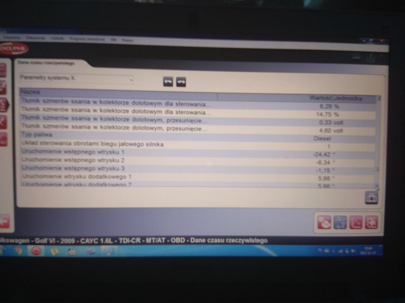

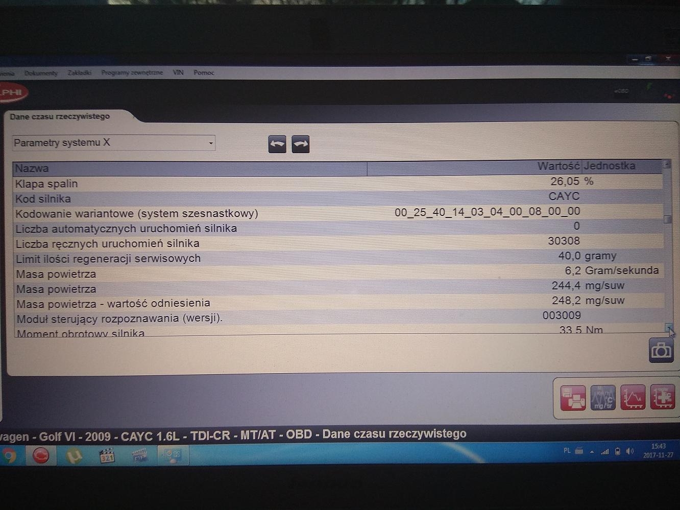

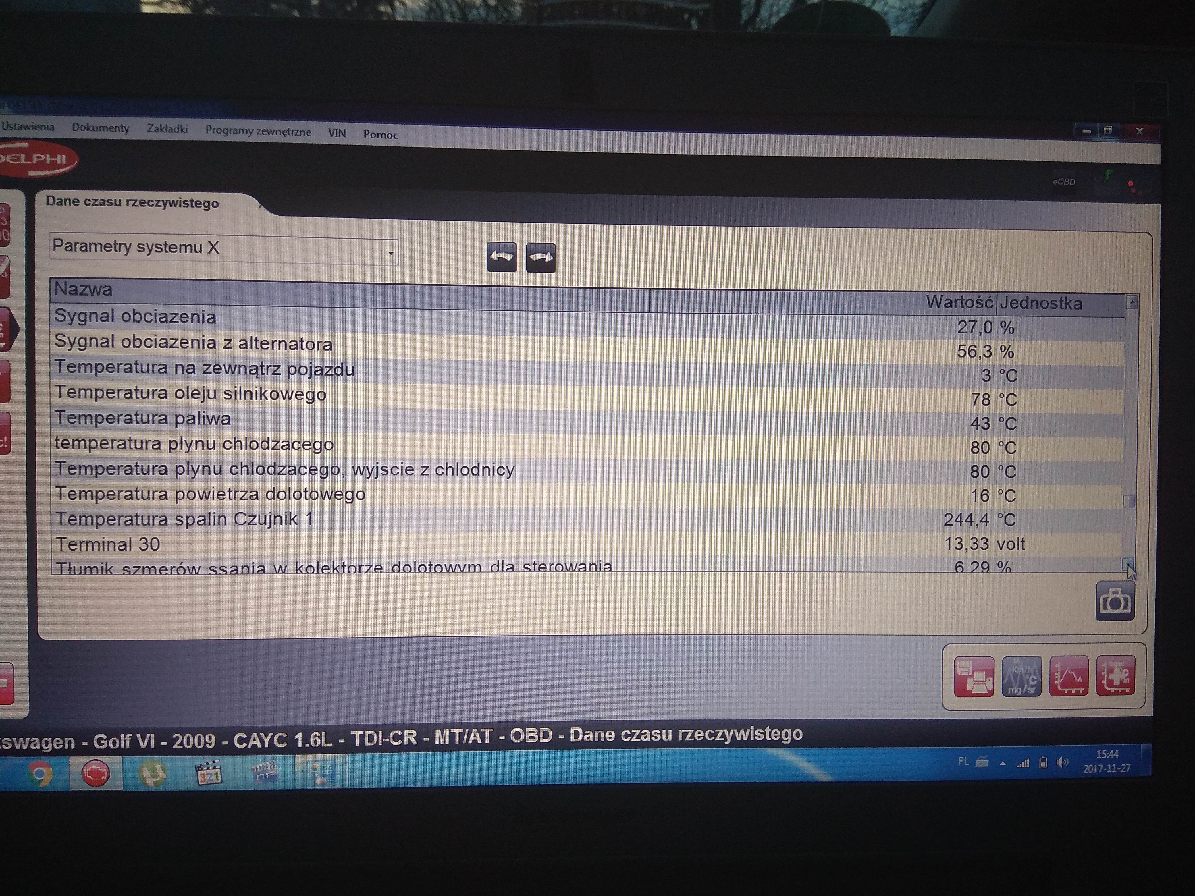

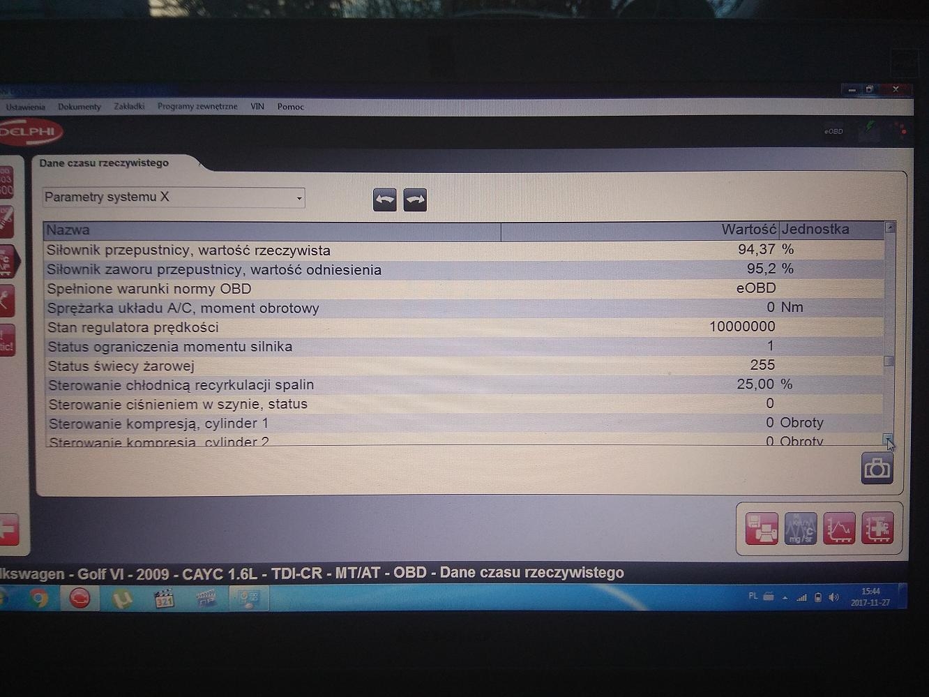

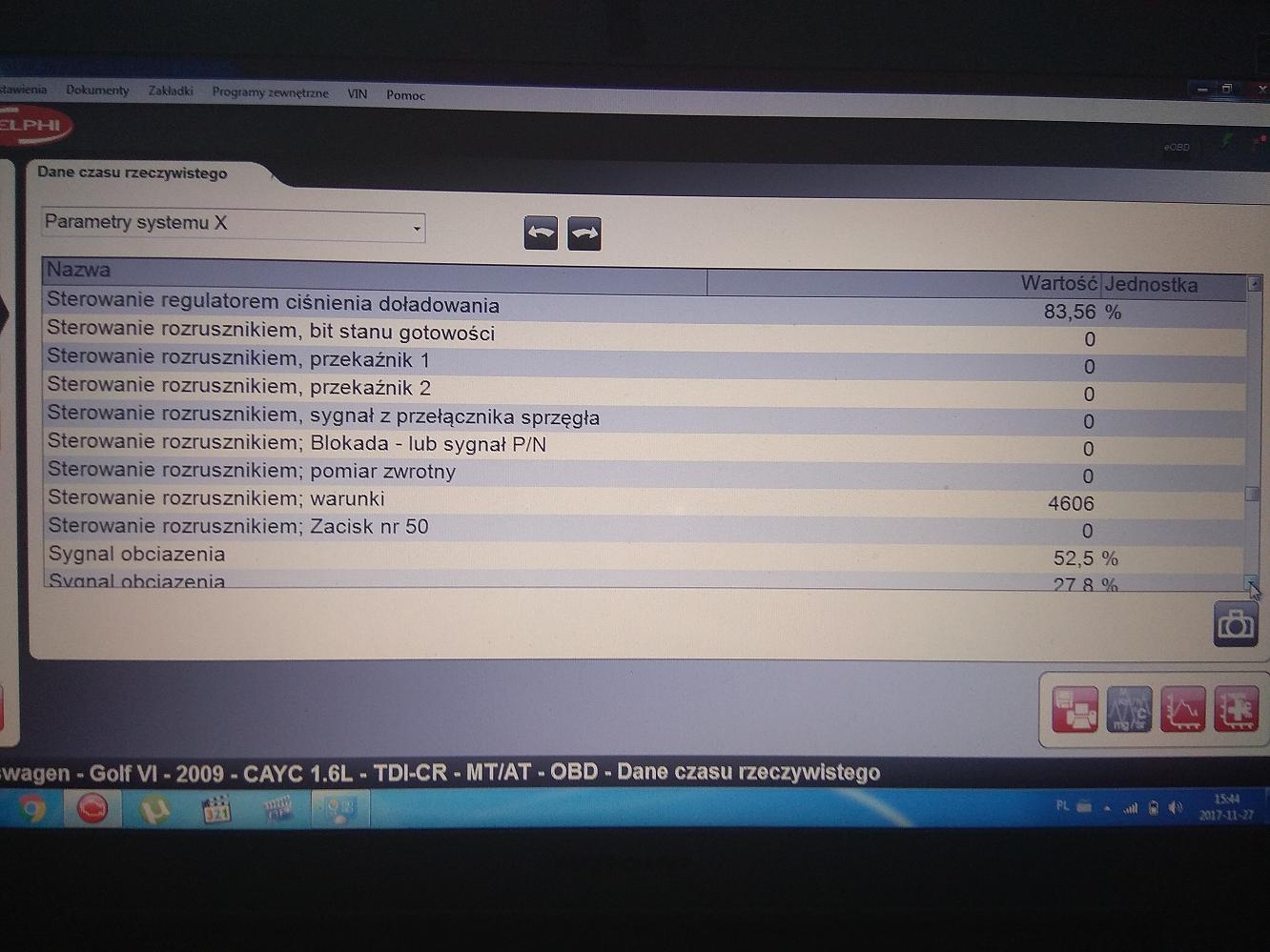

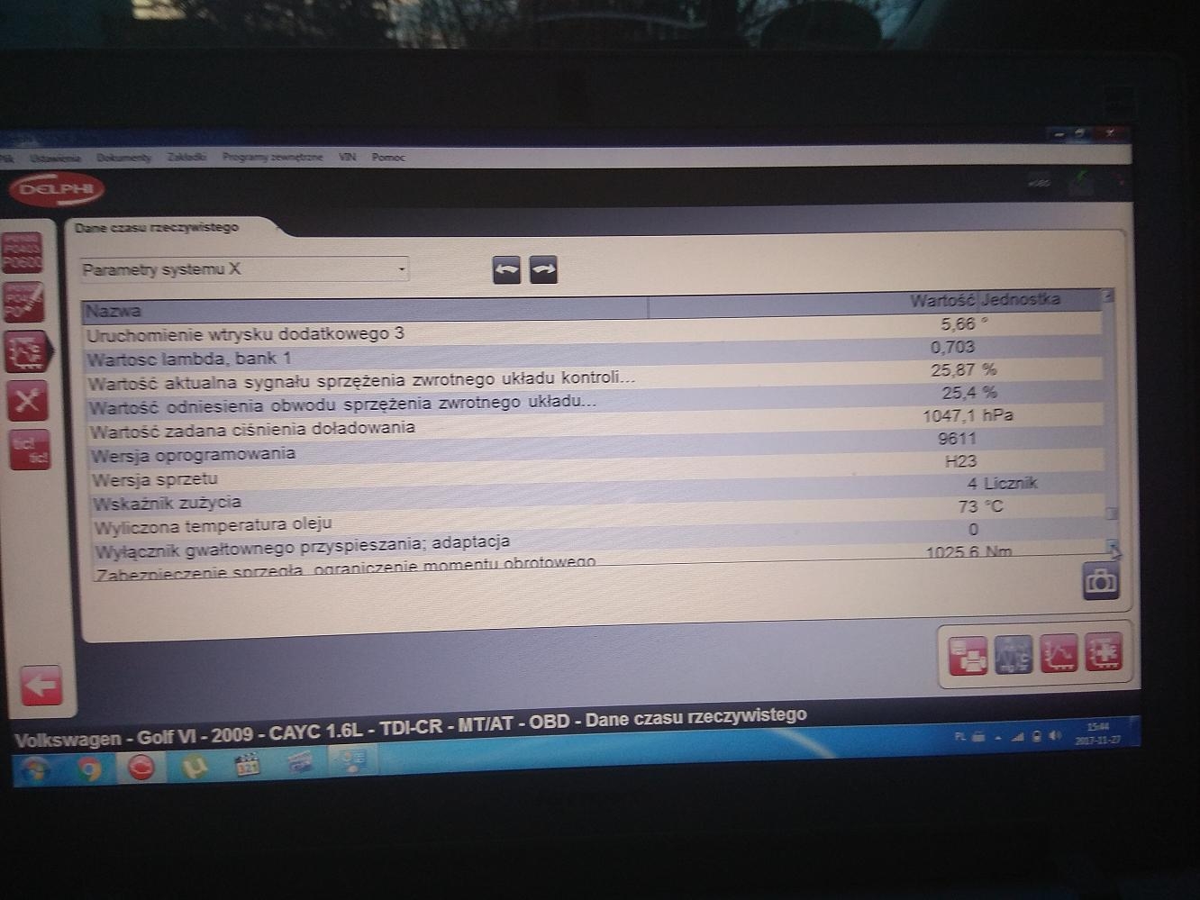

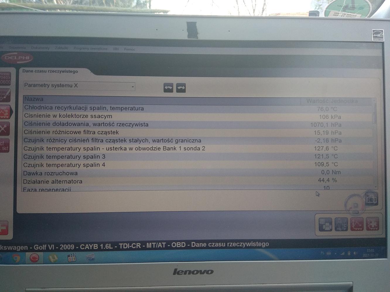

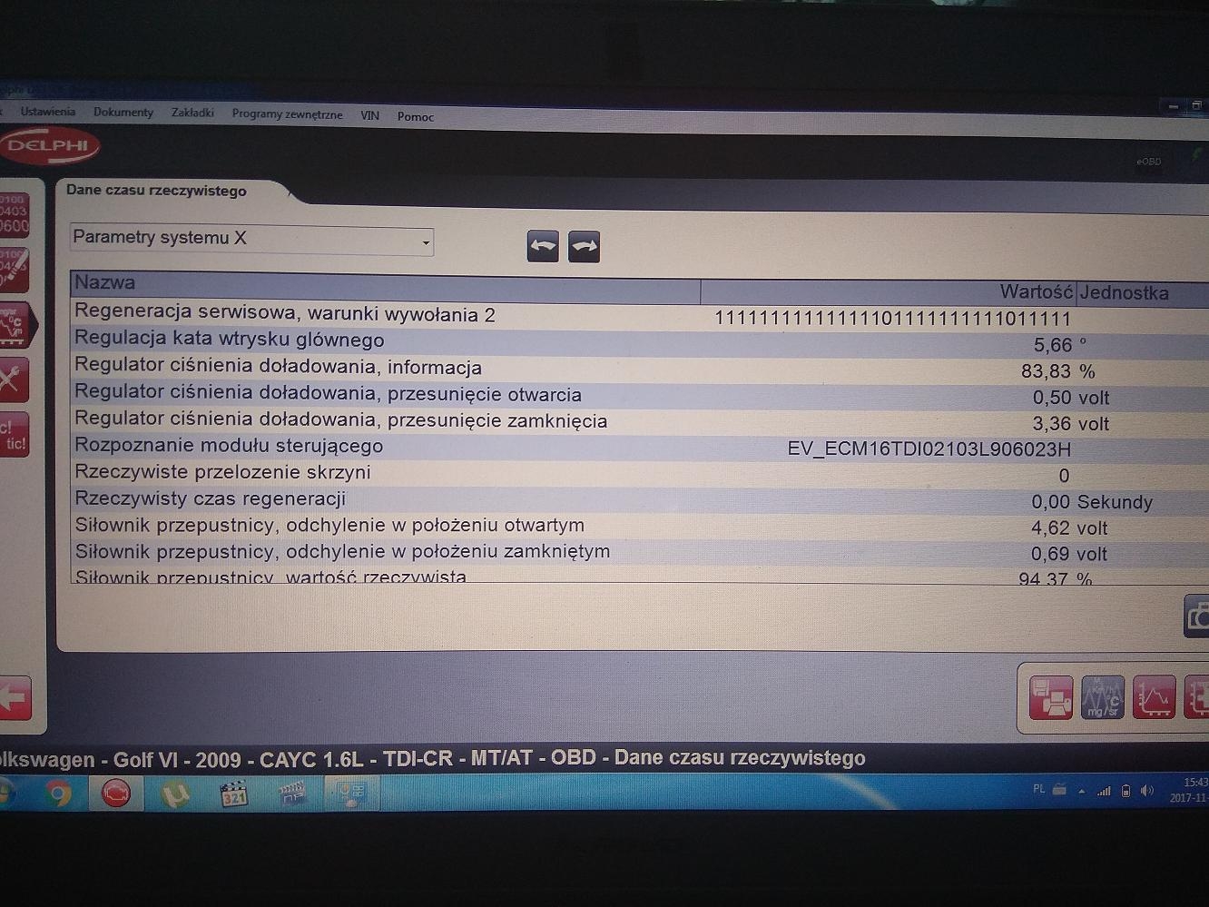

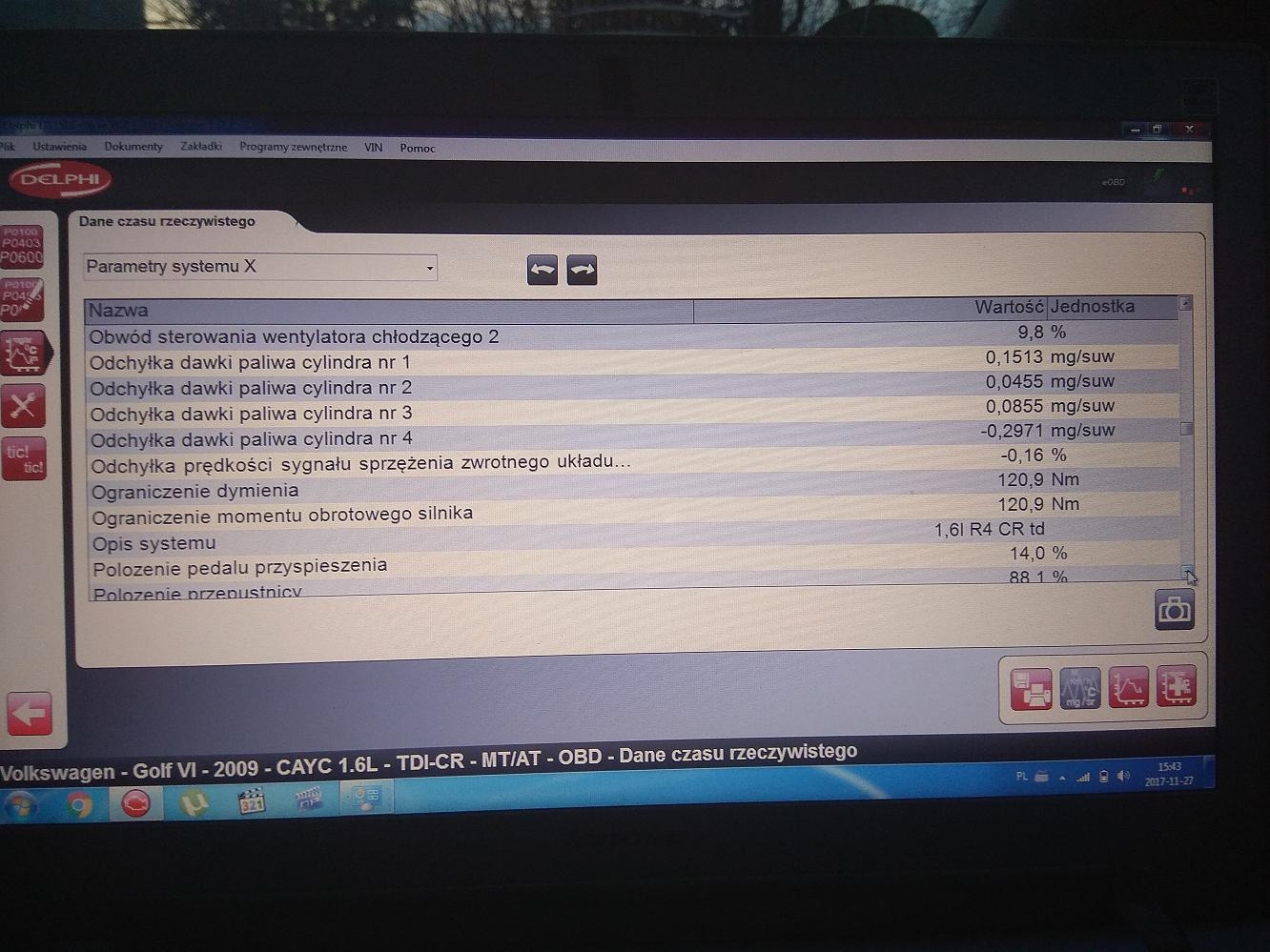

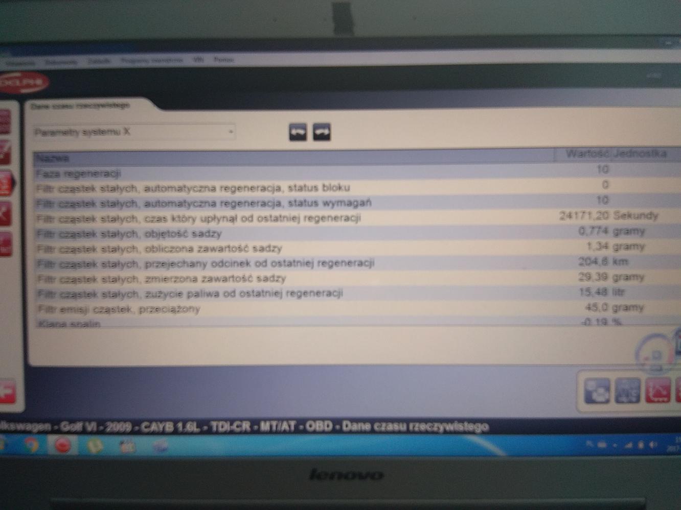

    I managed another diagnostic program to start this problem because sometimes they write with vcds too weak and by the way I had to "fail" to burn the DPF (it's no wonder if it does not burn while driving). Of course, after burning check and dpf disappeared.
    So one by one (I did not know what could help you, so there is a lot)
    1. VCDS only preliminary measurements:
    VAG 1.6TDI 2009: DPF Filling and Burning Issues During Extended Drivesvcds2.jpg (4.16 MB)You must be logged in to download this attachment. VAG 1.6TDI 2009: DPF Filling and Burning Issues During Extended DrivesVCDS.jpg (293.53 kB)You must be logged in to download this attachment.
    2. Pomiary Delphi
    a) przed wypaleniem awaryjnym dpf na postoju:
    VAG 1.6TDI 2009: DPF Filling and Burning Issues During Extended Drives1.jpg (150.72 kB)You must be logged in to download this attachment. VAG 1.6TDI 2009: DPF Filling and Burning Issues During Extended Drives1 (1).jpg (113.37 kB)You must be logged in to download this attachment. VAG 1.6TDI 2009: DPF Filling and Burning Issues During Extended Drives1 (2).jpg (2.34 MB)You must be logged in to download this attachment. VAG 1.6TDI 2009: DPF Filling and Burning Issues During Extended Drives1 (3).jpg (194.92 kB)You must be logged in to download this attachment. VAG 1.6TDI 2009: DPF Filling and Burning Issues During Extended Drives1 (4).jpg (160.66 kB)You must be logged in to download this attachment.
    b) after firing dpf at a stop (all possible measurements)
    VAG 1.6TDI 2009: DPF Filling and Burning Issues During Extended Drives VAG 1.6TDI 2009: DPF Filling and Burning Issues During Extended Drives VAG 1.6TDI 2009: DPF Filling and Burning Issues During Extended Drives VAG 1.6TDI 2009: DPF Filling and Burning Issues During Extended Drives VAG 1.6TDI 2009: DPF Filling and Burning Issues During Extended Drives VAG 1.6TDI 2009: DPF Filling and Burning Issues During Extended Drives VAG 1.6TDI 2009: DPF Filling and Burning Issues During Extended Drives VAG 1.6TDI 2009: DPF Filling and Burning Issues During Extended Drives VAG 1.6TDI 2009: DPF Filling and Burning Issues During Extended Drives VAG 1.6TDI 2009: DPF Filling and Burning Issues During Extended Drives VAG 1.6TDI 2009: DPF Filling and Burning Issues During Extended Drives VAG 1.6TDI 2009: DPF Filling and Burning Issues During Extended Drives
    2.ab (transition phase during firing start and end)
    I am curious about the adaptation of the exhaust gas sensor: (I did not)
    VAG 1.6TDI 2009: DPF Filling and Burning Issues During Extended Drivesadaptacja ...ujnika.jpg (131.93 kB)You must be logged in to download this attachment.

  • #13 16853470
    Ireneo
    Level 42  
    Posts: 7845
    Help: 747
    Rate: 2472
    Probably that capitulation. I have seen these foty and I see that you do not know what to look at. I looked because I thought I could not see but I see other groups before and after.
  • #14 16853514
    Radow
    Posts: 286
    Help: 5
    Rate: 35
    Well, I do not know what I'm looking at ... Ba ... But the local tenants do not know either ;) .
    In the pictures after firing are all available readings available in the "engine".
    If you tell me what to look at, then this is a detail of the screenshots.
