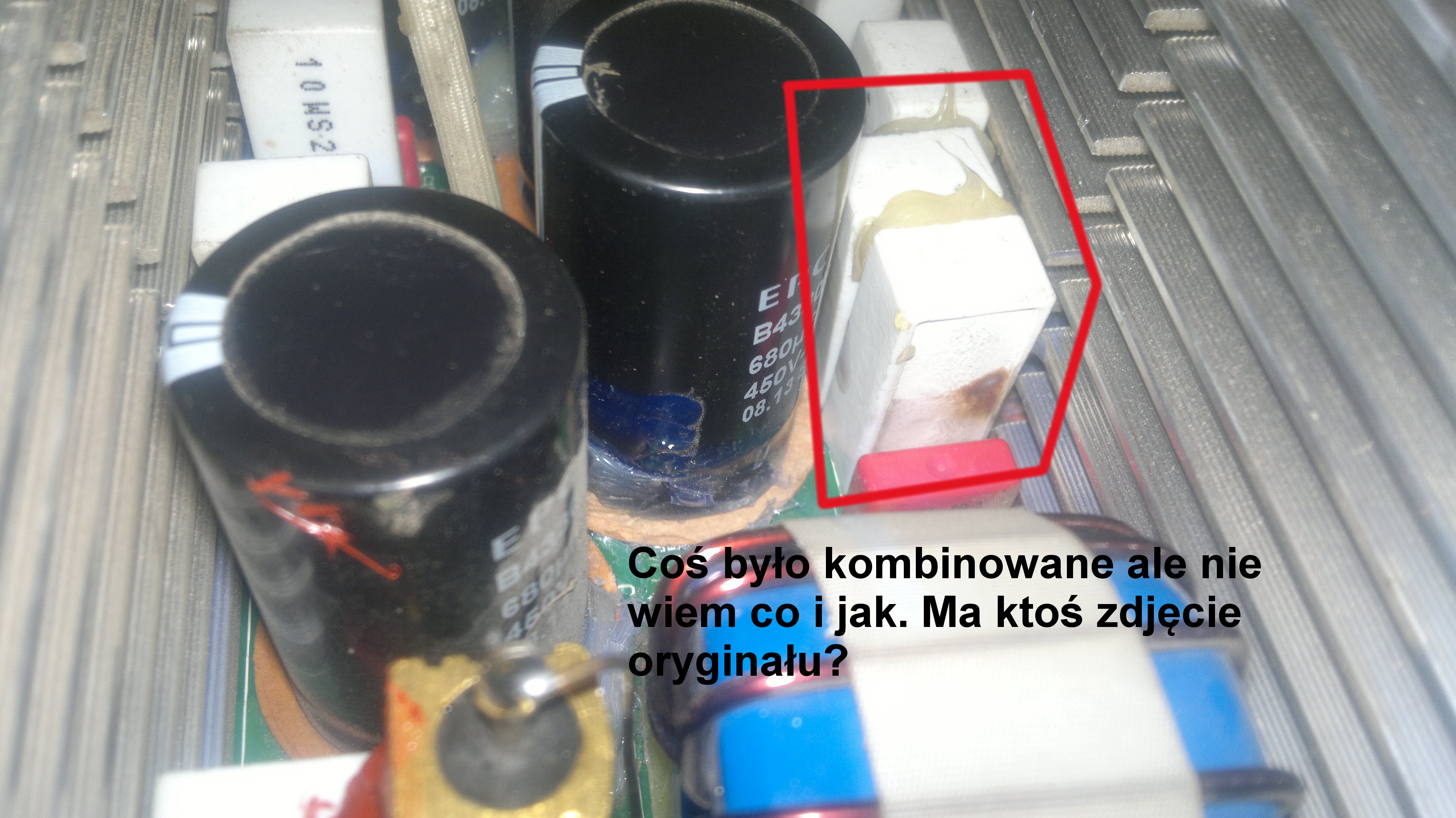

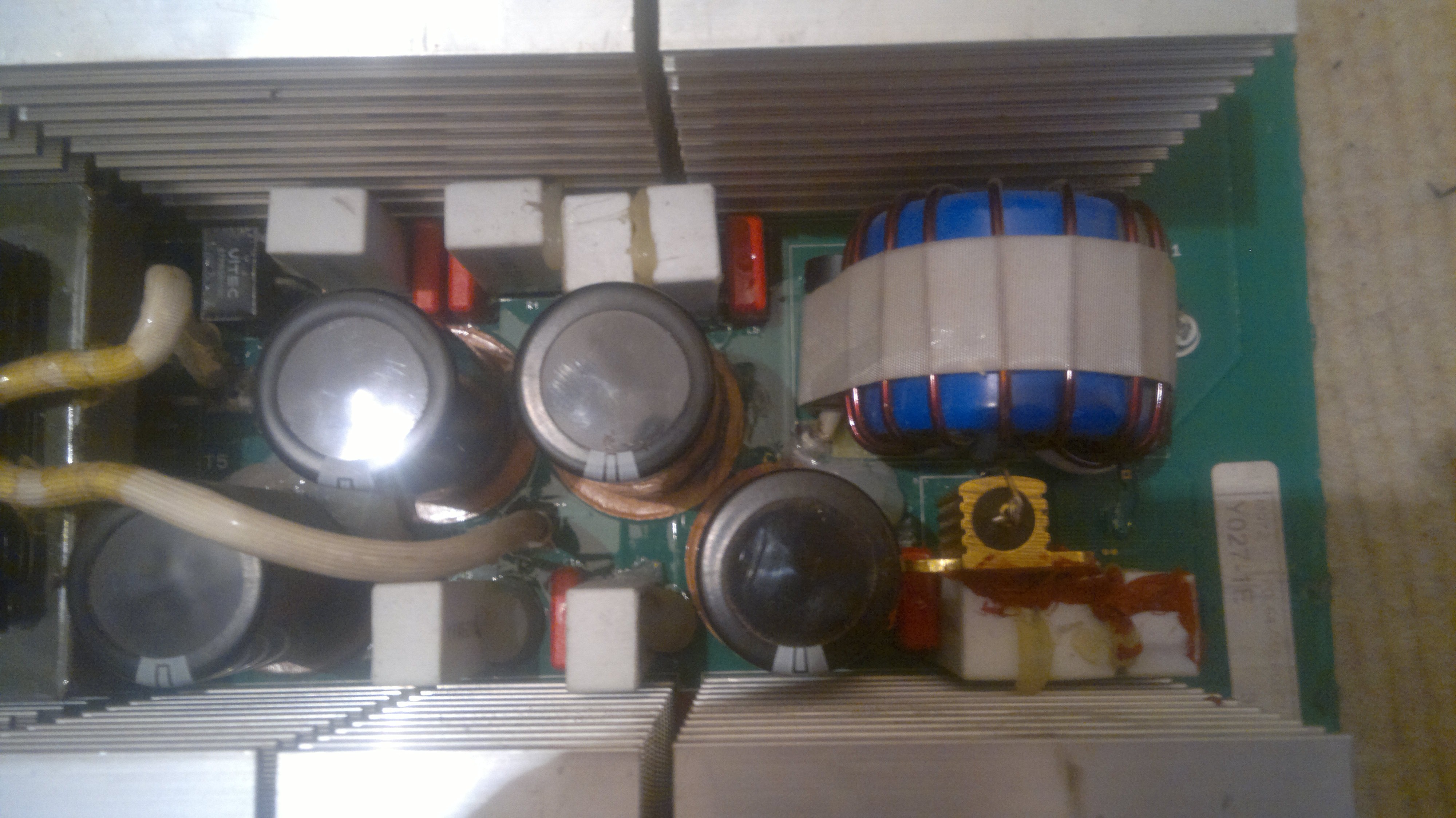

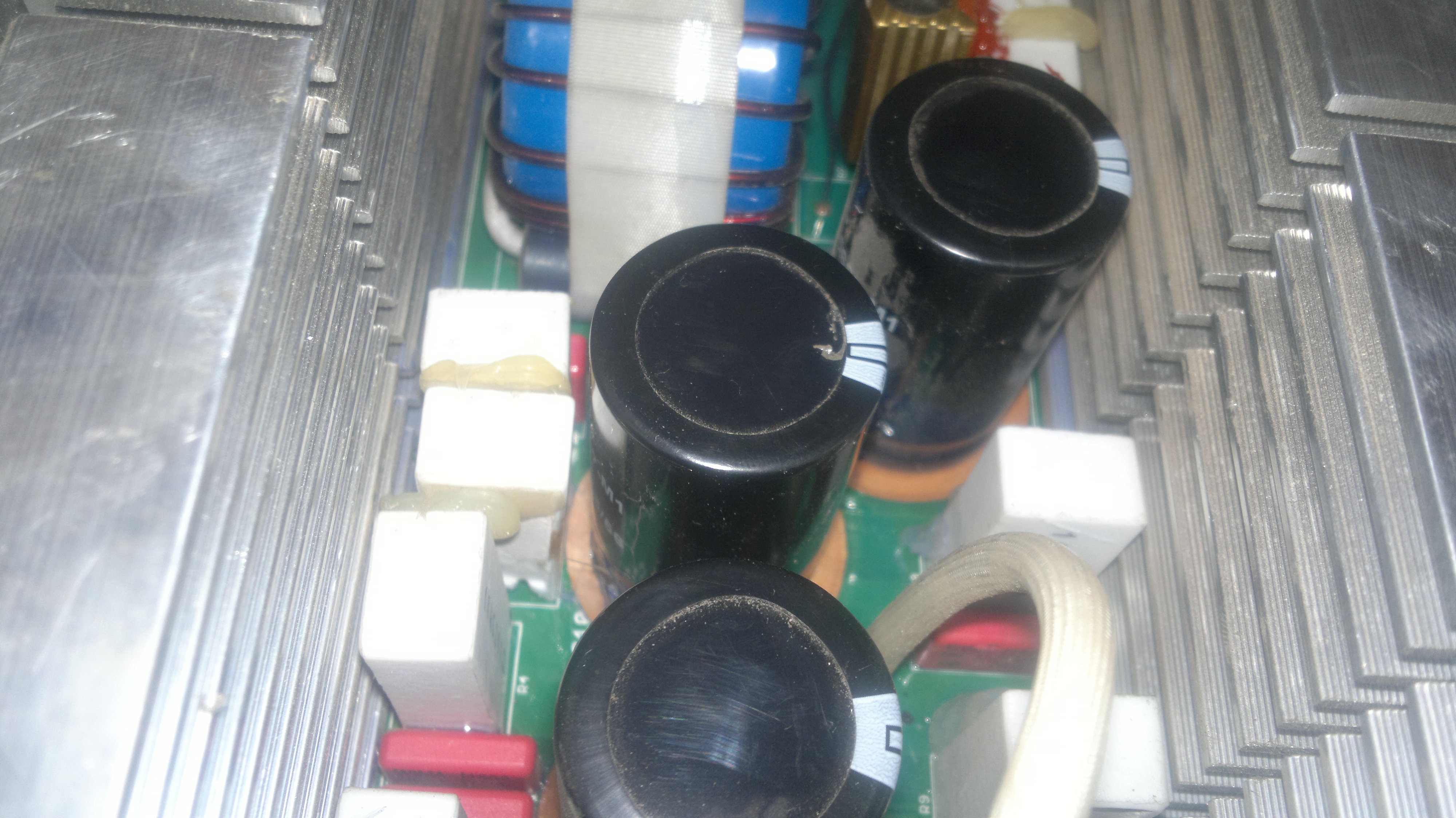

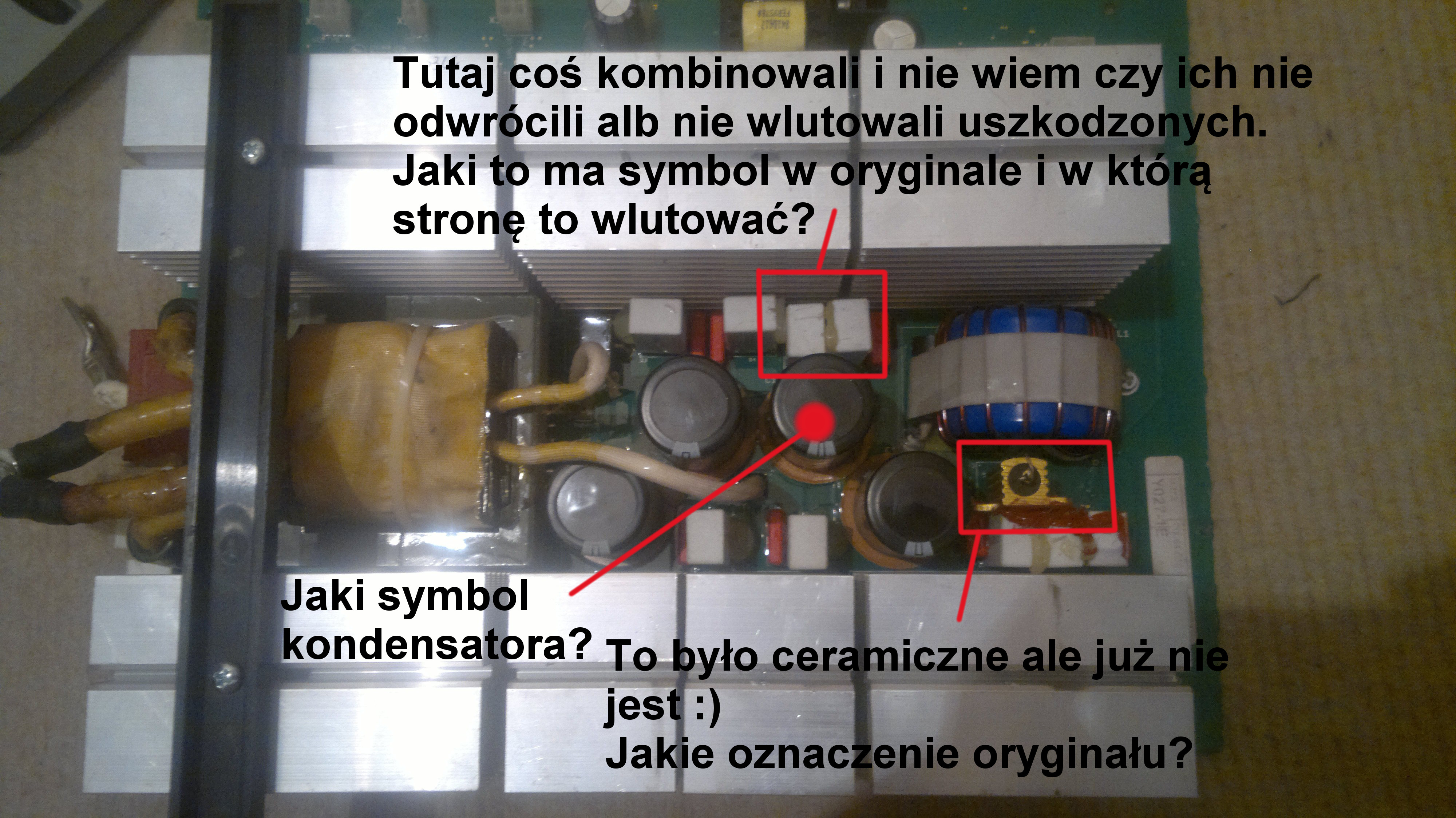

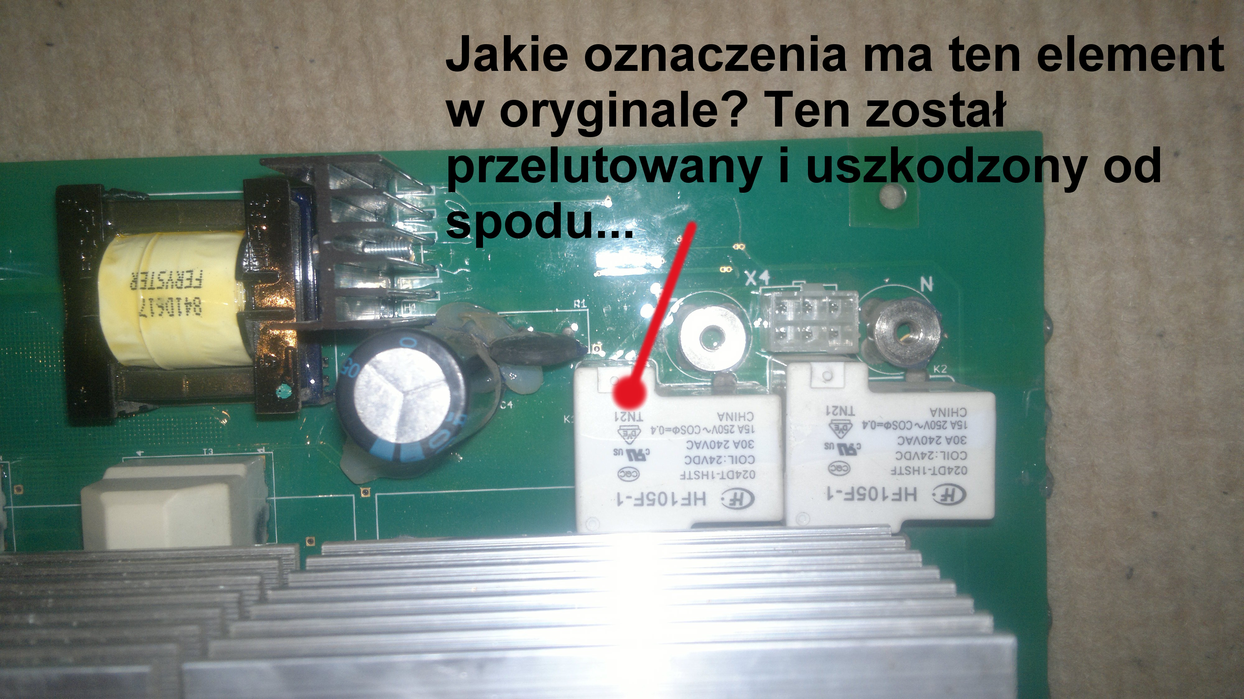

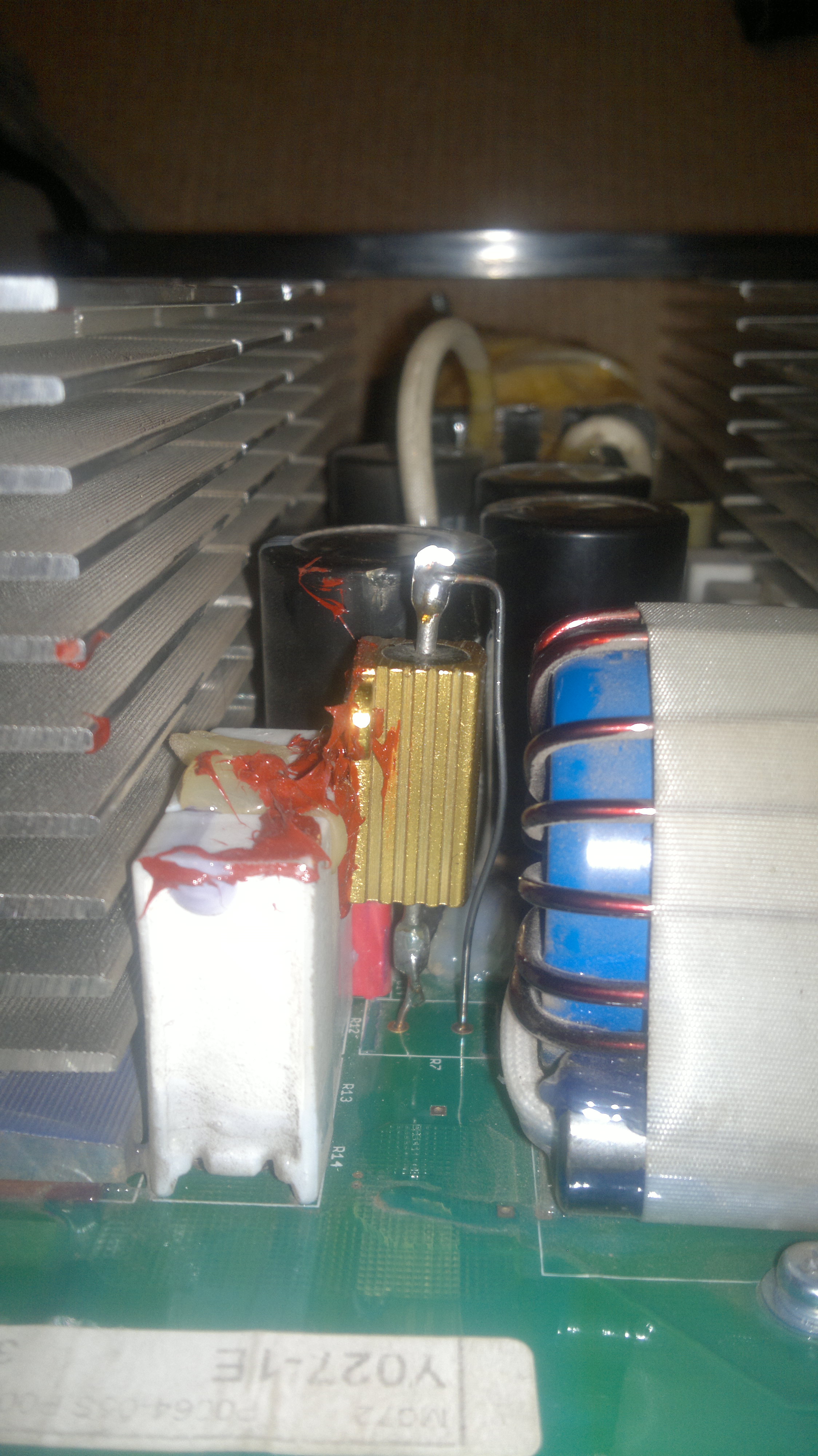

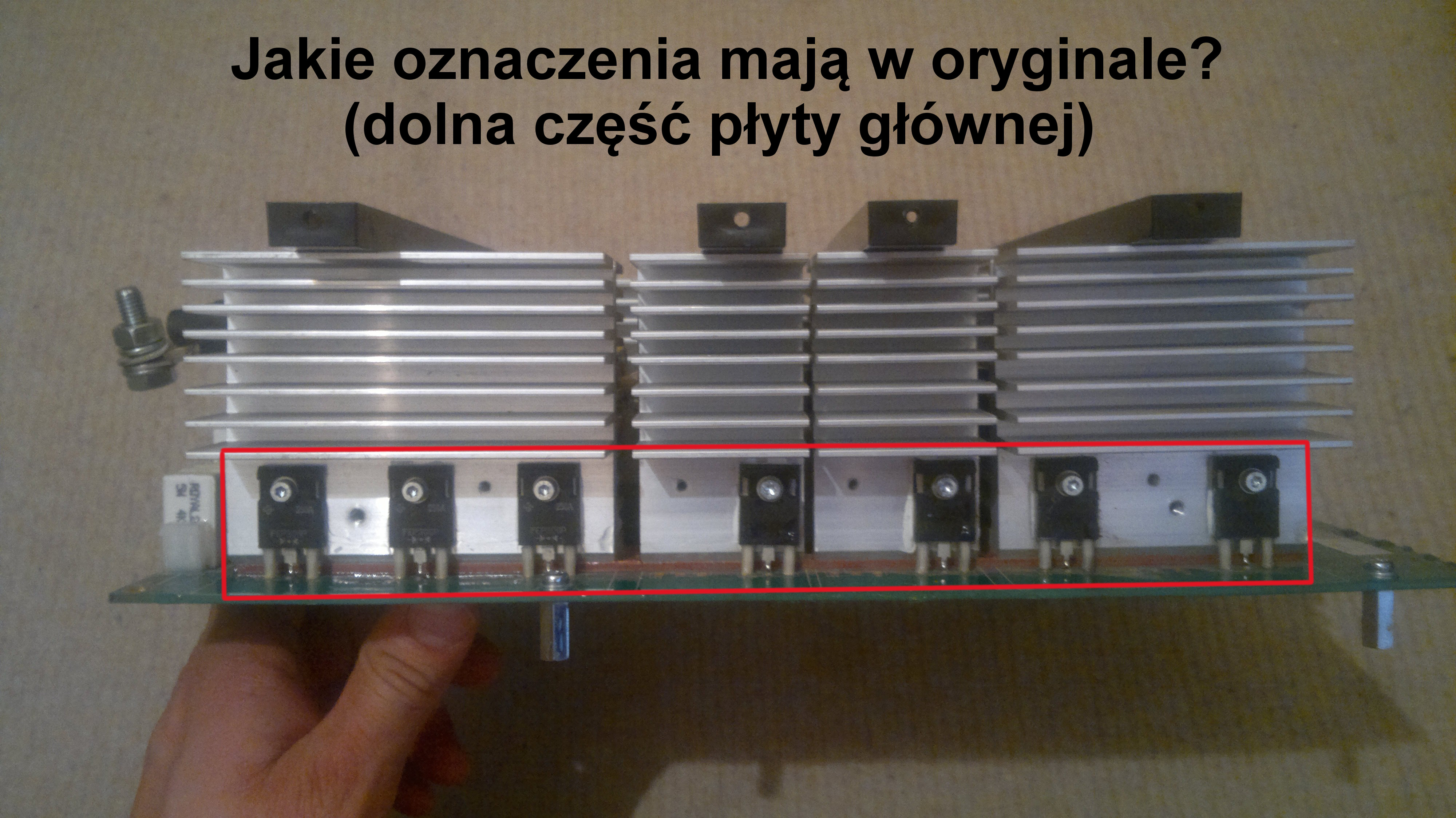

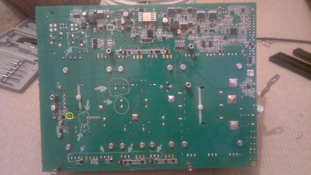

    Hello, I have a technical problem caused by lack of trust in the authorized LINCOLN service center. The problem is that my friend was welding with a speedtec at the highest current in MMA mode, not maintaining the operating time, which resulted in the device overheating. The welding machine was serviced in Krakow and I got it back after 5 weeks. The service center did not inform me about the costs of the service, which cost me PLN 1.5 thousand. PLN... Out of curiosity, I opened the welding machine to see what had been replaced and what did I see? I saw a screwdriver that the service technician had carelessly or intentionally left in the device. I have the impression that it was not there by accident because it was in contact with the power output to the electrode and the motherboard. After filing a complaint, the service center took it back to itself, first claiming that I had thrown in the screwdriver myself, and then after another 4 weeks I got the welder back and part of the money back... Result: I took the device apart again and what did I see? The soldered parts that were previously replaced with new ones, and after the complaint I saw damaged parts and replaced ones.
    The situation is that I would like to fix it myself this time, but I don`t know if the parts currently soldered to the motherboard are the parts that are actually in these places, i.e. the same parameters as in the original.
    My question is: can anyone help by sending e.g. photos with the markings of the elements? Thank you in advance for your help and good advice. :)
    Below are photos after visiting the website.

    banaszakjohan

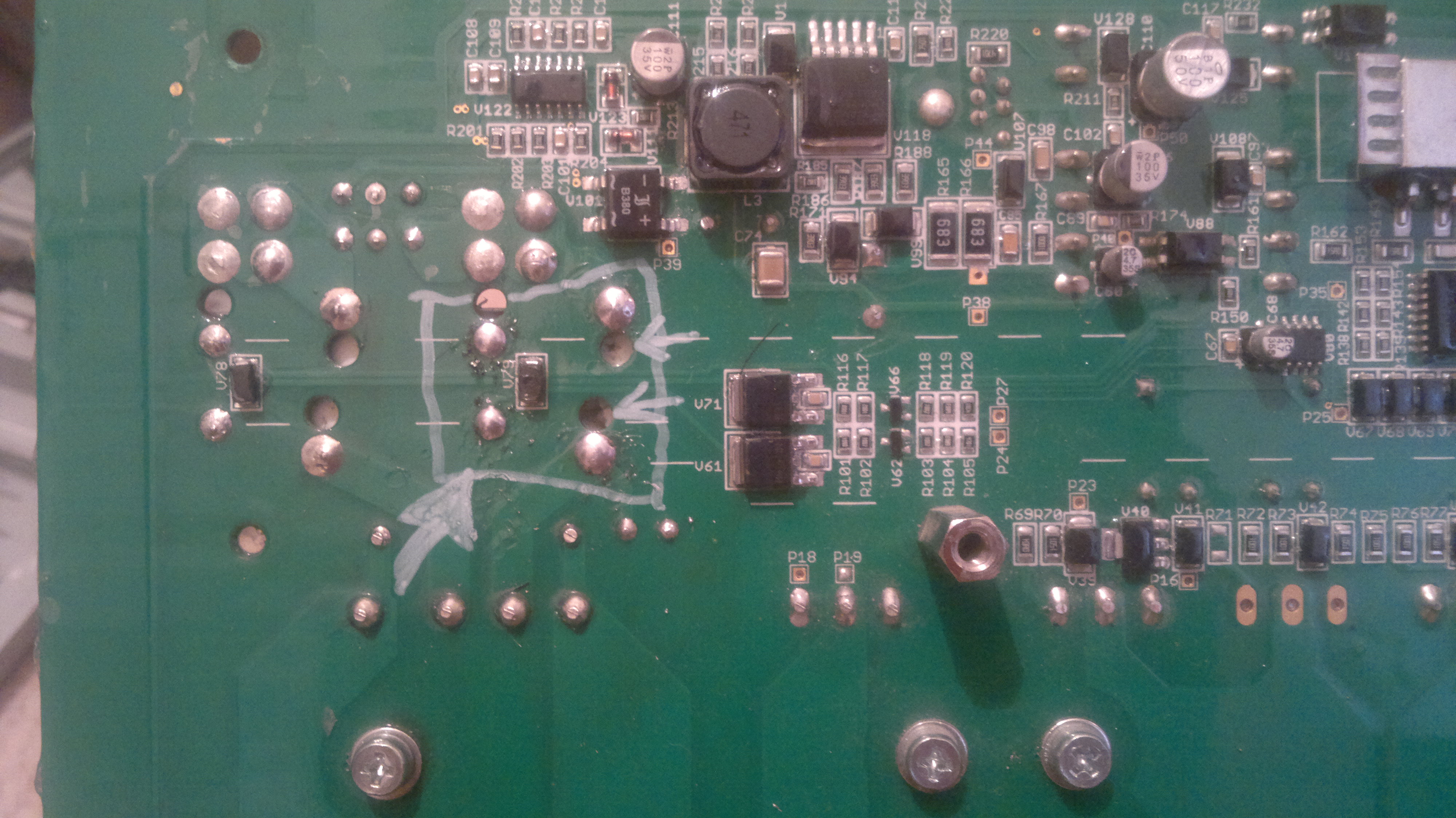

    Hello, I have the same welding machine as you. The mosfet in position V121 at the top right of your first photo is broken. Unfortunately, I can't read the reference that is written on it. Could you take a picture of yours or tell me the reference if you can read it?
    Thanks in advance.
  • #5 20985397
    baki.
    Hi,
    It's been a long time, but I still hope that my answer will help someone.
    V120 is IRF9540NS and V121 is IRF540NS.

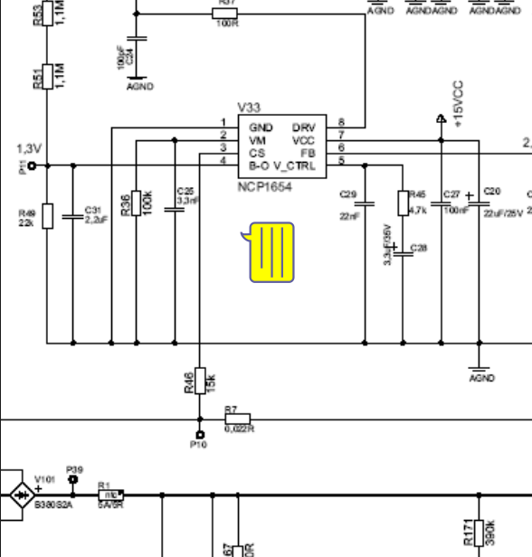

    I need the value of resistor R46.
    Image of a circuit board with electronic components, where one resistor (R46) is highlighted with a yellow circle.
  • #6 21198113
    Tnam27
    Hi.
    R46 is a 15K resistor.
    Hope it helps. Electronic schematic with NCP1654 IC and resistor labeled as R46.

    There are still burnt components. Someone took off the original k40H603 and put in a FGH40N60; also, the CUG diodes are shorted.
