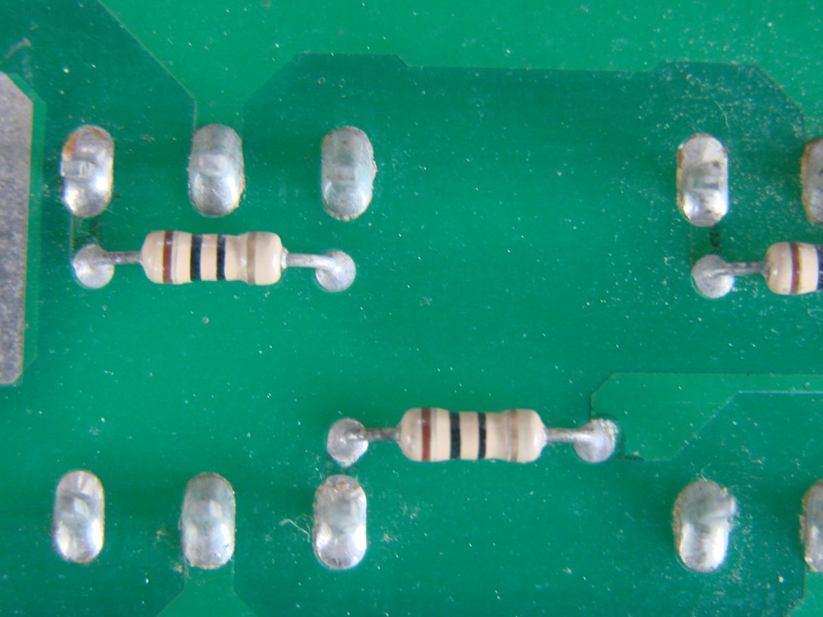

    Because I was asked for a bit more information about this welder about it:
    The front panel potentiometer has no additional elements mounted on it. What may give such an impression is a plastic mass. The middle leg is in the shirt. As you can see on the photo, the potentiometer is 10k and, according to my measurements, has a linear characteristic.

    IREK21A Is a 1.58k-1 resistor % next to the stabilizer 7815 was read from the barcode or was it measured?

  • #13 13277578
    IREK21A
    Hello. The absence caused by damage to the router. The "idepopizze" elements were measured in the system. I checked today the resistor next to LM 7815 desoldered is 3.3k-1% next next to 10k-5% and the other two are 4.7k-1% .Z my photo is really hard to read! What is I surprised to see that they are loose!? As for professional equipment, the distance from PE is a frivolous solution. In the Polish ENEL 150 power transistors screwed to the radiator! In my cemont th 1600 probably this was the cause of the power level damage because one central igbt r4727 fired. The deformed laminate is known to have a temperature.

    All screws on all heat sinks seemed to be screwed by hand (manually, that is, more tightly with fingers). When I finish it, it's more solid.
    I had doubts about this 1.58k, because the colors did not match very well. 10k next to the colors looked ok. Probably soon I will throw here the scheme of this CD when I finish the patch.

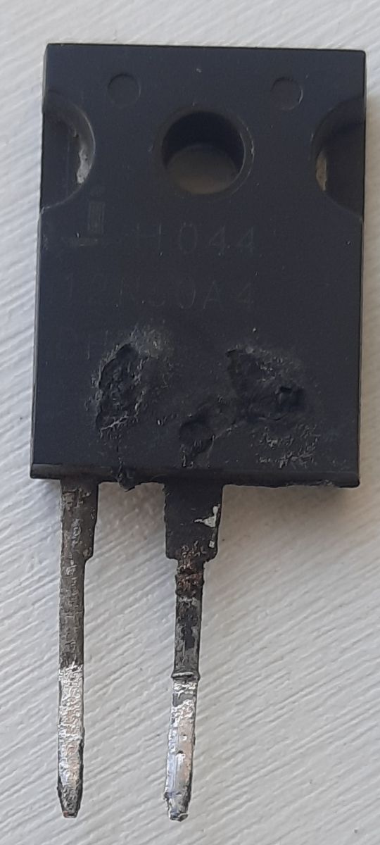

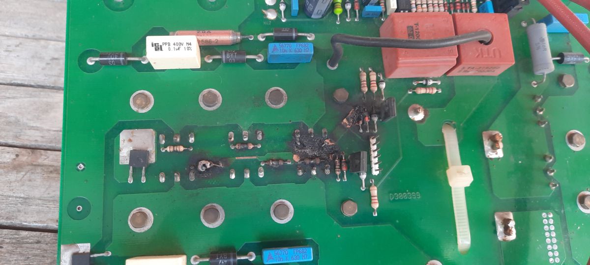

  • Whistling inverter with no welding current
    #15 19858424
    lfcfan_lfc
    Hi everyone. My brother managed to get an Oerlikon / Citoarc 1600i
    It switches on, but it makes a whistling sound, like an ultrasound when turning up the potentiometer of current. He opened it and could not see any defective part, nor any burnt part/area. He tried to weld but there seems to be no current coming out, only small sparks.
    Any idea on where he should look on the boards?

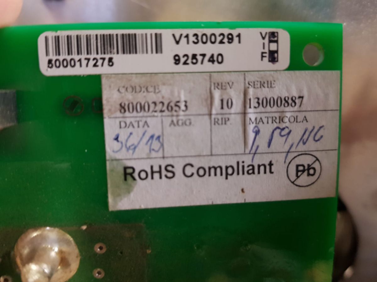

    #16 20020724
    wakycampa
    Hello, I have the same equipment and I need the values ​​of the 7 resistors at the bottom left of the diagram, the ones next to the triac bd138 Repairing Damaged PCB on CEMONT S1600 Welding Inverter: Missing Components, I think they are the only ones missing. In my computer they have all been burned and I cannot know the value. Thank you so much [quote="IREK21A"]Hi. This condenser over LM339N is 100nf / 63V. I put a drawing on the knee (photo) not fit with the photo PCB earlier. What some will laugh!?. Repairing Damaged PCB on CEMONT S1600 Welding Inverter: Missing Components [/quote] Repairing Damaged PCB on CEMONT S1600 Welding Inverter: Missing Components

  • #18 20029644
    wakycampa
    thank you very much for your help. Now I'm going to buy all the components. although on my board the 6 transistors are different than those in your photos. mine are 12n60a4 but I suppose they will be equivalent to the R4727 that your board mounts.
