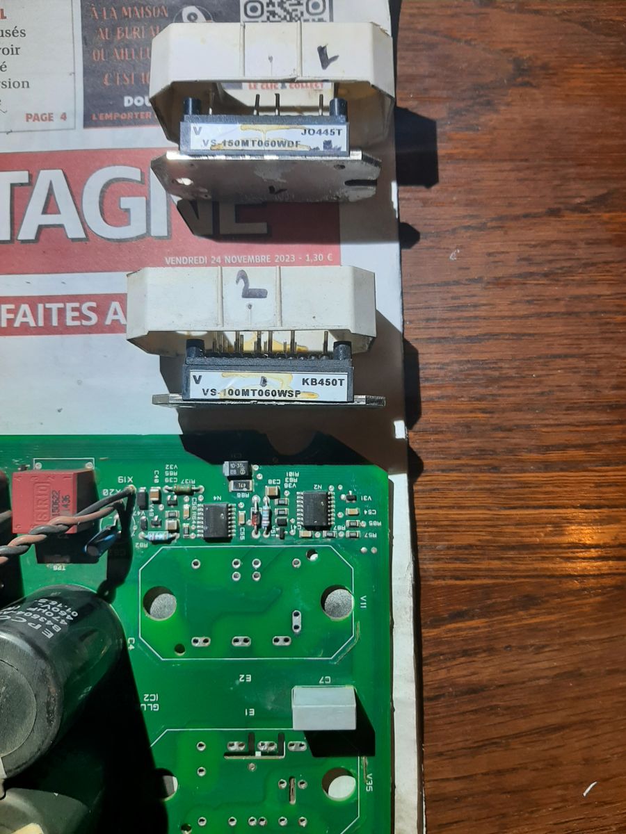

    I was also thinking about a module but my level in electronics is quite average, however I am an excellent desolder (I removed the two modules) here are the references: vs-150mt060wdf and vs-100mt060wsp
    Is there an easy way to check your parts?

    Hello, both modules are out of service, where can we buy parts? THANKS

    hello, the igbt modules cannot be found, and it is possible to rebuild them (partially or completely) all the diodes are good (only the igbts are not good, they are not in short circuit)
    what component choices would be best suited? igbt and diodes, thank you
