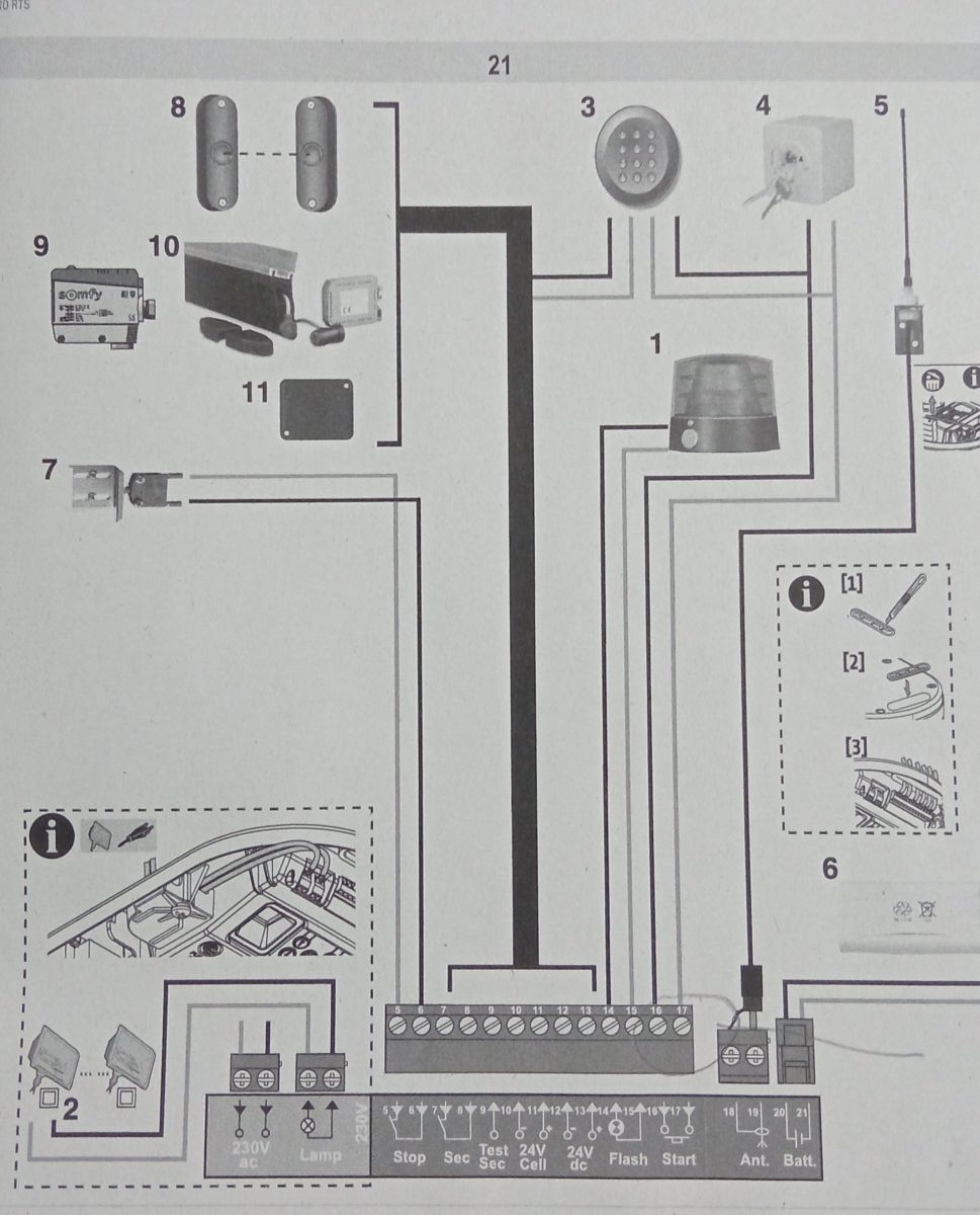

    I have such a drive and I wanted to run wires from the drive and open and close the gate after pressing the button.
    I do not have the exact model of this gate :D Optimo RTS SOMFY ex.

  • #4 16342648
    sosarek
    Posts: 83875
    Help: 9320
    Rate: 15533
    From the diagrams it results that STOP is connected to the gate limit.
    MARKSON43 wrote:
    Is the START button working and opening and closing.
    Yes - Start one way - STOP - Start the other way.

  • #5 16342660
    MARKSON43
    Posts: 882
    Help: 22
    Rate: 283
    Thank you so much, but should I connect only to terminals 11 and 12.
    And apply the button?
    So how do I connect it after the first press the gate will open and after the second press of the same button the gate will close?
    Of course, when he reaches the end.
  • #6 16342672
    sosarek
    Posts: 83875
    Help: 9320
    Rate: 15533
    Yes - you can try to short these terminals with a piece of wire, even.

    And why are STOP-3 and 4
  • #8 16342699
    sosarek
    Posts: 83875
    Help: 9320
    Rate: 15533
    In order for the drive to turn off the engine after opening / closing the gate.

  • #9 16342715
    MARKSON43
    Posts: 882
    Help: 22
    Rate: 283
    I apologize that I am so przynudzam but is it under contact 3i4, is there any limit?
    Does this gate not work on the principle of motor overload.
    And I'm not connected to him, right?
    #10 16342718
    sosarek
    Posts: 83875
    Help: 9320
    Rate: 15533
    In the diagram you have a clear - or limit switch or a jumper in its place - in this case you should program the opening and closing times of the gate accordingly.

  • #11 16342736
    MARKSON43
    Posts: 882
    Help: 22
    Rate: 283
    OK, thank you very much.
    If I try, I will write it down and I will not forget to give "helped", although you have a lot :)
    I congratulate knowledge and more willingness to help selflessly.
    And now I have read that element No. 7, it is "A set of elements protecting the wicket door. As if the door was built in the gate, the mechanism will not work. A good solution because I have to constantly look if someone has left the door ajar.
    Added after 8 [hours] 35 [minutes]:
    Everything works as you wrote me. And there is a bridge to the limit switch.
    Thanks a lot. .
    Professional help.

    #14 18785162
    Marek J.
    Posts: 2368
    Help: 526
    Rate: 951
    A colleague @senipla woke up more than 3 years after the topic was already solved, but in fact if someone did not want / could not connect the bell button wired, then there are remote controls (not only Somfy but other companies, e.g. Proxima compatible with Somfy and not only) in the shape of wall buttons.
    In addition, I will address the issue of STOP clamp. This is not a motor end stop stopping the door in an extreme position but a microswitch clamp used in at least two cases:
    1. When using a mechanical lock - closing the gate with a bolt or key makes it impossible to start the drive
    2. In gates, so-called service door. Opening them causes the contacts of the microswitch or reed switch to open, and thus the drive cannot be started.
    3. You can also connect the above terminal to the control panel to block the drive after arming the system.

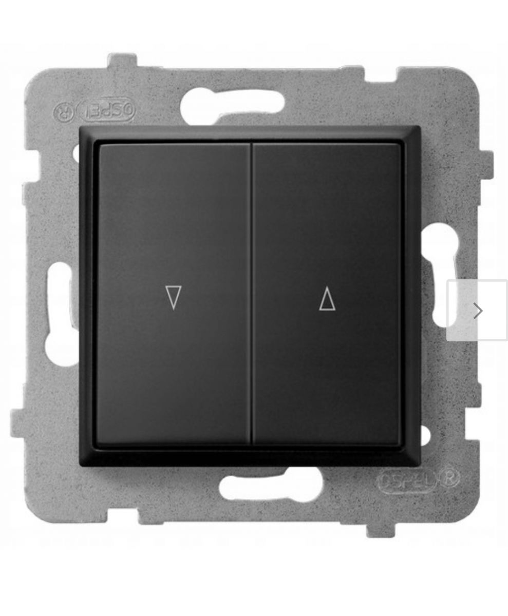

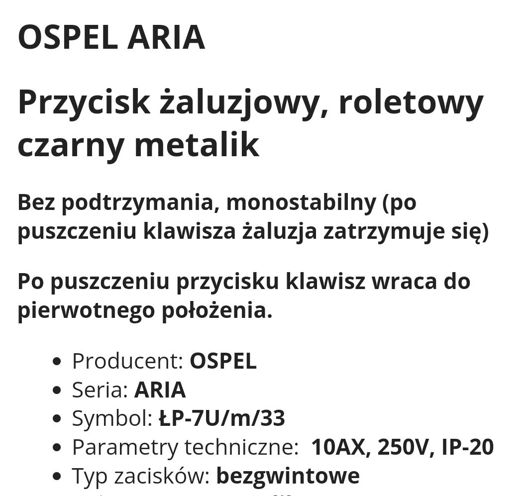

  • #16 20362382
    elektroseba123
    Hello. I have a shutter switch like this. Can I connect it to the gateway? To open with one button to close with the other. Is it better to buy a single bell?
    Wiring and Button Control for Somfy Optimo RTS Gate Drive: A Practical Guide Wiring and Button Control for Somfy Optimo RTS Gate Drive: A Practical Guide

    kotbury
    Gantry automation specialist
    Posts: 9598
    Help: 2100
    Rate: 3631
    What gate drive (Dexxo as in the subject or something newer?) and what suits you better - sequential or directional buttons (not every drive can be used - details please).
  • #18 20362437
    elektroseba123
    DEXXO PRO RTS
  • #19 20362544
    kotbury
    Posts: 9598
    Help: 2100
    Rate: 3631
    You only have a sequence (i.e. open - stop - close - stop ...) - terminals 16 and 17. So either a single bell switch or - if this switch is matched to the rest of the cottage style and you will not get a single one - connect both buttons of this switch from the photo parallel and everyone will do the same.
  • #20 20364274
    elektroseba123
    Thanks a lot ? The topic is covered, everything works great. Best regards ?
