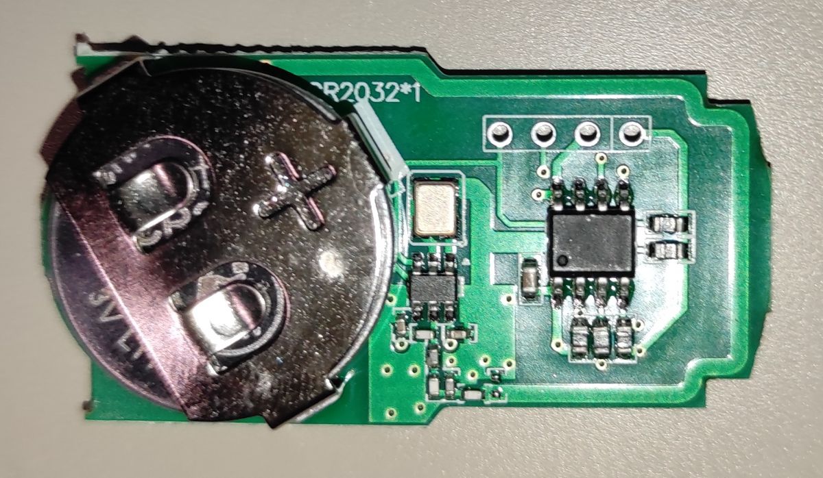

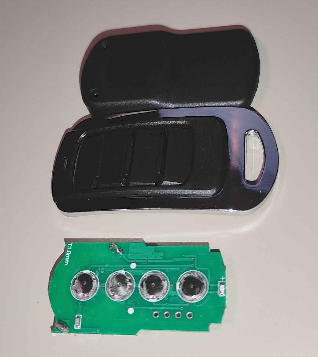

    I want to open a sliding gate by remote control from the microcontroller. The transmission system is a Somfy RTS. I bought a cheap four-channel remote control.
    First thought is to screw with the servo, the arm presses the button for a fraction of a second and the remote works.
    Second thought is to bridge the button with an optocoupler and short-circuit the contacts connected by the button with a signal from the microcontroller. However, I can't see access to the button contacts, plus the whole thing is sealed with tape and will probably come apart after peeling it off.
    Is there a better way to emit a signal from this remote control?
    Disassembled remote control with a casing and circuit board with buttons.
    Close-up of a remote control circuit board with an installed CR2032 battery.

    Hi,
    Considering the various methods of controlling the sliding gate remote from the microcontroller, indeed the first two ideas you have given are feasible, but each has its drawbacks. Using a servo to push the button is a mechanical method that can be unreliable and requires additional components, while bridging the button with an optocoupler requires interference with the remote's circuitry, which can be difficult and risky.
    However, there is another method that may be more elegant and does not require direct interference with the remote's hardware.
    3. Emulating the remote control signal using a microcontroller:
    Somfy RTS is a radio system, so instead of mechanically pressing buttons or interfering with the remote control circuit, you can use a microcontroller with a suitable RF transceiver module to emulate the remote control signal. Here is how you can do this:
    1. Analyse the RF signal: You need a frequency analyser or RF receiver to help you understand the modulation and coding of the signal sent by the Somfy RTS remote control. You need to find the operating frequency (usually 433.42 MHz for Somfy RTS) and how the signal is modulated.
    2. Replication of the signal: Once you have analysed and understood the signal, you need to program a microcontroller (for example, an Arduino with an RF transceiver module) to replicate this signal. To do this, you can use existing libraries and code examples that you can find online for systems like the Somfy RTS.
    3. Implement the control: Now that you have the code ready, the microcontroller can send an RF signal that will open the gate, mimicking the signal from the remote control. You can integrate this into a larger smart home system or simply use the microcontroller for remote control.
    Remember that emulating RF signals may require some knowledge and experience in working with electronics and microcontrollers. In addition, depending on local regulations, the emission of RF signals may be regulated and require appropriate licensing.
    Always ensure that you are operating legally and not violating any RF emission regulations.
