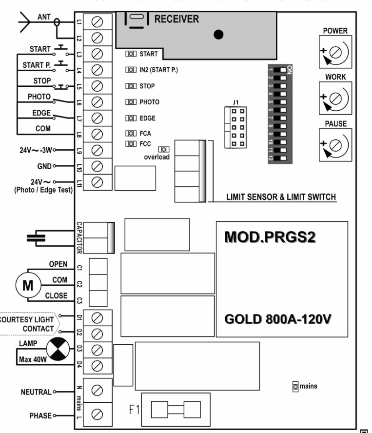

    Hello, I want to add a manual button to my automatic gate but I do not know where to connect the 2 cables, can someone please help me.
    My system:
    Model: PRGS2
    Connection diagram of automatic gate model PRGS2 with marked connection points.

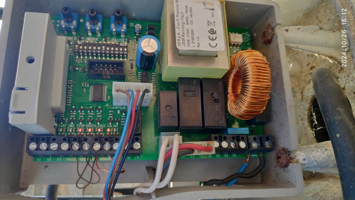

    Close-up of an electronic circuit board in the control unit of an automatic gate model PRGS2.

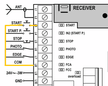

    Diagram showing the connection of buttons to the controller terminals labeled L3 and L8. The button should be connected to terminals L3 and L8.
