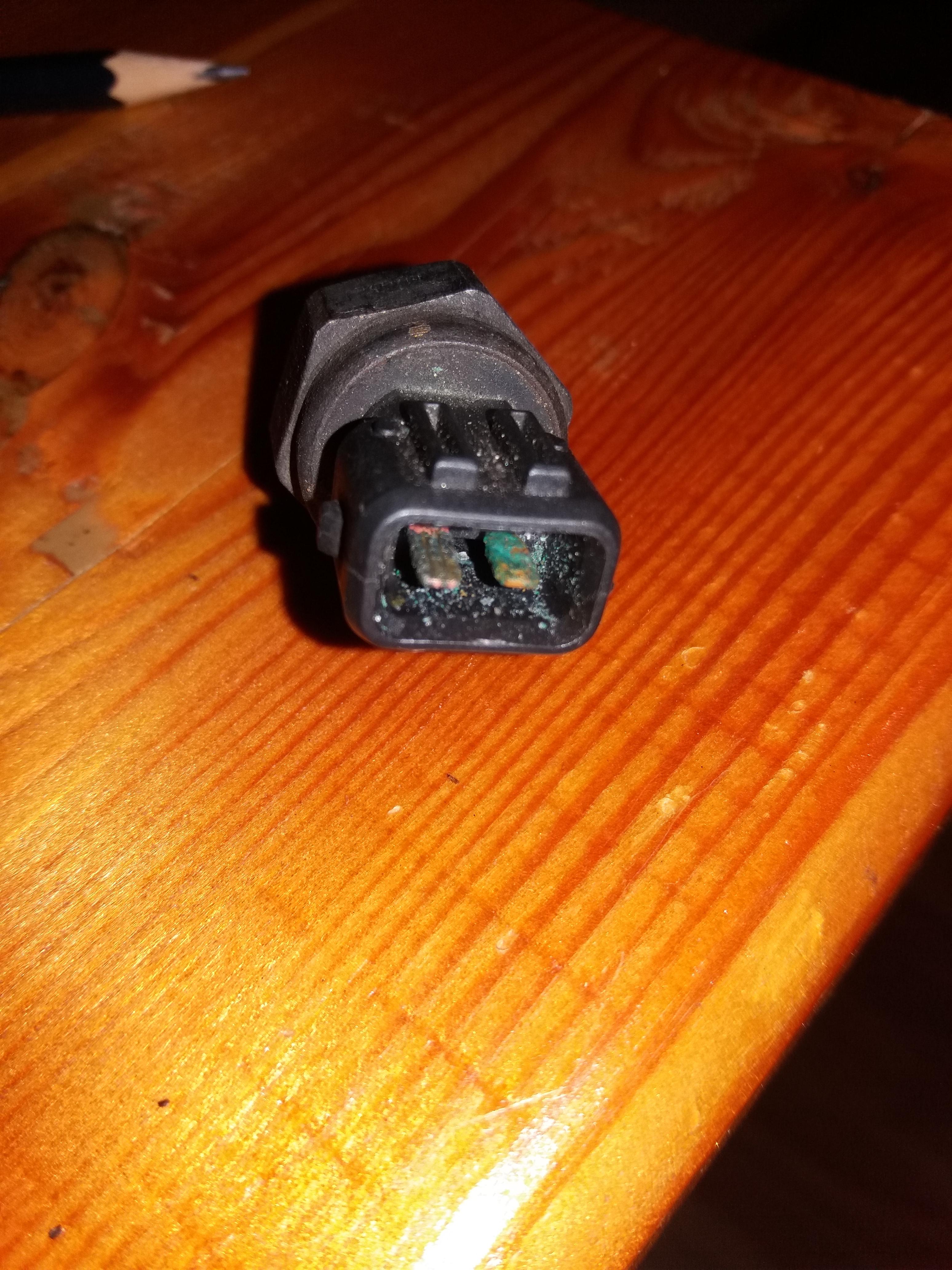

    Hello!
    Again, I need to address the honorable colleagues in the forum.
    I need a "female" plug for this sensor (someone broke off before and the cables were directly attached to the pins, one cable was already torn off and the reversing light is off). Does anyone know what the number is or where to find? I want to mount a new one. I've been looking a lot and I can't find it anywhere. There is also no ETKA.
    Best regards!
    Locating a Female Plug for VW Golf IV 1.9 AGR Reversing Light Sensor20170313_1..114.jpg (1.26 MB)You must be logged in to download this attachment.
    Locating a Female Plug for VW Golf IV 1.9 AGR Reversing Light Sensor20170313_1..122.jpg (1.28 MB)You must be logged in to download this attachment.

    #5 16343803
    sk700
    Posts: 1348
    Help: 173
    Rate: 420
    If you really want to, please: 357972752
    Go straight and cut what you need, it's a shame to pay for the shipment :)

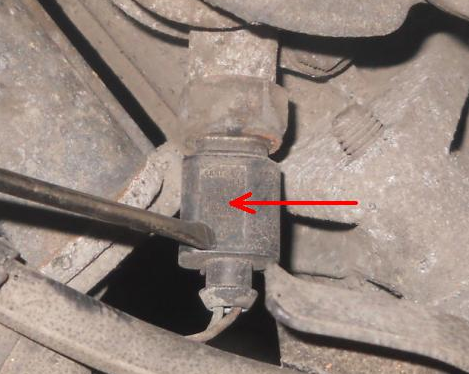

  • Questioning compatibility of connector 822757
    #6 16343862
    Kokuj
    Posts: 59
    Rate: 30
    Thanks good man. Like I can do it, but inside there will certainly be old cables and connectors, and to remove them you will need a special screwdriver, which costs about PLN 100. Anyway, thank you very much!
    But here Locating a Female Plug for VW Golf IV 1.9 AGR Reversing Light Sensorjo.png (343.06 kB)You must be logged in to download this attachment. looks different hmm, it probably doesn't matter?
  • #7 16344389
    sk700
    Posts: 1348
    Help: 173
    Rate: 420
    There were two types. The number I gave matches the sensor from the first post. In the afternoon I will give you the number of this semi-circular plug. Believe that such elements do not wear out, the more that they are hermetic so you can safely take used ones. If the plug is rushed you will notice immediately :)

    The rectangular plug is a standard AMP JPT
    Ok, so I'm waiting :)

    Kokuj wrote:
    Ok, so I'm waiting
    1J0973702
  • #11 16345414
    Kokuj
    Posts: 59
    Rate: 30
    sk700 wrote:
    Kokuj wrote:
    Ok, so I'm waiting
    1J0973702
    It's not this one. See that she must have a rectangular entrance. And here on one side it is rectangular and on the other half-round.
    #12 16346005
    sk700
    Posts: 1348
    Help: 173
    Rate: 420
    Everything has already been written here but I will write again.
    In golf 4 there are two types of reverse sensors.
    The first with a rectangular plug as in the pictures in the first post and the first number refers to it. The second type had a semi-circular plug with the number that I gave as the second one and this type is shown in the photo from under the mask you inserted. First, I suggested a photo in the first post and provided a matching number, you wrote that it wasn't it and put in a second photo. When I gave the plug number from the photo, it doesn't match, how is it? :)
