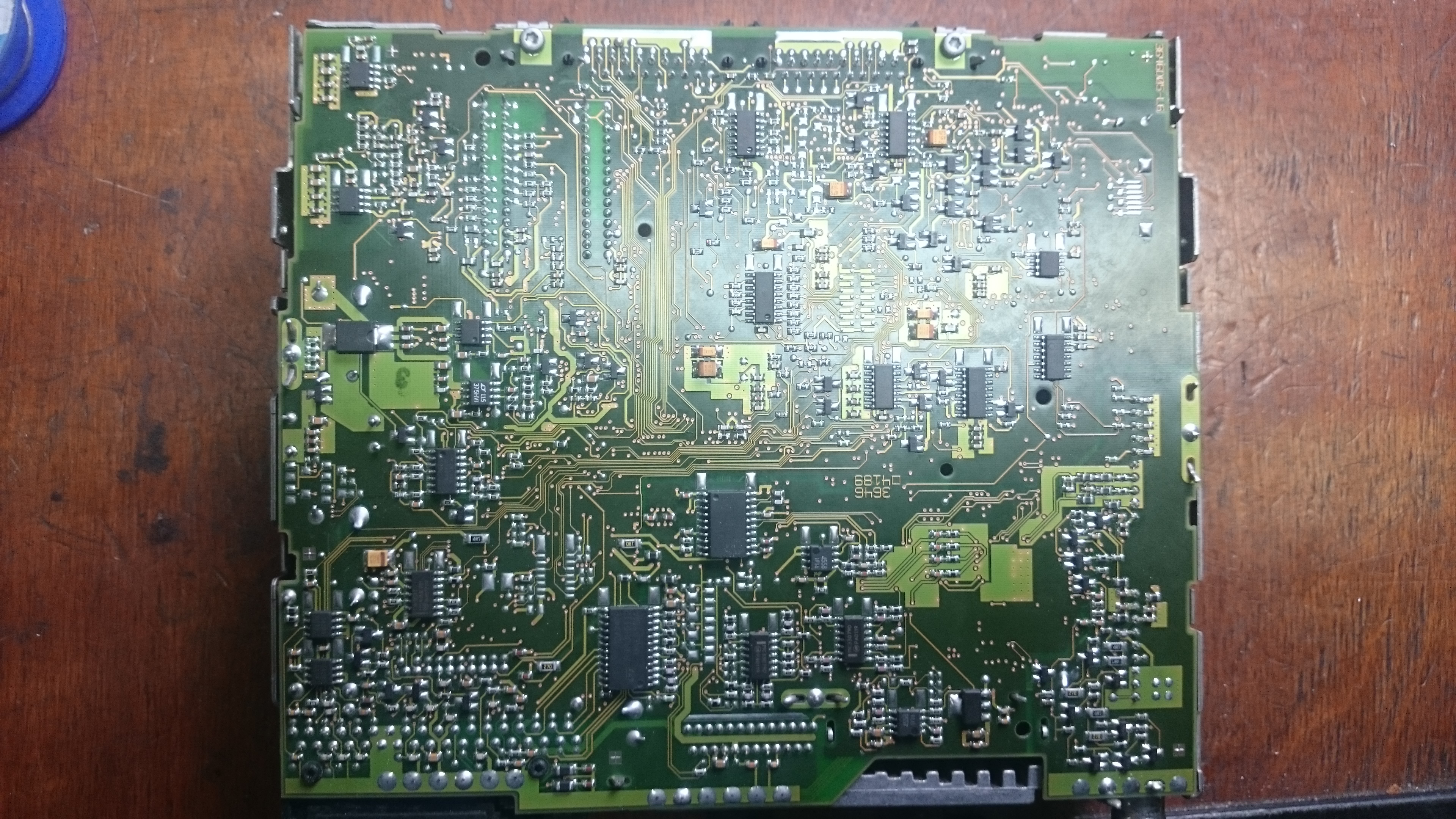

    Hello .
    I have an MCD Radio Navigation System and I need a code for it.
    I have car prog but it doesn't read the code because an error pops up.
    anyone has a diagram of how the a4 adapter should be connected to this radio?

    what memory sits there?
    Added after 9 [minutes]:
    Give the exact model of the radio, best with a photo, I will guide you.

    I'm throwing in the batch with 24c01
    MCD Radio Navigation System: CarProg A4 Adapter Connection Diagram for Code Retrieval MCD Radio Navigation System: CarProg A4 Adapter Connection Diagram for Code Retrieval
    • 24c01.bin (2 KB) You must be logged in to download this attachment.

    This radio has a code in f sharp.
    Fire up cp car radio vw-audi Blaupunkt and select vag navi mcd 24c32
    Adapter a4 and go to work
    In cp you have a detailed description of how to do it!
    Connect to the 12v power supply, run until it shows to enter the code or safe then reduce the power supply to 7.5v and connect the CP.

    I have everything connected according to the scheme and it still gives me an error and does not want to read the code. Anyone know why?

    Tight masses?

    This is a picture taken from the monitor, if so I can see that the code is displayed 1067

    The picture is taken from the monitor but the code is wrong and does not match. Have any ideas?
