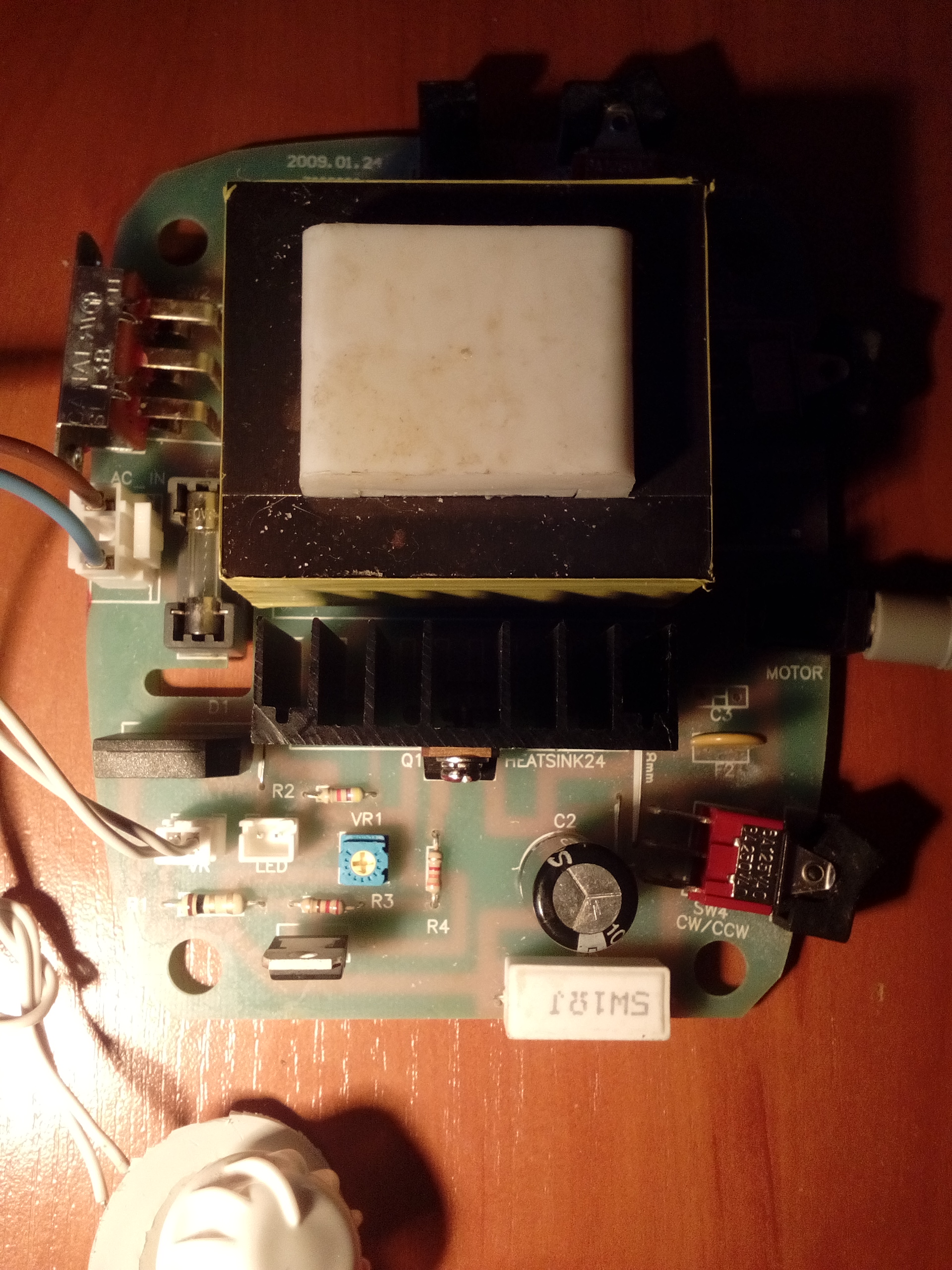

    Hello. I have a problem with the milling machine. Only high speed works. I checked the potentiometer and it works correctly but the speed does not react. After unplugging the potentiometer all the time at the highest level. What could have been damaged in this system? I will add that turn left turn right, control leg or manual also fine ... Please help what to check or what to replace ... Regards Marathon Combi 24 Nail Milling Machine: High Speed Only, Potentiometer Checked Marathon Combi 24 Nail Milling Machine: High Speed Only, Potentiometer Checked Marathon Combi 24 Nail Milling Machine: High Speed Only, Potentiometer Checked Marathon Combi 24 Nail Milling Machine: High Speed Only, Potentiometer Checked Marathon Combi 24 Nail Milling Machine: High Speed Only, Potentiometer Checked

    Without measurements it is difficult to accurately suggest, but first check (replace) U1 and Q1.

    It is hard to mention today because the shops are closed ... I can only measure. And what should their approximate values be?
    Added after 34 [minutes]:
    Measurement...
    U1
    1-2 225om
    1-3 8-cell-14.5 cell
    Q1
    1-2 900om
    1-3 8kom-15kom

    Buddy, such measurements are a matter of ... ;)
    U1 to LM317 download DS and see what it is, compare with what you have on pcb and take voltage measurements.
    Q1 can't see the inscriptions on it, but download DS and see what it is, possible measurements with a diode tester after disassembly.

    Thanks Adam for the tips ... You know I'm not an electronics player so I can smoke a gaff sometimes :) I will check it at work again later
    Added after 1 [hours] 59 [minutes]:
    U1
    LM317T
    V out 0.82
    V in 2.16
    Q1
    BDW93C
    V out 1.0
    V in 1.08
    Measured values on the device switched on

    I'm sorry to interfere - how did you measure?
    The minus probe of the meter should be connected to ground - in this case to the negative leg of this large capacitor.

    I desoldered the transistors and checked the diode tester ... Incorrect values. Tomorrow I will buy new and solder. Will write or work. Thanks for your help and interest.

    LM317 is not a transistor! His doesn't work that way.

    In the system by measuring voltages. Here a colleague wrote.

    I solder new U1 and U2. Turnover still only high. Where can the problem be?

    You've already got hints that you have to take voltage measurements, you also got hints on how to do it correctly:
    Measure this voltage for now only on the LM317, check if the voltage on the OUT leg changes as you turn the potentiometer.
    bozo86 wrote:
    leg or manual control also fine ...
    Write something more about it. What is this control?

    Desolder R3 and R4 and check if it is regulated by the potentiometer, the voltage on the LM317 middle foot, how you checked the potentiometer, and what the R range is.
    Desolder one leg of each R, measure and write us the resistance.
    Desolder and check VR1.
    Take a good photo of the tile from the paths side so that I can see what it connects to.

    Wiajcie. After replacing U1 and Q1, the speed was high all the time. According to your suggestions, I checked everything once more and it turned out that the R3 resistor is also damaged and the potentiometer once worked correctly and once not. After replacing all the elements, the speed control works as it should ... Thanks to everyone for help and advice :)
