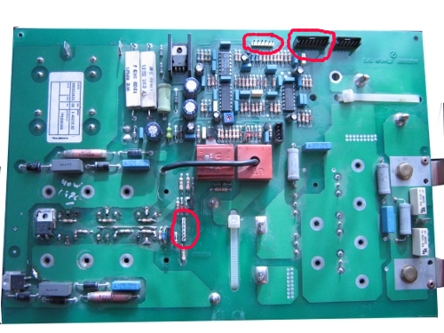

    I received a Cemont S 1601 BluMaster welding machine for repair.
    I need to identify 3 elements because the previous "professional" did not replace the transistors with their inefficient soldering, they exchanged what you can see, two more LEDs and replaced some element on the power board with wire. After which he left it.
    I am asking for help in determining which elements should be in the selected places, because I am not sure if these elements are correct values?

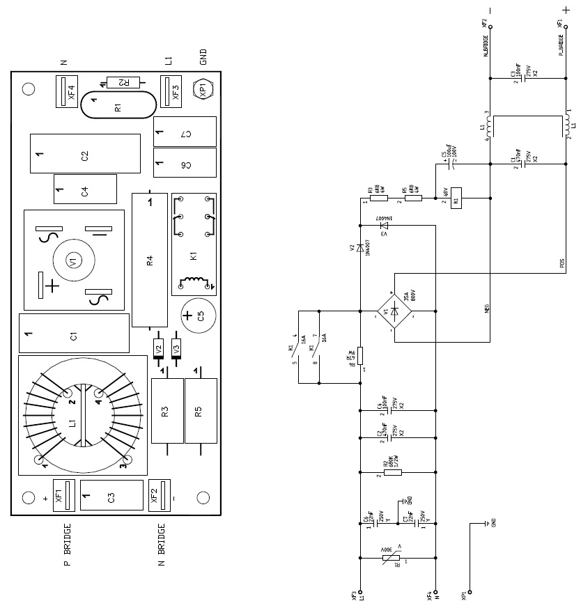

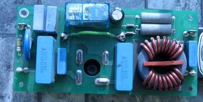

    In place of the green cable you need to give a resistor, I do not remember the exact value but when you give ok 12 ohm / 5W it should be fine, this resistor is damaged as there is a short in the power block or there is something wrong with the relay that should resistor shortly after switching on. As for this blue diode, you have just one above it so you can see how it sits there, probably it is a Zener diode at 18V. The diode above this red current transformer (the one with four of them the same) is a common rectifier diode - 1n4148 will be good.

    So, yes, the peezer is good, the transistors are replaced only once again I will have to solder them because I fear to look. Diodes as you say agree. I entered the sign in the goggles and jumped out what you wrote or 18V 1 W and the other is a simple rectifier. There is one mentioned diode similar to the transistor, it also had to be burned but it is next to the second one and the system is similar, so I assumed that it is also correct. Besides, I measured all the diodes and transistors on the disc, it would seem that everything is fine. Please, hint if something else could have been damaged?

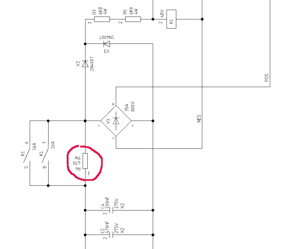

    From this it would appear that the current limiting resistor should have 47R 9W or do I think well?

    You think well. But check with the meter after connecting in series with the 100W bulb network (after disconnecting the rest of the circuits on the N bridge and P bridge terminals) the voltage at these terminals.

    As for this resistor, I suggested the construction of another (similar) welding machine and this resistor had 12 ohms. If there is such a possibility, it would be possible to disconnect the power block as described by colleague Krzyś33, so that only the low-voltage part works and catch the oscilloscope waveforms at transistor gates. Some welders have voltage control and then there will be no waveforms, but this one does not look too advanced :)

    So, yes, I connected this resistor and connected it to the power supply and at the output showed me a voltage of 320 V. I found that it is good, so I connected the rest of the system and switched it on. The LED on the front panel lights up, the fan has started, the capacitors have charged and the diode has gone out. The fan goes on with the 320V voltage, nothing burns but there is no voltage on the terminals. After turning off and waiting until the capacitors are discharged and reconnected, the story repeats itself. I wonder if I miss something because three free slots have been left on the album. Unfortunately, I can not find a schematic and I do not know what to connect, or there should be anything connected at all.

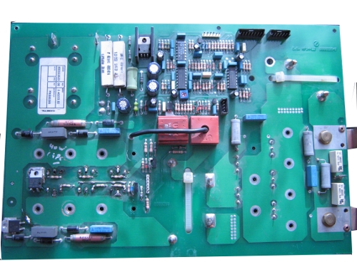

    What is the layout of the "power block" of the power block? Usually there is some sg3525 or similar. I suggest you start analyzing the plate from this merger because it does not seem to have control runs at all.

    I found a diagram of a similar plate, this black connector is used there for the plate which I do not have, so it probably should not be connected. As for the rest, probably not because I do not see anything missing. As for scalak, I do not know because I have this welder at work, I will look tomorrow, but since you claim that it can be from this I can replace them all because I have only three of them. Well, unless you are programmed?
