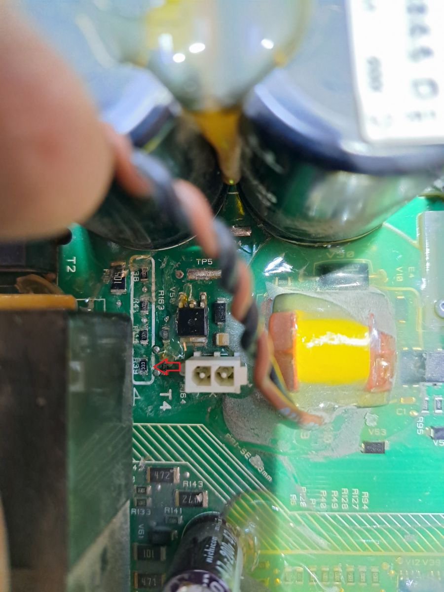

    I repaired Kemppi minarc 180 evo, which have these symptoms.
    - Panel powers on
    - Charge relay switch on and off
    - No power output

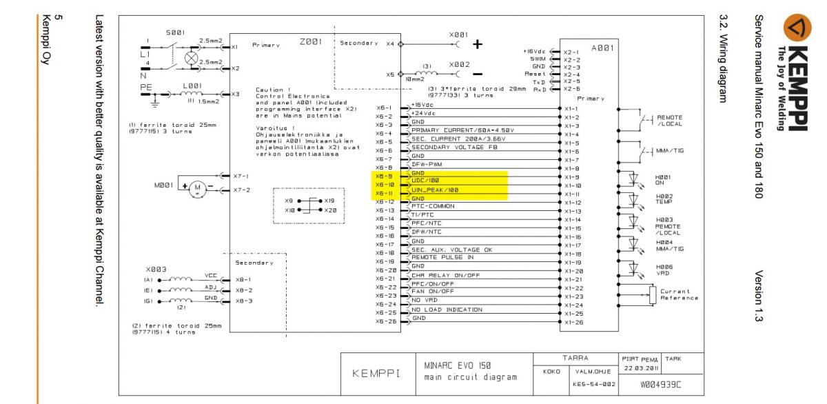

    R39 in UDC detection circuit was defective, no visible damage but infinite resistance.
    Connector X6-10 UDC/100 detection voltage was 5V volts, should be in about 3.9V
    BE CAREFUL PRIMARY SIDE VOLTAGES !
