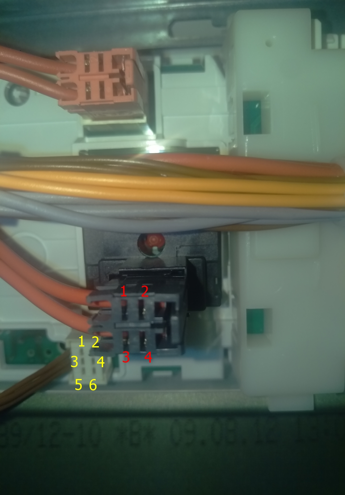

    The problems themselves were blown up by the meter :| Photo of the appearance and symbol of the module.
    Bosch WAS24463PL / WNM52 - the washing machine interrupts the wash, turns off, t Bosch WAS24463PL / WNM52 - the washing machine interrupts the wash, turns off, t Bosch WAS24463PL / WNM52 - the washing machine interrupts the wash, turns off, t
    I want to measure the tz voltage. to make sure that I am thinking correctly. Voltage - black cube pin 1 + pin 3 = 230V - so it should not be. A few more photos of the module, I took it out and tomorrow I will try to take more detailed photos in daylight, maybe someone professional eye will notice something.

    Replace the chip of the module's voltage converter. What layout it will turn out when you present photos of the power supply module and not only photos of the touch button module so far. It will probably be the LNK 304GN system, like here https://www.elektroda.pl/rtvforum/topic3005248.html

    Gentlemen, I just got home after a long absence. I pulled out the washing machine, took off the top cover, where is this power supply module? is it down below the drum somewhere? I can't track him at the top of the washing machine.
    : edit:
    I found it, I understand that I would look for such a chip and replace it
    TNY267GN
