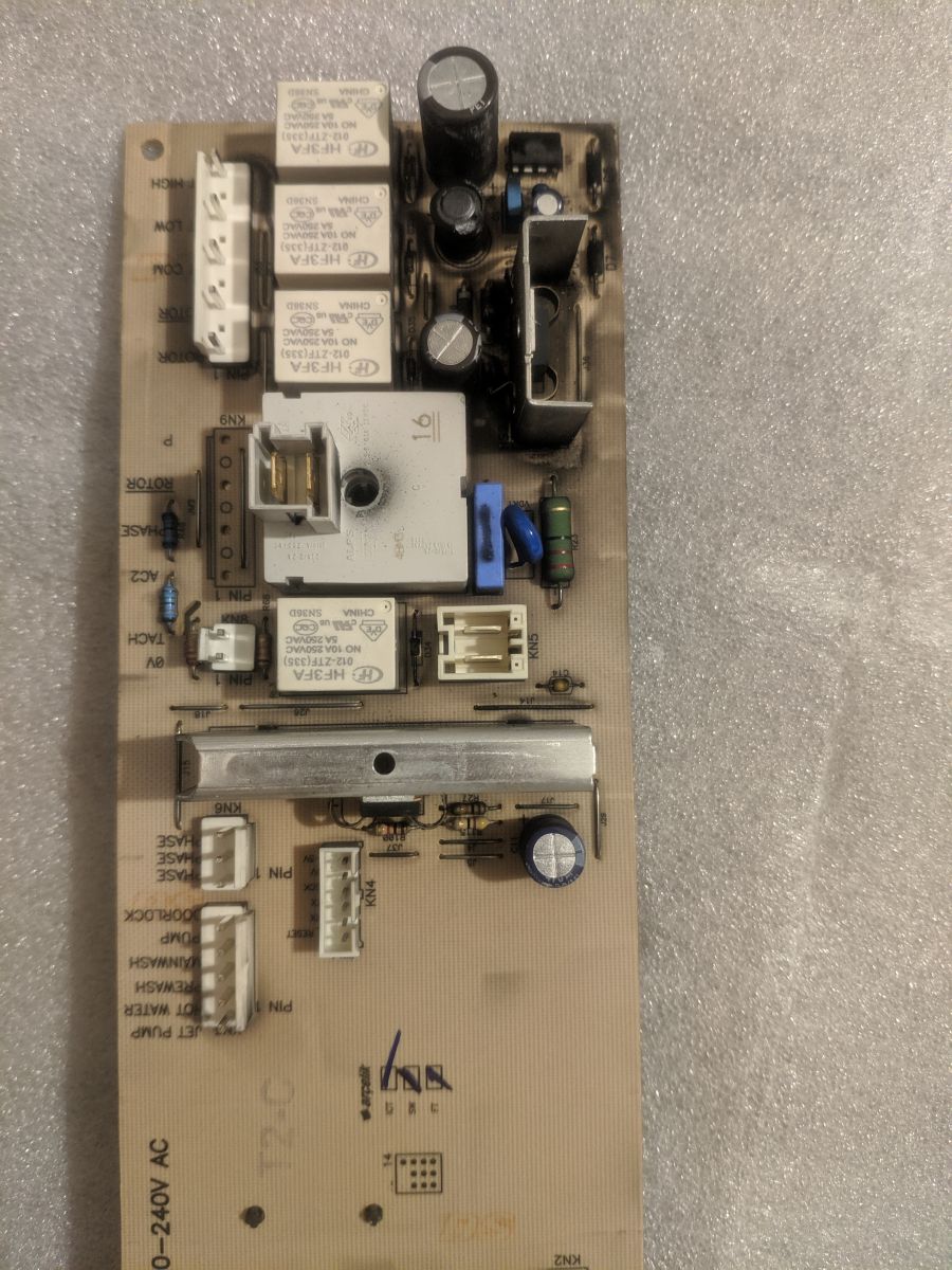

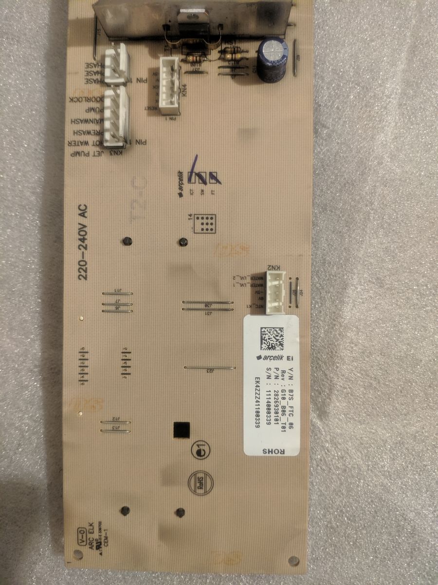

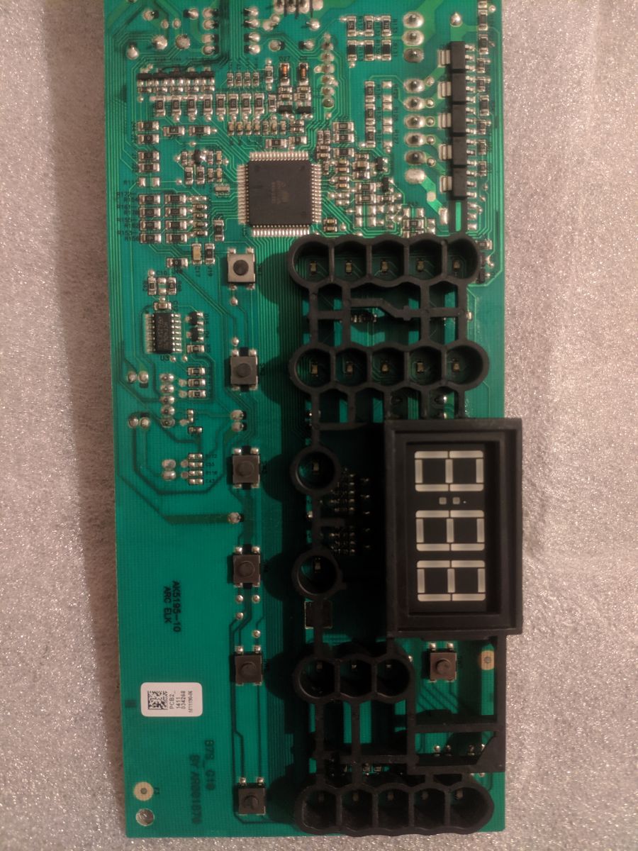

    Damaged programmer in the Beko WMB61032 washing machine, and I have a question if the same programmer was appropriate in other models. I am looking for a functional used one, but I cannot find it for this model, and it is available for e.g. WMB51032 or WMB61231. They visually look the same.
    Markings from the programmer:
    Y / N: B7S_FTC_06
    Rev: G10_B06_T02
    P / N: 2826930101
    S / N: 1415004613
    EK4ZZZ51404613

    A photo of the programmer and a description of the damage would be useful, not a photo of the washing machine.
  • #3 17181686
    traksmetal
    Posts: 61
    Rate: 25
    The washing machine did not finish the wash, black screen, no reaction to turning the knob. Power goes to the panel. There is quite a strong burnout on the panel in the vicinity of these small black W501 107MN0 cubes, in one, first from the left, a burned hole.

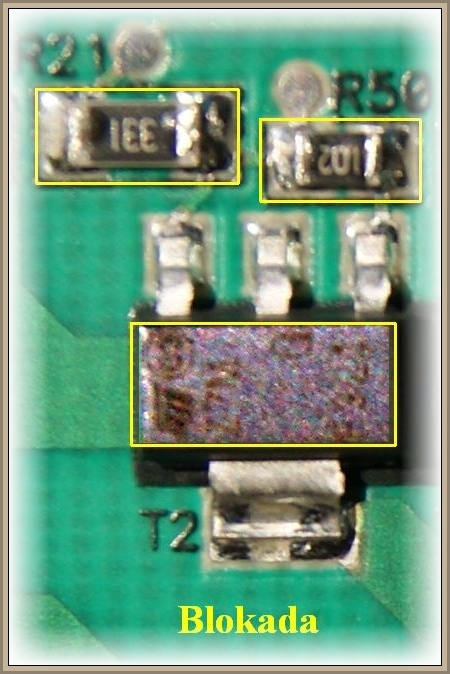

    traksmetal wrote:
    I'm looking for a used one
    Why, if you only need to replace these elements on the PCB (photo) and maybe the blockade :D
    Close-up of a PCB with highlighted electronic components.

    traksmetal wrote:
    Because it seems to me that in addition to this triac from the door lock, something will be damaged.
    I have marked both SMD resistors for checking or replacement.
    traksmetal wrote:
    It seems to me that before that, regardless of whether the door was closed or not, the display was activated after turning the knob and setting the program.
    In the photo in the first post, the display is on, and if on the table after supplying the supply voltage, it does not shine, the converter needs repair, but as you can see you will not get it anyway (as it results from the posts) ...

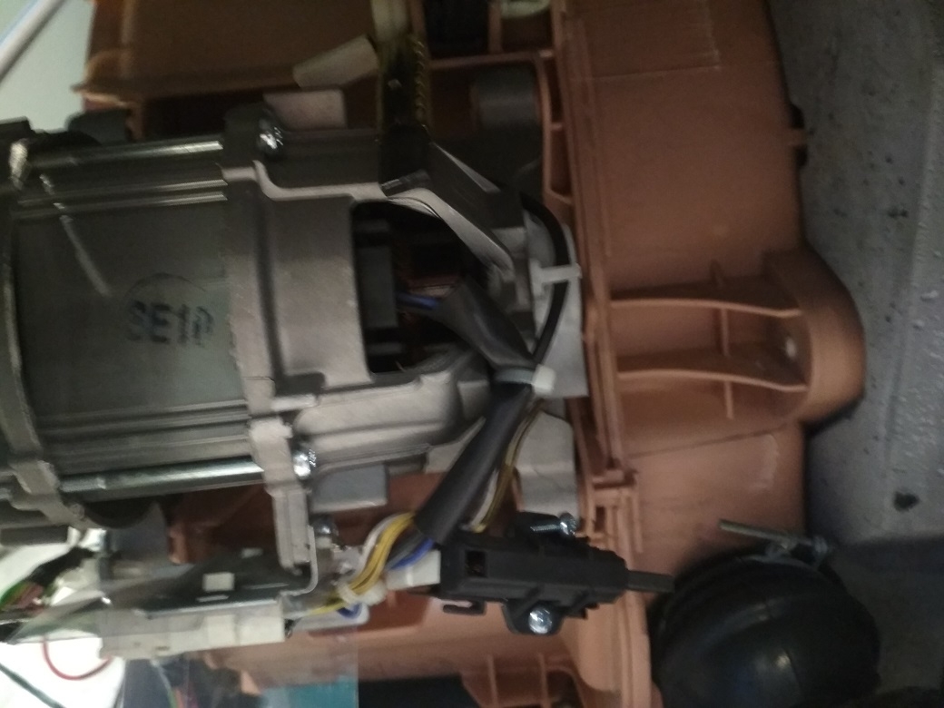

  • #14 17218289
    Kenworth 18
    Posts: 11191
    Help: 2427
    Rate: 3728
    First of all, throw away the old lock and do not install it.
    Secondly, since the failure started with the failure of the washing machine's drive motor, start by checking the condition of the motor's carbon brushes.

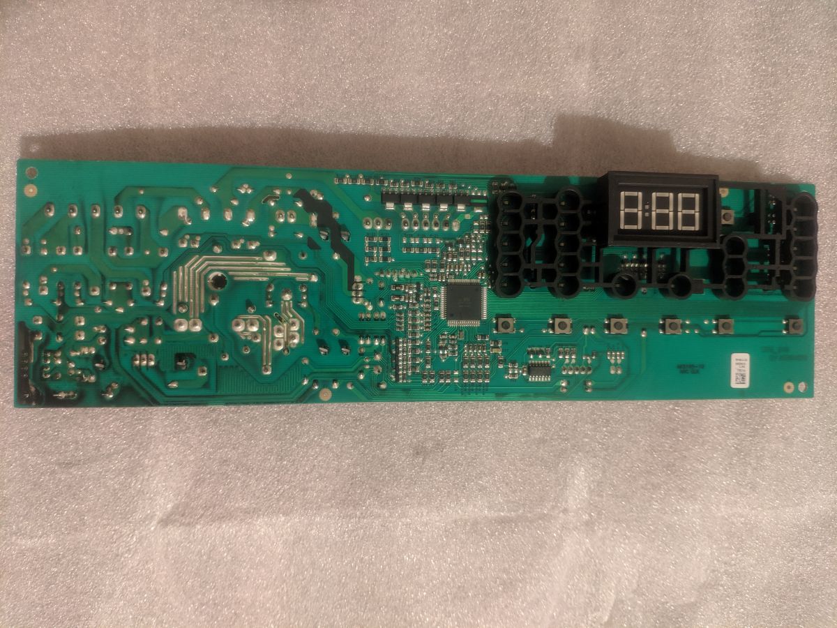

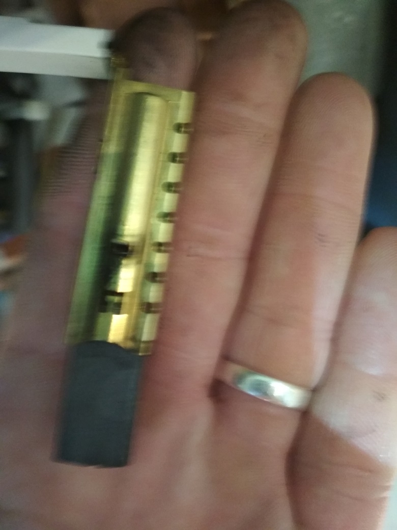

    Beko WMB61032 Washing Machine: Faulty Programmer Compatibility with WMB51032 & WMB61231 Models Beko WMB61032 Washing Machine: Faulty Programmer Compatibility with WMB51032 & WMB61231 Models
    One more thing that comes to mind is that my wife packed the washing machine quite tightly with laundry blankets. From what I remember, this washing machine has a water intake sensor depending on the weight of the things thrown into the drum. The washing machine took up water, the blankets got soaked and maybe it worked or the sensor is blocked?

    Now the motor control triac measurement will be indicated next.
    A colleague could have mentioned to the electronics engineer who replaced the triac locks and resistors that the washing machine motor did not work, he would immediately replace this element.

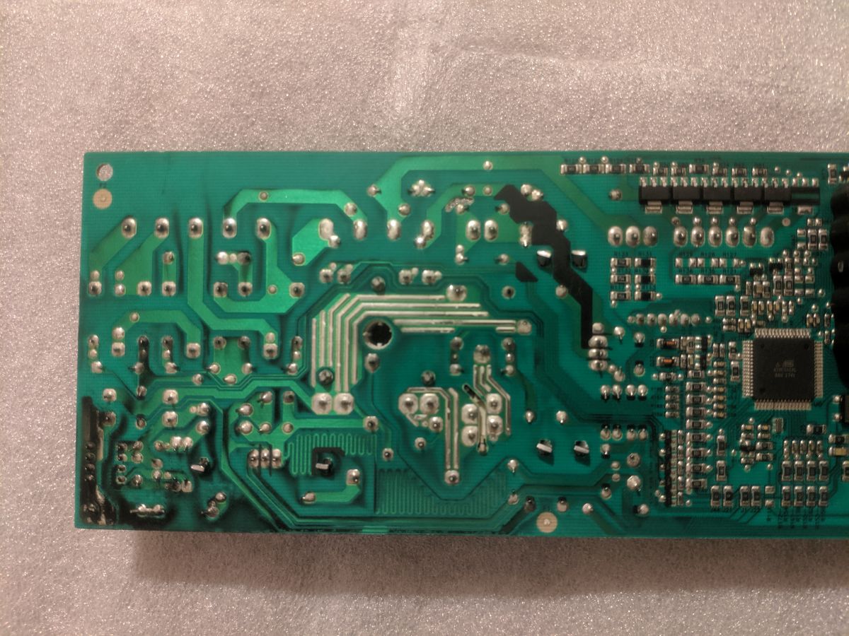

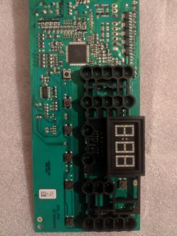

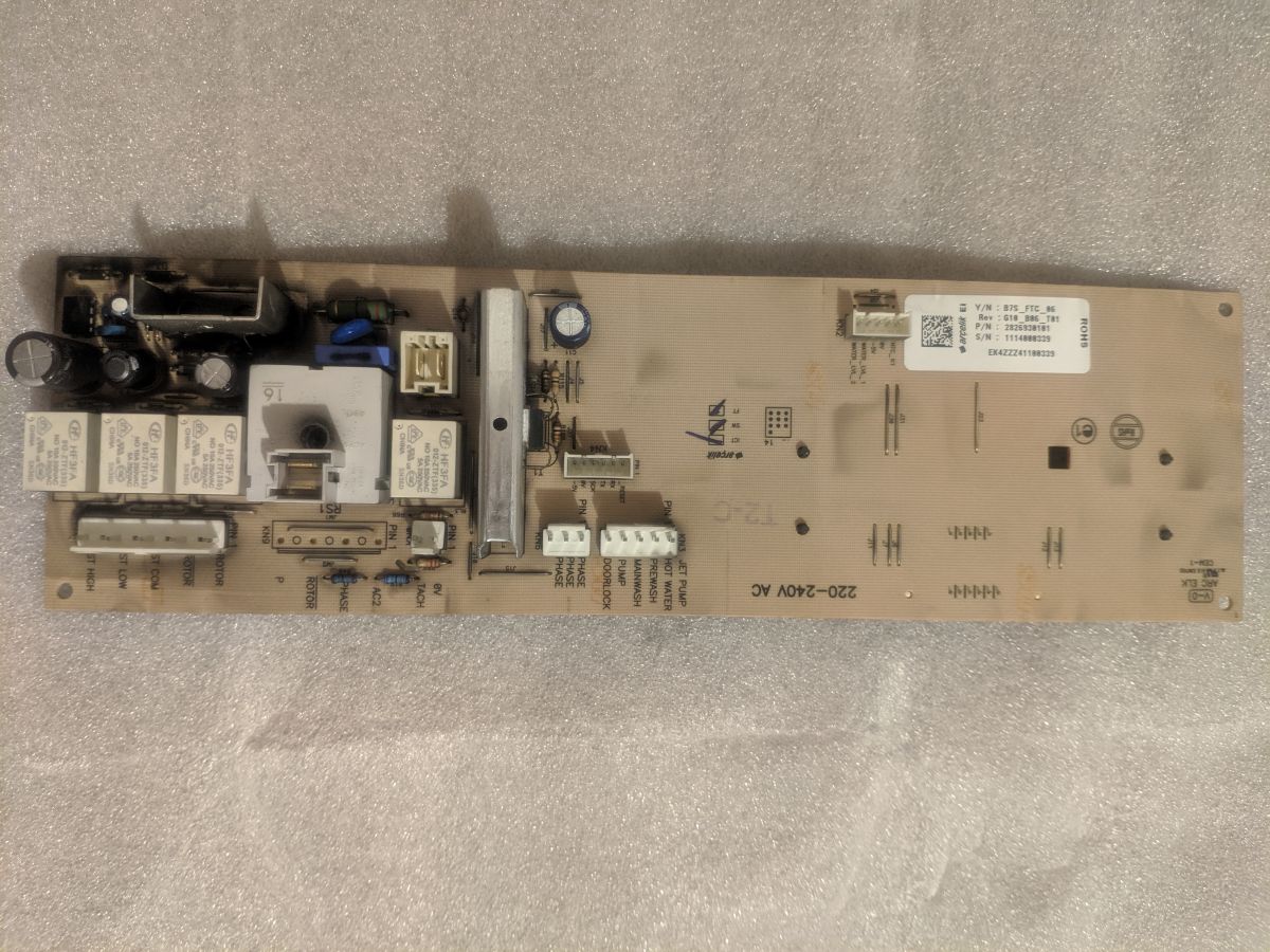

    I will step on the topic refreshing it with the same plate.
    The washing machine with timer washes, runs full programs, but does not heat the water.
    The heater and the sensor in it were checked, the electric lock was even replaced and nothing else.
    There is something black in the third and last photo. ???

    Everything indicates a failure of the heater control relay. Unfortunately, all relays on the board are the same, so you have to determine yourself by following the paths from the heater connector, which should be desoldered and checked.
