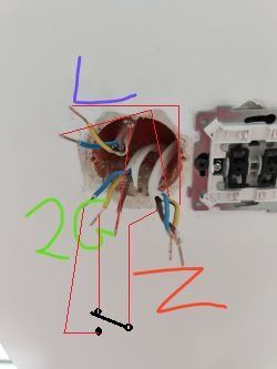

    Hello, how to connect staircase switches? One box comes with a power cable, a lamp cable and a cable from the second plug. How to connect it to make it work? And in the second box there is a cable from the first box to the switch.

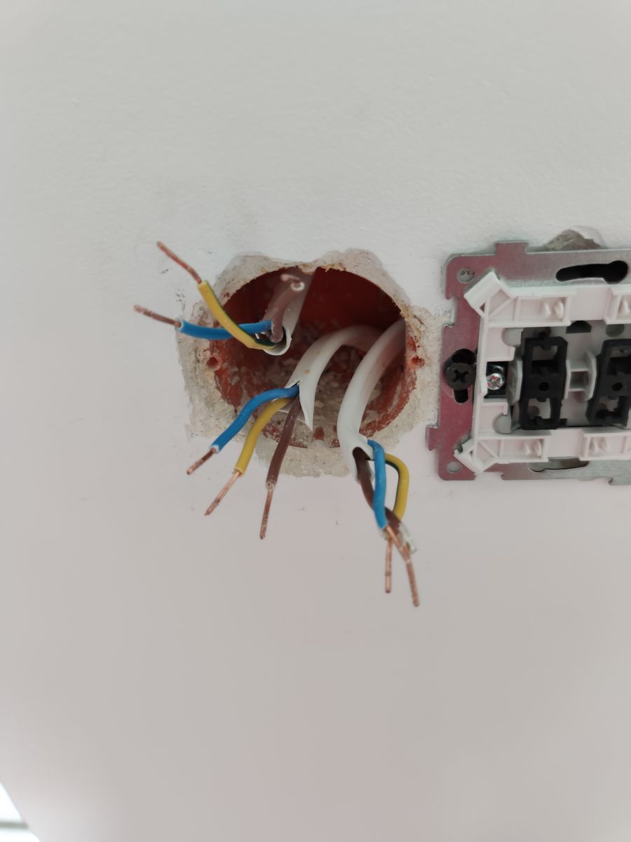

    #8 19589440
    Tadek67
    Posts: 44
    Help: 15
    Rate: 24
    You need to determine /mark in the photo/ which wire is the power supply, which is for the bulb or for the second connector

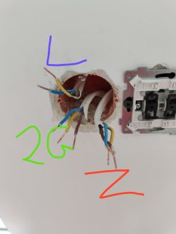

  • #10 19589466
    cmik21
    Posts: 22
    Rate: 10
    Z- power supply
    2g - second socket
    L- lamp
    Connecting staircase switches: instructions and diagram for a 3-wire cable

  • #12 19589488
    cmik21
    Posts: 22
    Rate: 10
    Can`t anything be done with what I have?

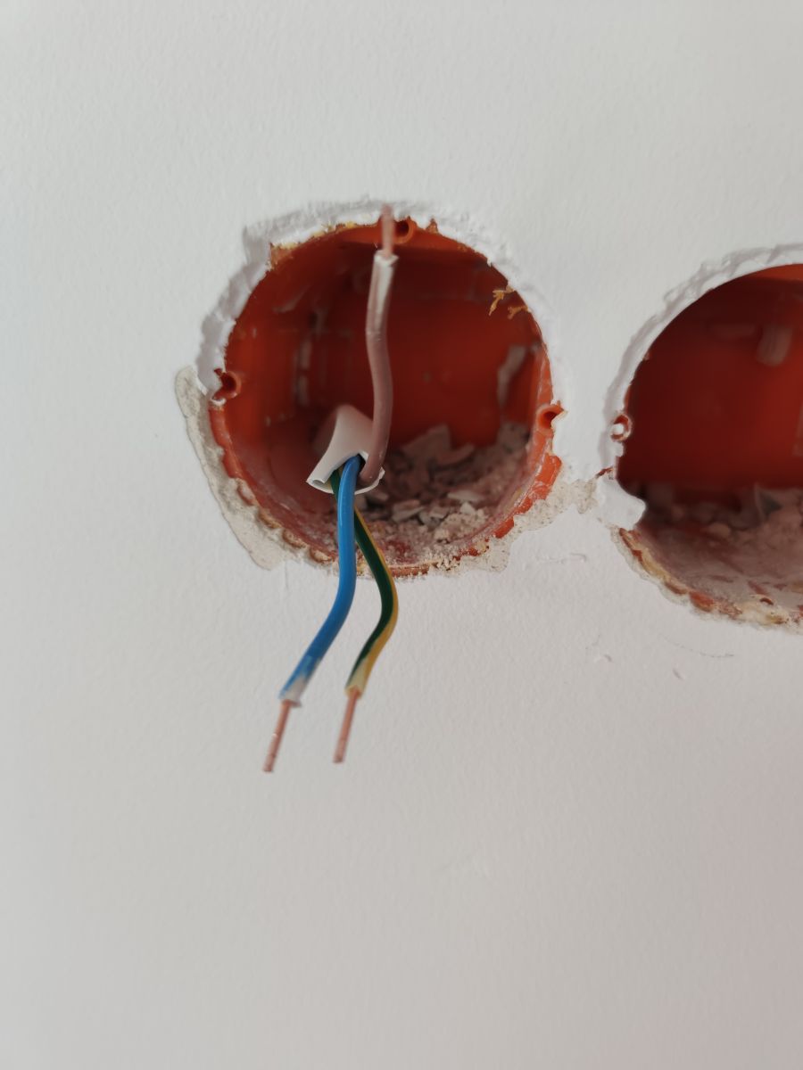

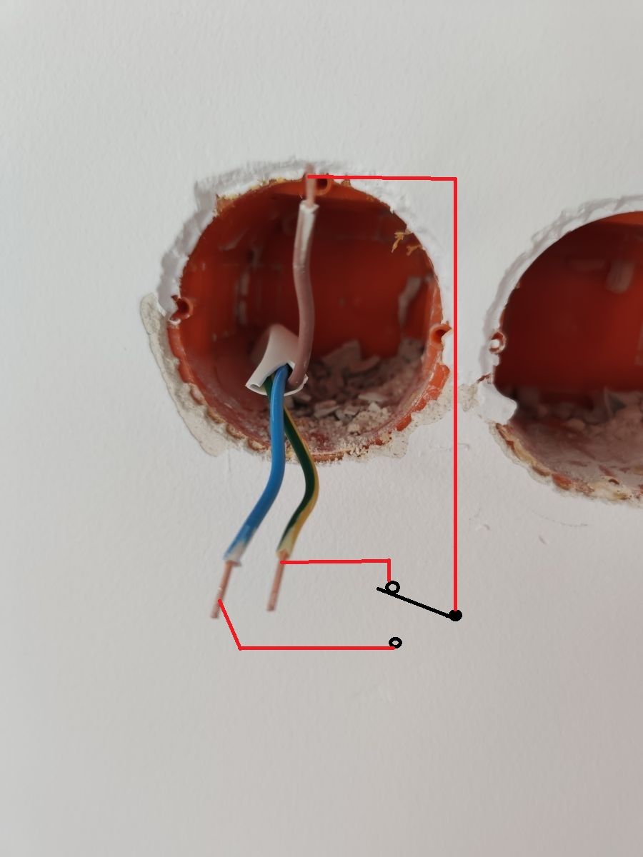

    #13 19589518
    Tadek67
    Posts: 44
    Help: 15
    Rate: 24
    Connecting staircase switches: instructions and diagram for a 3-wire cable Connecting staircase switches: instructions and diagram for a 3-wire cable

    #15 19589559
    Tadek67
    Posts: 44
    Help: 15
    Rate: 24
    zbich70. Right, but what is he supposed to do? Rip out the wires? Man wanted to cope with what he had.

  • #17 19589579
    cmik21
    Posts: 22
    Rate: 10
    Thank you Co Tadek, I bought such an apartment and a pseudo-electrician from the developer laid the cables. Thank you again.
