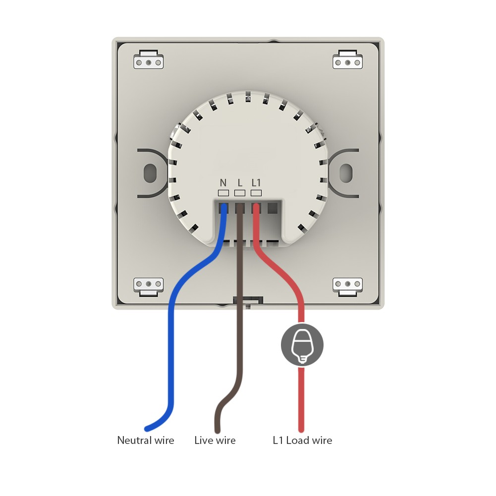

    and such a switch has a diagram:
    How to connect the Koogeek Dimmer Switch to an installation with L, N, PE?08-2.jpg (52.58 kB)You must be logged in to download this attachment. .
    Is this compatible?
    How to connect this L1 ?
    Thank you very much in advance!

    This is probably a two-key switch. If so, then unfortunately you only have a phase there (possibly on the brown wire) and then you feed this phase to one consumer via the blue wire and to the other consumer via the green-yellow wire. The latter is unacceptable as the green/yellow wire is only used for protection. From this it follows that you have no N in the box and your circuit breaker needs it.

    If you have the possibility to draw the N and PE wire to this box then you can connect this novelty but only to one circuit as you cannot use this yellow-green wire.

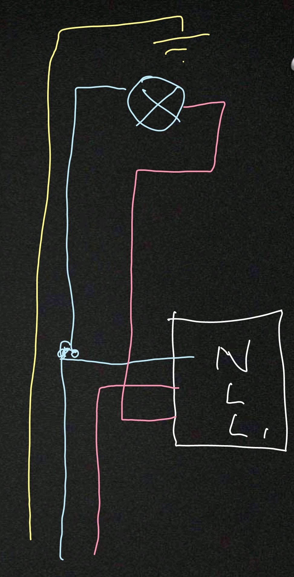

    And shouldn't it be like this? Probably some American invention with this L1.
    How to connect the Koogeek Dimmer Switch to an installation with L, N, PE? .

    And what don't you like about your own almost good drawing (no protective to the N, L ,L`-square point).

    Sorry, the author confused me by writing that his installation is "typical". I only now enlarged the picture and saw what was done there.
