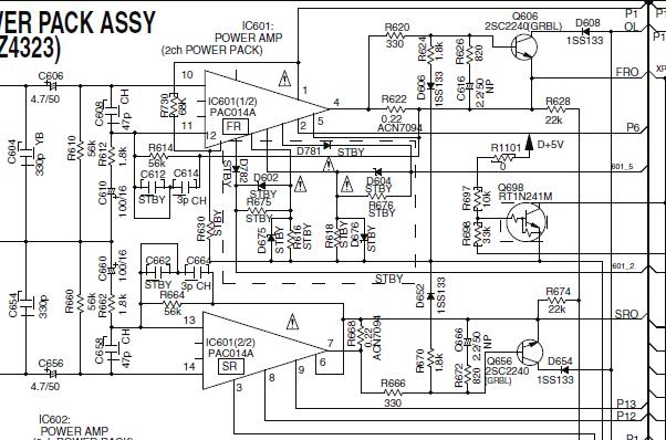

    I am asking for a hint, will the above-mentioned STK442-110 / 130 system work for PAC014A?
    Like so, is there any layout modification needed?
    The applications themselves are very similar to each other and the price is much lower for the STK442 chip.
    I am asking for a hint, where can I get some STK442 tips?
    Thanks in advance for the hints.

    They are definitely not interchangeable systems. According to the reports of those who tried to insert alternately, the system was damaged after a few minutes.
    Please analyze the power supply method in your target application:
    - the voltage part of the power amplifier is supplied with a stabilized and higher voltage than the current stage.
    The difference is also with the application for pin 5-6 and 6-7. The original circuit appears to have at least one emitter resistor inside for the final stage.
    Theoretically, STK systems can be adapted to work in this configuration, but will the workload be adequate to the savings?
    And usually PAC 014A will get a guarantee, even 12 months, for correct operation, in the case of cheap STK, unfortunately not.

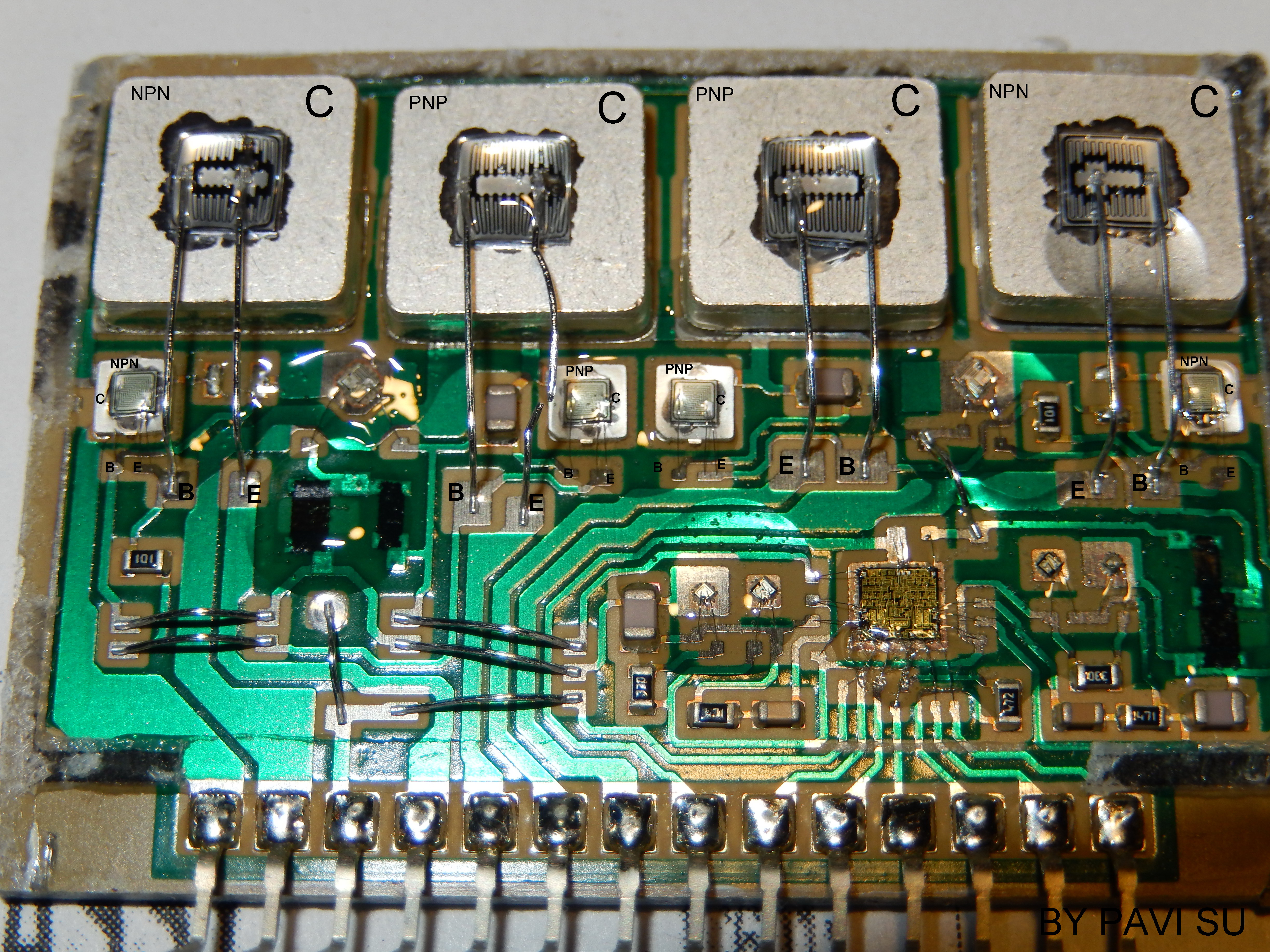

    I tried to repair the old hybrid, but the signal to the executive transistors was already wrong from the op-amp placed inside.
    No emitter resistor inside.
    I give a photo of what it looks like inside to compare it with the stk application.
    Kisses

    It can be seen that the system is implemented in a conventional embodiment of the final complementary stage. However, the designer somehow had to deal with the effective stabilization of the quiescent current, stabilization of the output transistors, without a single negative feedback resistor. The system has much better parameters than the STK442-110 / STK442-130, at least the parameters declared in the characteristics of the receivers in which it is mounted are better. The design has certainly been carefully thought out and developed.
    The voltage block is powered from a stabilized power source, so it is unlikely that it will damage the integrated structure of the operational amplifier without damaging the stabilizer (theoretical assumption, of course, because we do not know the complete schematic of the entire hybrid amplifier). Did his colleague check all the transistor structures, including the control one?
  • #5 16361589

    Just out of curiosity, I will add that I measured the rest of the elements.
    And the two elements between the power transistors, it's hard to tell what it is after the measurements, while the transistor and diode on the left and right side of the operational amplifier are measurable and functional.
    I'm looking for the original. End of combining.
    Thanks again.

    It is therefore necessary to dynamically check the power supply of the system before installing a new one.

    I am ordering the original
