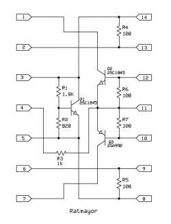

    Since I have already bought two PA0016 chips and both are unfortunately not working (I check them on a working channel), I wonder if they can be replaced. I found on the net this:
    Pioneer Amplifiers: PA0016 Chip Replacement, Circuit Diagram & Trusted Sources Pioneer Amplifiers: PA0016 Chip Replacement, Circuit Diagram & Trusted Sources
    Question
    - is it a real or a simplified diagram of this system?
    - in short, is it possible to make this simple layout and replace the original?
    - if not, where to buy a proven and working PA0016 today?
    Maybe someone has already worked on this topic and can confirm / deny it?
    Thank you in advance for your help

    There is a quiescent current regulator in this system.
    Wojtek(KeFir) wrote:
    It is responsible only for the stabilization of the quiescent current and the overcurrent protection of the power stage. Theoretically, you can run the amplifier without it at all.
    Without stabilization of the quiescent current, the amplifier may be damaged.
    Try to make this layout according to the diagram you sent.

    Unfortunately, the PA0016 replacement solution is not that simple. After all, on the page from which you took the solution, you have the answer:
    Errors enthusiasm, short circuit protection transistors Q2, Q3 in the collectors have 1500 Ohm resistors! and are connected to the resistors in the Q129 and Q131 drivers base.
    Therefore, Q2 and Q3 cannot be protected and installed in vain.
    From UH in parallel to the resistor R4 = 100 ohms (in the enthusiasts diagram)
    in the amplifier circuit there is a circuit R159 = 270 Ohm + C119 = 68p, then through R171 = 100 Ohm to the base of the control transistor.
    NOT logical.
    In the Pioneer AX530 circuit, you can see the block diagram of the PA0016

    Basically, the damage to PA0016 is a consequence of a malfunction of the rest of the system, in particular the input stage. There must be fairly precise symmetry in the circumference.
    What exactly is the amplifier model do you have?

    What am I going to? Well, PA0016 can be equipped with quiescent current detection, which interrupts the operation of the system in the event of extremely incorrect values. Not having plugged transducers. end, you are definitely reducing this current.
    There is no such thing in the system, therefore, at the slightest malfunction, the system is damaged.
    There is, however, the "Over load detector" detection system and the measurement of voltage drop across pin 10 and pin 12 emitter resistors. Lack of proper continuity in this path may cause various malfunctions.
    Replacing a working system that is working properly with a system purchased for checking seems quite unreliable in such a precisely working system. The monolithic structure is not identical and similar, therefore each copy will have slightly different operating parameters - the spread.
    It is good to physically and actually check all the values of the cooperating elements, as well as the continuity of connections.
    After all, there are not that many of them.

    aaanteka wrote:
    o an amplifier with parameters that actually exceed the typical class AB transistor designs is not intended for this purpose. Well, "audiophiles" praise its sound until the present day.
    Yes, but I prefer and recommend solutions without any freaks. Old Yamaha or Harman Kardon also get very good opinions, and they were often implemented only with the use of typical elements.
    It is true that it is a pity to combine such an amplifier with substitutes, but in Harman, for example, I was very pleasantly surprised by the fuse resistors, which protected the entire system. And on my current Kenwood KA-7X, repairing the steering stage did not cost a fortune. Although if it failed very much and burned all the final Toshibas, it would not be cheap on the full originals (I'm deliberately omitting a bit of other Sanken here - privately I would go for a full factory here), but I prefer it to Pioneer - in the VSA-1000 I had the final burned and I had to do a bit other insert + to this today already high cost of PA0016.
    An amplifier is an amplifier, one of the most vulnerable devices in the audio path, and it should be a design that is easy to repair.

    Therefore, a discrete solution as shown can be used higher and enjoy the full Super A class for little money compared to PA0016 and similar systems.
    But it is not ? The cost of repair is different.

    aaanteka wrote:
    Therefore, you can use a discrete solution as presented above and enjoy the full Super A class for little money compared to PA0016 and similar systems.
    It is possible that the sound will be good, but it is still an interference in the factory and for me a much smaller modification is the insertion of typical electronic transistors instead of the originals in some Japanese, fully discrete construction. Which does not mean that I am a supporter of both.
    aaanteka wrote:
    In my opinion, it is not, because you have to buy the expensive PA0016 or modify the system. Following this path, the Technics SU-v560 is affordable, because in the event of burning the whole AA class chain, I will put something else. Well, what will be left of the original? Sure, you can have such an approach, but most of all, it's not the equipment anymore.
    And the costs are always there, as long as we want to use exactly the same transistor models as the manufacturer. A good replacement is also not bad - I am able to understand it despite my opinion on this subject.

    Buddy, the original does not suit you, because it is too expensive. The alternative is not a factory. You have to make up your mind and choose the right option. By the way, my colleague understands the functioning of the super A class (in fact, it's just a trade name for a pretty cool solution)? In the years of popularity, they were made at the factory either using dedicated systems to reduce production and commissioning costs, or, as JVC, was done discreetly.
    The topic of this thread should also be remembered.
    The aforementioned SVI 3205 for Technics is available in a new version, but it is difficult to expect the same production after such a time. On the other hand, with such old equipment, it is difficult to require repair for a symbolic zloty. After all, this is only a bit of equipment for a connoisseur or audiophile with sentiment.
    It's expensive, but that's another matter altogether. I like my Kewnood kit (KA-7X and KT-9X) and there are no replacements or modifications, so the price doesn't matter. Anyway, I wrote this:
    In my opinion, the amplifier, and especially the final stage built on unusual elements, is an excess of form over content and only the manufacturer will benefit from it - lower costs in the production phase, because silicon wafers are a much cheaper matter than installing THT in each unit and forcing the purchase of new equipment for most consumers (those who do not want to repair for various reasons). And the integrated circuit itself ceases to produce, stocks disappear and there is a problem, as happened with STK a few years ago.
