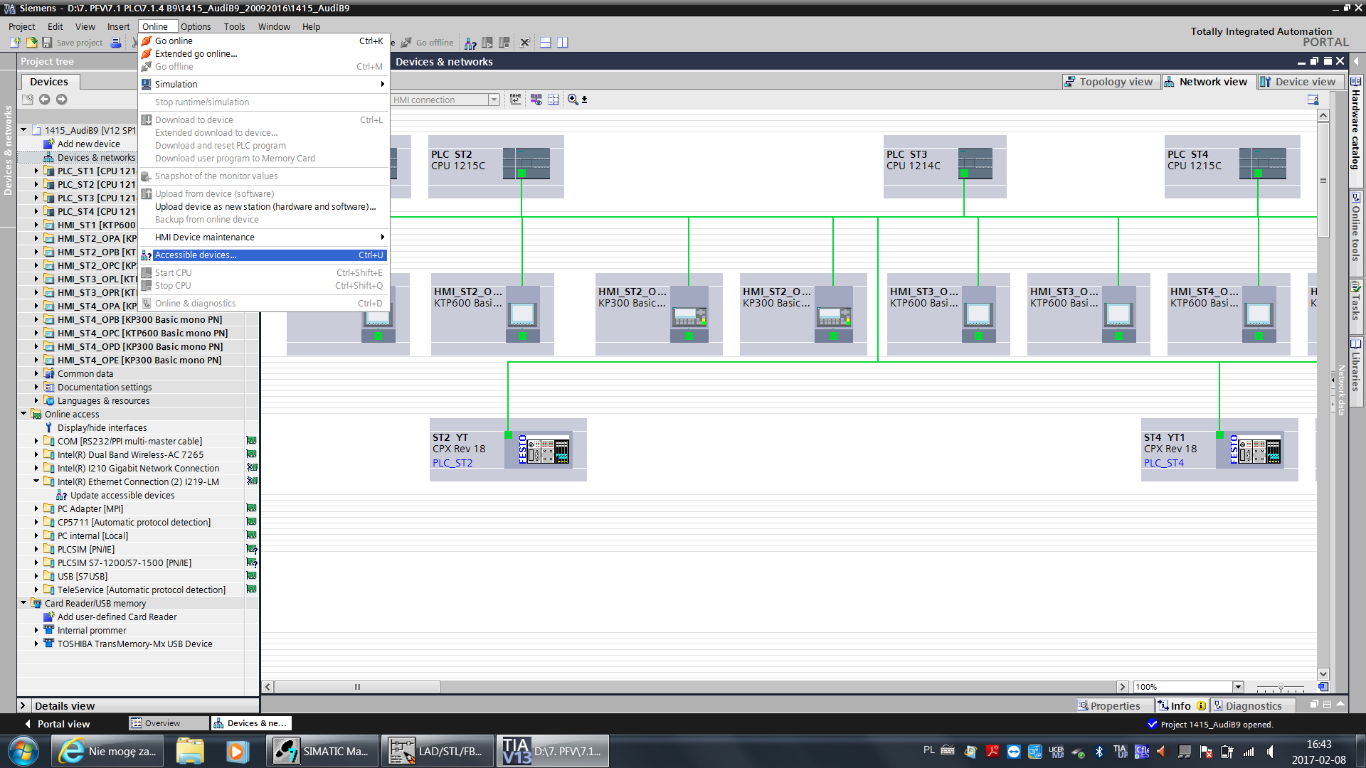

    I have a problem with the communication of the s7-1200 controller with a PC. After connecting to the computer, the driver physically establishes communication (the run / stop mode is on, the Rx / Tx lamp is flashing), but the Tia Portal program does not see the driver at all. I have also tried connecting to other drivers on which I have already done programs and also does not detect them for me. I changed Ethernet cables, turned off windows firewalls, anti-virus etc. The network card seems to be working because the internet connection is ok. It adds that the TIA software is original. Maybe someone had a similar situation and will help with this trivial problem.

  • PLC remains undiscovered despite visible Ethernet traffic

    I would like to do that, but what if I don't even detect it? At least MAC Address should appear to me.

    Dude, try maybe from the top menu as in the attached picture.

    I'm coming back to the topic because I'm being chased by projects, but I still can't connect to the driver. Maybe someone once fought with something similar to that described above. greetings :)
    Maybe the TIA version does not match the firmware version of your driver.
