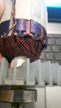

    Hello, I decided to rewind the winding of the damaged rotor from my slash, I have a supply of winding wire and access to the balancing machine, so it should work.
    The rotor has 12 nurseries, and the commutator 24, dimensioned in the photo below (maybe someone has such a rotor for sale or knows where to get it?) The engine theoretically has a power of 1500 W:
    Restoring Winding on Damaged Rotor: Challenges with Dual Wire and Alternating Turns
    The problem is that I have trouble recreating the winding, as if it were wound with two wires at the same time alternately, every few turns - maybe someone with this type of arrangement met?
    Restoring Winding on Damaged Rotor: Challenges with Dual Wire and Alternating Turns Restoring Winding on Damaged Rotor: Challenges with Dual Wire and Alternating Turns
    I was able to play so much, sorry for the crooked drawing

    Dear Friend, have you ever rewound a rotor? Because of
    what I read and see you have never done it and you will not do it correctly.
    The visible rotor has a very simple double wire winding.
    Commutator condition looks good, so professional rewinding
    and balancing should bring satisfactory results. Before removing the old one
    winding should be "removed" wiring diagram of this winding. Clean slots
    lay new insulation and wind up again, then connect to the commutator.
    Wedge the winding, check winding continuity, impregnate and balance.
    Fold the electric machine and run at low voltage and low speed
    measure the current consumed, reach the brush and slowly increasing the voltage to
    nominal to observe his behavior. If everything was done
    carefully and the machine does not heat excessively and there is no sparking, enjoy it
    THE USE
    Heh, you're right, I rewound the rotor only a few times back in practice, about 20 years ago, while the stator happened to rewind more often ;)
    I treat it as a weekend challenge ;)
    You also write that "The visible rotor has a very simple winding made of double wire" - do you have such a winding drawn?
    Added after 1 [hours] 14 [minutes]:
    I don't know if I'm already overwhelmed or too much for today, but I found some nice videos on yt, but the winding of my rotor compared to those from the link is completely different, as I wrote earlier - as if it were wound with two wires simultaneously alternately, every few turns which prevents a simple unwinding?
    https://www.youtube.com/watch?v=V6-w6LmYhnE
    https://www.youtube.com/watch?v=th1QIolXpuY&t=129s

    Strumien swiadomosci swia wrote:
    Take a grill, because you will lose money for wire and varnish and it will fall apart because the rotor must be balanced after all.
    After all, I wrote that I have access to the balancer at a friend's workplace, so this topic interests me, the problem is the winding winding scheme, which is interspersed - I would need an example scheme of such a winding since it is quite simply wound, and in the photo below I marked what I mean :
    You can see that the winding of a single coil intertwines every four windings with the other, so I have to unwind at the same time from two sides, but I have a break in several places and I can not get to order how it is wound ...

    I was able to open the winding pattern, but I repeat my question about the unusual winding, i.e. it turns out that four coils from one roll are wound on the next one - is it correct and why should it be used?
