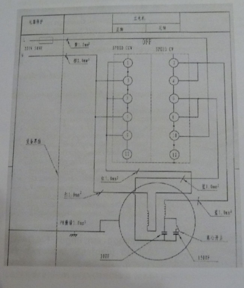

  • #20 17622081
    witek1965
    Posts: 434
    Rate: 121
    Could colleagues familiar with the issue take a look at this diagram and write what to do to make this engine spin clockwise and counterclockwise?
    Single-Phase Motor: Change Rotation Direction with 3 Wires & Starting Capacitor
  • #21 17622162
    Krzysztof Kamienski
    Posts: 21895
    Help: 2033
    Rate: 5167
    You have the diagram ready, so what are you asking? The switch, marked "off", alternately closes the opposite contacts in pairs, for clockwise and counter-clockwise rotation.
  • #22 17622181
    witek1965
    Posts: 434
    Rate: 121
    because I'm not a specialist in electrical engineering. This diagram is from the user manual of the device I purchased a few days ago and has only right spins. The switch has three stable positions. 1-0-2. Position 0 is, of course, the machine is not working, position 1 and 2 are the same speed.
    According to the distributor, this device according to specifications have had only one type of turnover for at least a few years. Where did my question even come from? Well, one machine, coming from the same distributor, has clockwise and counter-clockwise rotation, which caused a lot of interest and questions like, why.
    Moreover, machines of this type usually have a switch with a left rotation position, monostable, for temporary use. If the diagram is correct, then after the warranty period I would like to (a specialized workshop) have both right and left.
    PS The diagram does not necessarily correspond to reality. I can't check it yet.
  • #23 17622331
    Krzysztof Kamienski
    Posts: 21895
    Help: 2033
    Rate: 5167
    @ witek1965 So I will answer straight my colleague. Yes, this motor can easily change the directions of rotation by changing (inverting) the connection of the main and starting winding wires (the one with the capacitor).
  • #24 17622361
    witek1965
    Posts: 434
    Rate: 121
    So, to sum up, after the warranty period, I can contact an engine specialist and he will connect me in such a way that I will also have right and left rotation in my machine.
    Cool. :) thanks for the answer.
  • #25 17622440
    Krzysztof Kamienski
    Posts: 21895
    Help: 2033
    Rate: 5167
    @ witek1965 Yes, by connecting a three-position switch according to the diagram.
  • #26 17622502
    witek1965
    Posts: 434
    Rate: 121
    It follows that the one piece that came in was connected correctly, according to this schema and the rest not. Probably the same manufacturer produces the same device model for different distributors with different specifications. Some have the so-called revers, others are connected differently as in this diagram and they simply do not have it. Or a series of faulty switches, but that's rather impossible, not for several years.
    Considering that mine, and not only, the machine rotates only in one direction, position 1 and 2 is bridged, not connected according to the attached diagram.

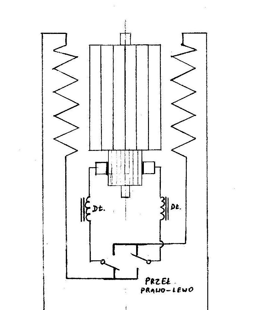

  • #27 17645946
    Pastor_PL
    Hello, I am sorry for reheating the cutlet, as a rule I read but I do not want to damage anything. I have an engine from an apparently old, still Soviet vacuum cleaner, but it works. There are 4 wires coming out of the winding, of which a capacitor and a brush are connected on one side, and the same on the other, and the third wire goes to the housing. What is it because I am more of a visual learner than an electrician, but I am not quite a layman, but I can do something there. The engine spins clockwise and my dream would be it spins counterclockwise. which wires do I have to change. Please help. Single-Phase Motor: Change Rotation Direction with 3 Wires & Starting Capacitor Single-Phase Motor: Change Rotation Direction with 3 Wires & Starting Capacitor
  • #28 17646012
    wojtek 9007
    Level 40  
    Posts: 3939
    Help: 711
    Rate: 847
    Hello - please swap the wires coming from the coils (motor stator)
    which are connected to the brushes.
    This is a series motor as in a hand drill.
  • #29 17646024
    Pastor_PL
    So this wire, which goes to the right brush in the first photo on the left, should be connected to the left brush, and the wire from the left brush to the right. On the principle of "kali to eat" capacitors remain unchanged?
  • #30 17646042
    wojtek 9007
    Level 40  
    Posts: 3939
    Help: 711
    Rate: 847
    Just as you write, here is a diagram of a drill with a ready switch.
