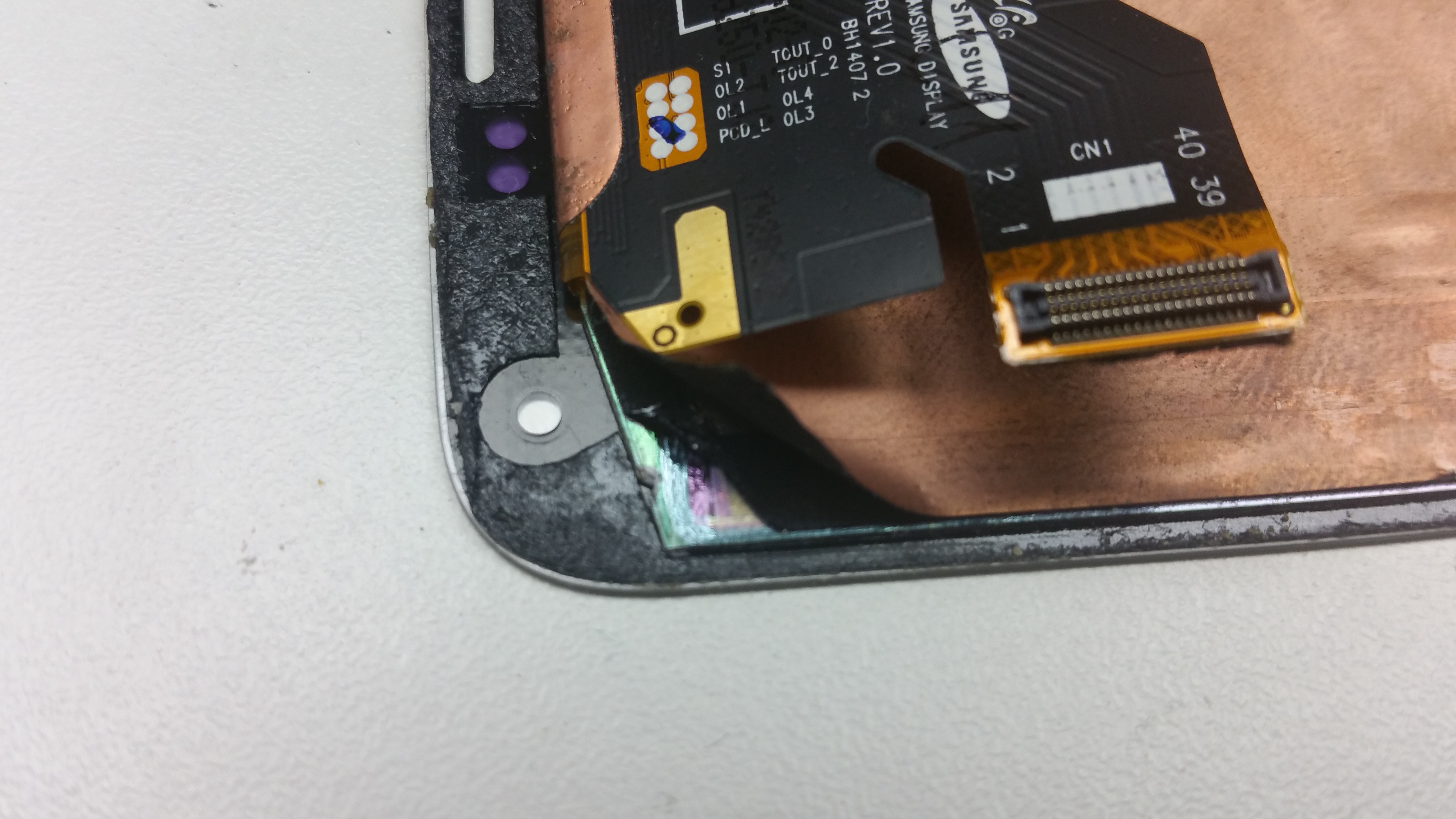

    The problem is that the phone works all the time but you can not see anything on it is just a black screen of messages and everything else comes to me on the phone. The phone has been bent and since then nothing can be done on it and I do not know what is causing the fault. Please help

    The display that needs to be replaced is probably damaged.

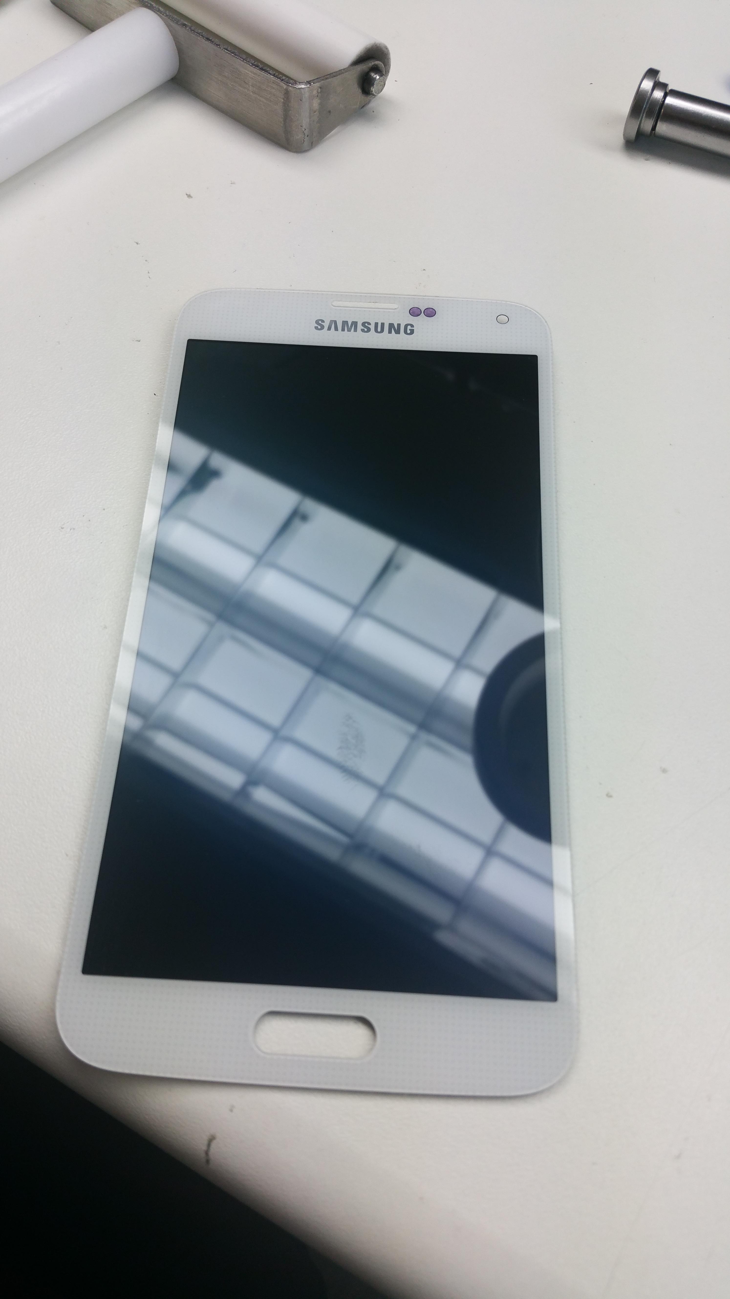

    Amoledy have it to themselves that just a micro-crack and "die" all.
    For example, display picture from S5
    Millimeter glass shatters in the back corner and display for exchange. Come in front of the ideation.
