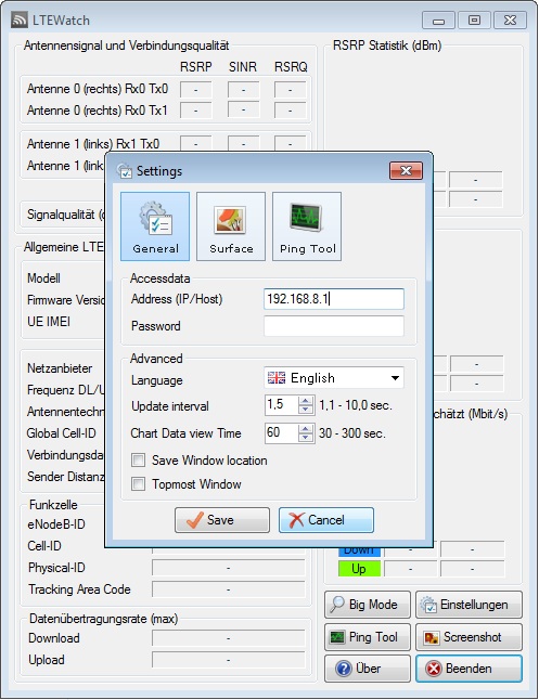

    LTE-Watch starts, after selecting parameters (language, IP) and pressing SAVE, an error pops up as below.
    Choosing the Right LTE Antenna for HUAWEI E3372 HiLink Modem at 1km Distance from BTS Choosing the Right LTE Antenna for HUAWEI E3372 HiLink Modem at 1km Distance from BTS
    I can't see anything in the Band tab. Maybe I'm doing something wrong.
    Is there a problem with LTE-Watch that it is so "spilled" the program?

    Use LTEWatchH
  • #7 16380421
    harylog
    Posts: 11
    Well, that explains a lot :-)
    I downloaded the correct one and it works, parameters as below:
