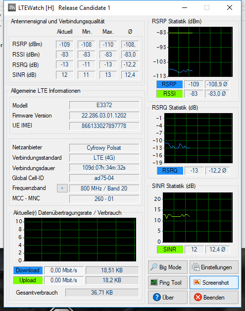

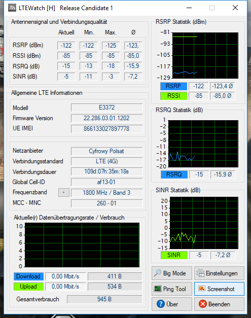

    Hello. I have a problem with the LTE band. I have an E3372 modem from a CP network.
    I bought a better antenna and would like to set a different band but in CP after connecting the modem there is no change option, only LTE, 3G etc. There is no option to choose between 800MHz or 1800MHz. How can I change it? Because no programs that I found and read through the forums do not work.
    I add a screan Huawei E3372 Modem - Changing LTE Band (800MHz/1800MHz) on CP Network with Improved Antenna

    And why such a statement you use LTE800 at all? Don't know why you forced LTE-A on the modem with LTEWatchH and the B315 does not aggregate bands, force LTE800 then LTE1800 and show screenshots. These tests are with this broadband invention pretending to be an antenna, who sold you this and what is it called? Which BTS have you set this wonder for and where do you want to use Plus? LTE signal parameters tragic.

  • #6 16535311
    matek451
    Posts: 31275
    Help: 4356
    Rate: 5816
    You bought some scrap metal and you don't know why you don't deign to provide the location. On the first screnee (this Band44) you connected to BTS LTE1800Aero2 Kapino. Another of LTE800 is a connection with the only active BTS LTE800sferii in this area, i.e. BTS Lisewo. On LTE1800 on the last one is BTS LTE1800 aero2 Warszkowo. Probably recently Plus has launched LTE1800 on it. At 1800MHz, the signal practically excludes proper LTE Plus / CP operation. On LTE800 better but without crazy if with antenna. By the way, what are your problems with LTE from CP?

  • #8 16535594
    matek451
    Posts: 31275
    Help: 4356
    Rate: 5816
    Your problem is that you have chosen a weak operator, in addition with poor equipment and the next is that you listen to consultants telling nonsense. Even their coverage map has not been working for several days http://www.cyfrowypolsat.pl/oferta/internet/mapa-zasiegu.cp CP has never offered antennas because these AKc2uni are hard to think of as such. But the biggest thing is that you bought another shit, not an antenna. Hand it over and buy a Dual LTE antenna for 1800MHz. Set up BTS-y Warszkowo and then Lisewo, force LTE1800 and check your speeds. On LTE1800Aero2 has 20MHz bandwidth in MIMO and on LTE800 Sferia only 5MHz in MIMO. The decrease in speed is caused by the increase in load on BTS. RSSI does not matter, other LTE signal parameters count.

    You didn't buy the antenna but the silencer, and you didn't specify what the invention was. You have LTE1800Aero2 in Warszków 4km to BTS and the signal parameters on this scrap are tragic, probably worse than without an antenna. It is the same on LTE800 Sferia from Lisewo, 5km to BTS and the signal for this band is weak. And a colleague has the same idea about mobile internet and equipment (choosing E3372 is a misunderstanding) and offers like you. This is a bad advisor, the operator's choice is preceded by tests on the LTE phone with the Network Cell Info application and pre-paid cards. In Rybno there is LTE-A coverage in Play with BTS-a LTE1800 + LTE800 Gniewino (lookout tower), LTE2100 also works on it and there is a permit for LTE2600. Orange and T-mobile have coverage on LTE800 from BTS NetWorks Tadzino / Lisewo or Kartoszyna and Lubocina. An 800MHz antenna is needed for LTE800. Effective Dual LTE1800MHz antenna works like this https://www.elektroda.pl/rtvforum/topic3346947.html, of course, it is about http://www.cybertech.com.pl/p130,antena-dualna-lte-4g-15dbi-do- Huawei-e3272-e3372-mimo.html
