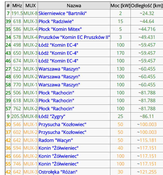

    Welcome. The above subject brings me to a white fever. In a single-family house, there has been a problem with terrestrial TV reception for about a year. I have a mesh antenna (about 20 years ago) and until recently everything worked perfectly. Recently, in the evening, there are always problems with the reception of most channels. It lasts from around 18 to 22. The antenna is on the amplifier. What could be the reason for this situation? The house is standing in a field, it is rather unrelated to the disturbances. Below the distance from the transmitters.
    Volleyball antenna and interference in terrestrial TV reception
    Is the antenna eligible for replacement? Or maybe replace the amplifier PCB in the box? Replace with a balancer? I have no ideas. If possible, I would like to avoid replacing the antenna. I will also add that it is quite difficult access to it, so I would like to prepare myself as soon as possible for her to repair, as I will take it.

    There is one more problem that Electro has to write a lot about: Internet access networks in LTE technology in the 800 MHz band, ie on +61 channels have been operating in Poland for about a year. All you have to do is have a neighbor with an LTE terminal within a kilometer or BTS operating in this technology and within this band within 2 km, you can say goodbye to using any broadband antenna amplifiers. Even if you exchange an "antenna" for an "antenna" and put on another amplifier, the situation may be the same or even worse.
    Maybe the first information you need is: where exactly you live, because that's where we know around Lodz. All you need is the position, name of the (small) town or a nearby intersection of streets.
    I suppose it's about Łowicz or around; in Łowicz itself you have 5 BTSs in the 800 MHz band - four Sferia and one T-Mobile. Friends from Lowicz have signaled to me that "there are eggs" .....
