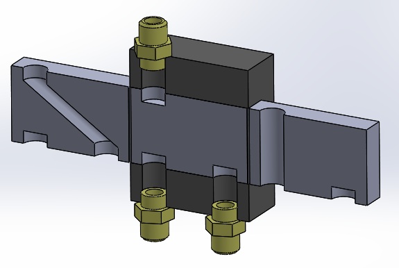

    For example, let's take the valve in your notebook
    Distribution valves. What are they about and how to read symbols
    This valve has 3 positions and 3 ways. You can imagine this valve as on the models below
    (cross-section of the valve is shown).
    Location 1
    Location 2
    Location 3
    The last figure shows the stubs which indicate the number of valve paths. As you can see, location no. 2 has all roads closed
    that is, the valve is closed in this case. Of course not (such a valve does not look like this in reality, but the diagram shows just such a solution). These types of valves are used to control the flow of gases or liquids in pneumatic and hydraulic systems, but you probably know this by the name of the item. :D
