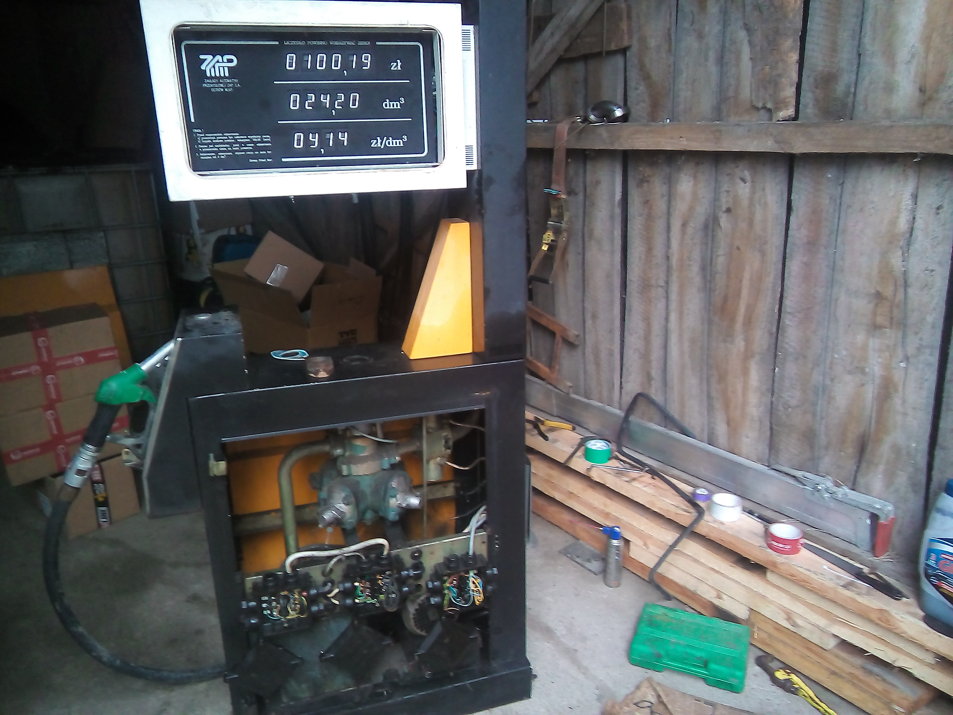

    Hello!
    I have a problem with connecting and starting the fuel dispenser. The engine works but the abacus does not. Please help.
    Fuel Dispenser Connection and Starting Guide: Engine Running but Abacus Not Working Fuel Dispenser Connection and Starting Guide: Engine Running but Abacus Not Working Fuel Dispenser Connection and Starting Guide: Engine Running but Abacus Not Working Fuel Dispenser Connection and Starting Guide: Engine Running but Abacus Not Working Fuel Dispenser Connection and Starting Guide: Engine Running but Abacus Not Working Fuel Dispenser Connection and Starting Guide: Engine Running but Abacus Not Working
  • #2 16381498
    kortyleski
    Posts: 12265
    Help: 957
    Rate: 3860
    Are you pumping fuel or dry?
  • #3 16381590
    phupawelkulesza
    Posts: 24
    Rate: 17
    Pumps dry. I connected the power hoses to the box on the left. The dispenser works even with the gun on the set. There are thin, unconnected cables in the box on the right, I wonder what the 230 V current should not be there? (Meter backlight, meter)?

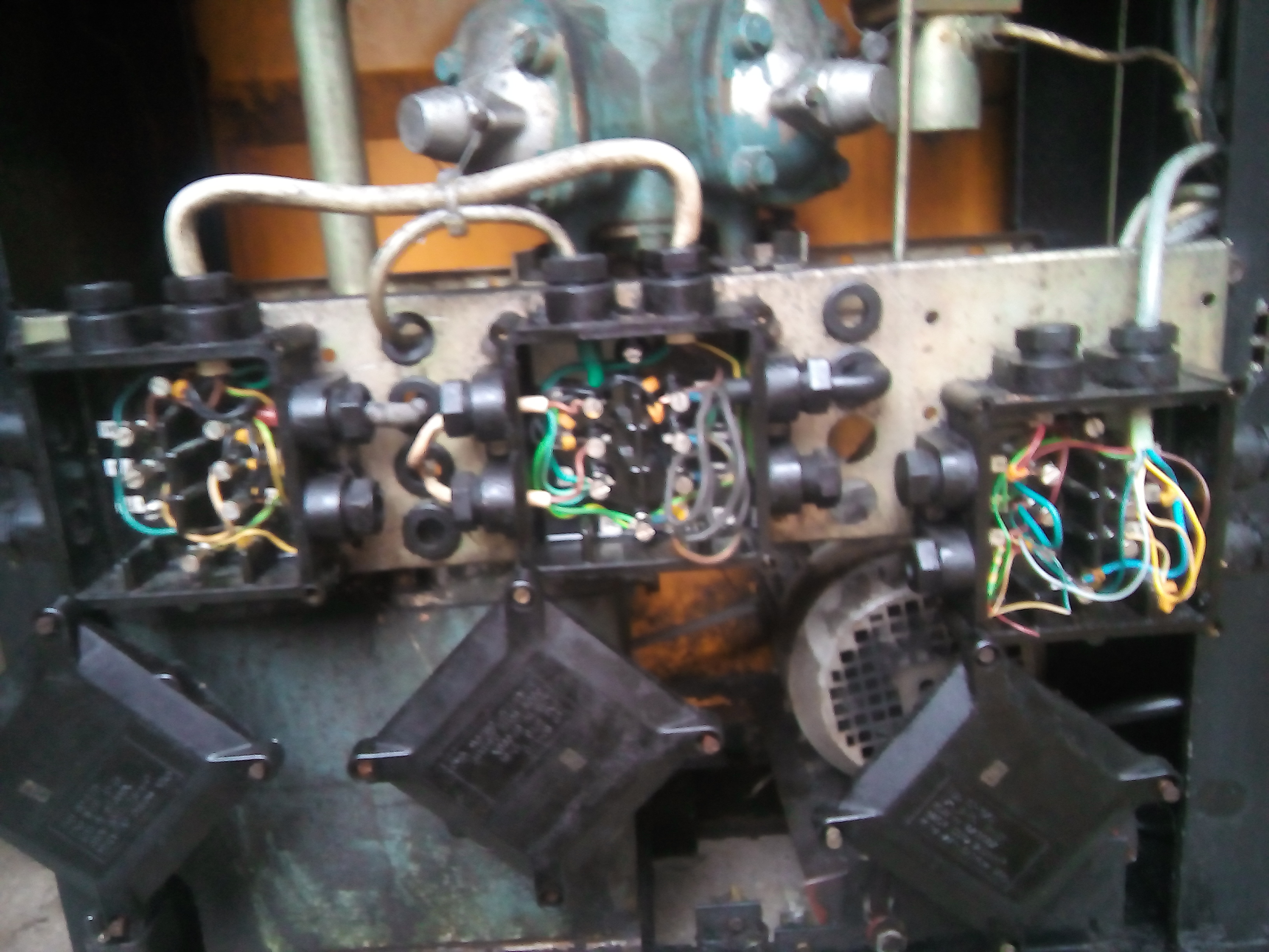

    Only the pump works. The cables were torn after removal from the petrol station and I probably made a mistake. The problem is with proper connection. Is there anyone in Masovian or Podlasie who knows how to connect? I'll bring the distributor. Please message on prv.
  • #8 17402841
    _rzeton
    This distributor needs an external pump motor contactor and thermic. After lifting the gun, it gives the phase that controls the contactor in the switchgear, from where the power to the motor comes.

    Posts: 12
    Hello, did you manage to connect the distributor? I have a similar problem
    in the tin, apart from the power supply of the 1in1, 1v1, 1u1 engine, I don't really know what they are on the other side of

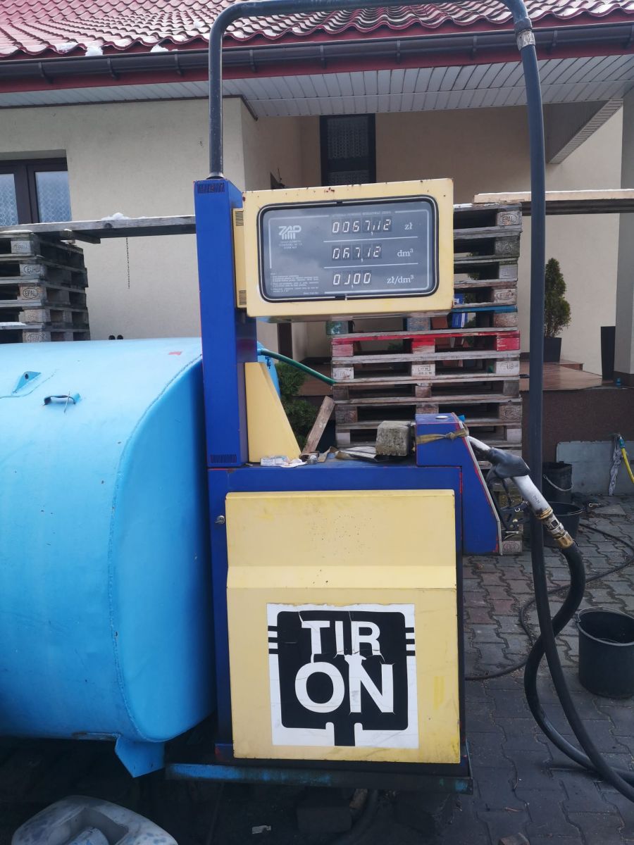

  • Intermittent 12V fault causing dispenser shutdown
    #13 20523386
    koniu2020
    I have a similar problem with our distributor, only ours has been working properly for about 10 years and now there is a problem, namely when refueling, the distributor stops refueling and after opening this, i.e. the cabinet, the 12V indicator flashes.
    After disconnecting it from the power supply and reconnecting it, the distributor normally sets the price and works correctly.
    In the last 2-3 weeks, this situation is repeated more and more often and the distributor will fill up once with 800-900 and other times only 20, 15 or even 2 liters ...
    I noticed that after a longer disconnection from the power supply, it works longer, but after several attempts, it refuels less and less and disconnects more and more often ...
    Please help or give me some pointers on what to look for.

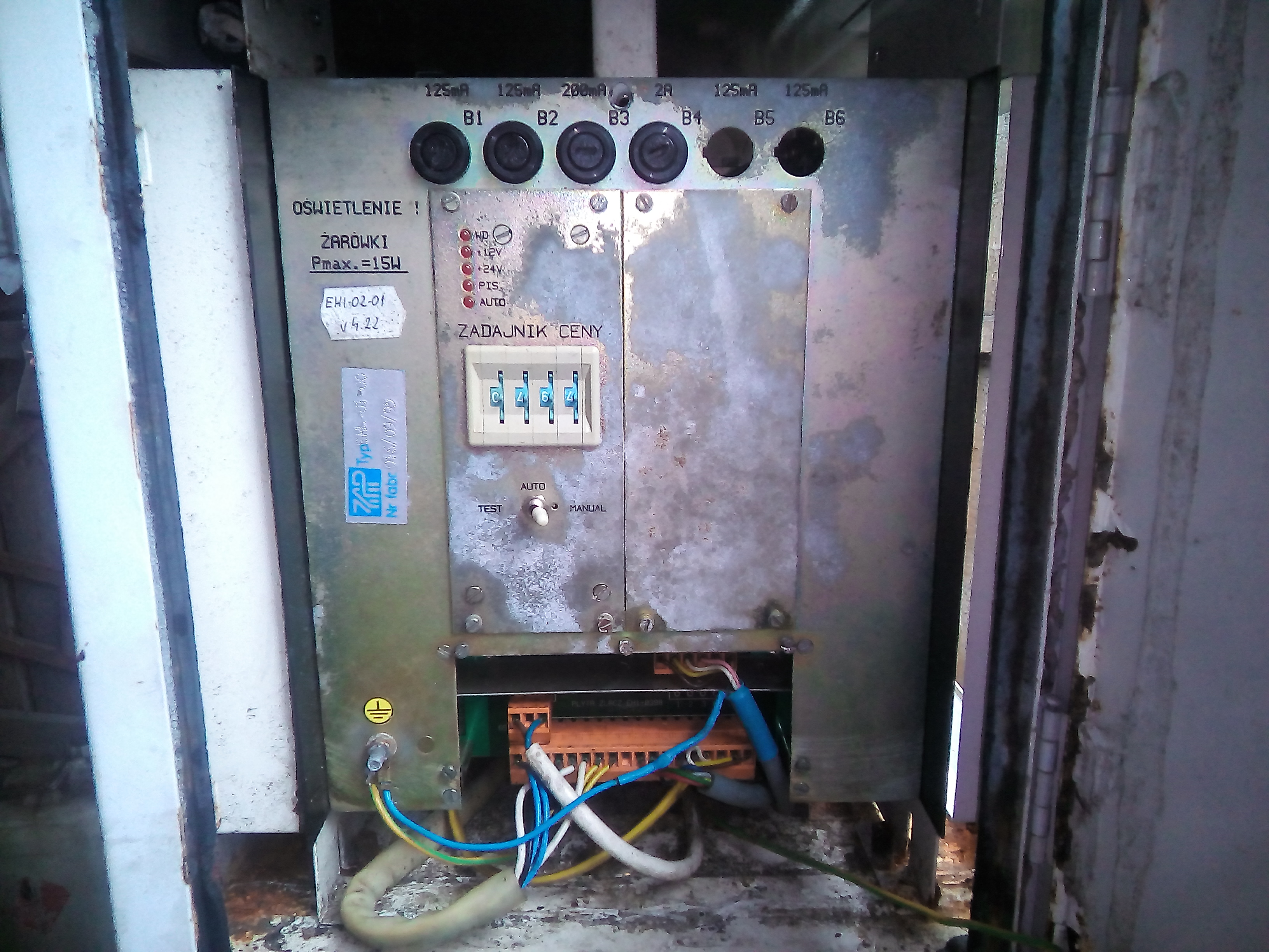

  • #15 20524523

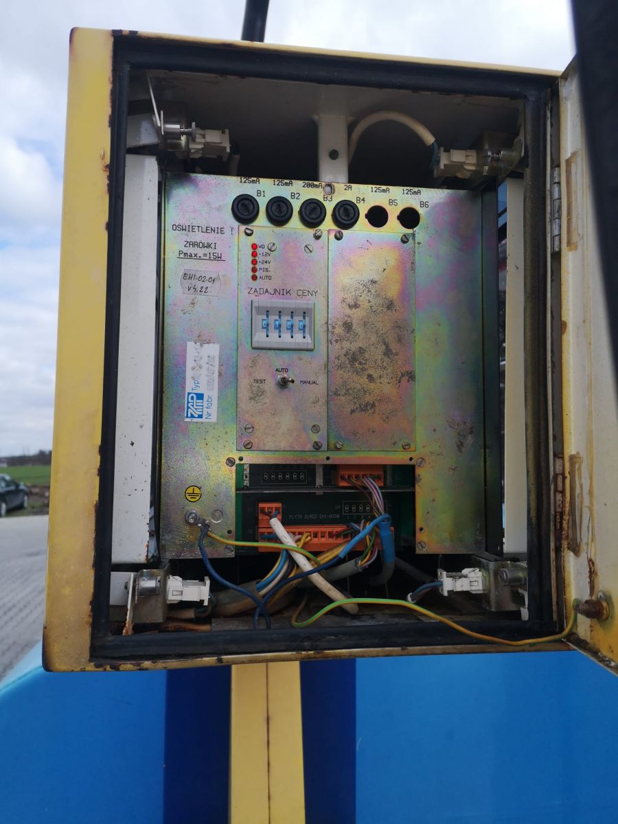

    koniu2020
    There is only one snake.
    No error pops up, just stops and the 12v light flashes ...
    I added photos Fuel Dispenser Connection and Starting Guide: Engine Running but Abacus Not Working Fuel Dispenser Connection and Starting Guide: Engine Running but Abacus Not Working Fuel Dispenser Connection and Starting Guide: Engine Running but Abacus Not Working
  • #16 20525234
    pal-dys
    Posts: 76
    Help: 5
    Rate: 38
    Middle picture, pull out the plug on the top right side of G2 after turning off the power. Turn on and see if the LED flashes. there it is connected; the first 2 wires from the left are the gun microswitch and then the pulse transducer.
    Added after 3 [minutes]:
    There should be 12V on pins 3 and 4
    Added after 8 [minutes]:
    Or disconnect the 4th wire from the plug and see how the diode responds.

    @koniu2020 After so many years (after the number it comes out that 1996) you can be sure that the electrolytic capacitors have completely dried up giving an unstable power supply. But it's nice that there is still a service technician who knows these machines. I would start with the power supplies. Especially if the distributor was turned on non-stop.
  • #18 20525590
    pal-dys
    Posts: 76
    Help: 5
    Rate: 38
    For now, I would check the 12V voltage because there is good access. You are right about the power supply but it is difficult to access and it is best to check it on the table. 12V powers the pulse converter, which after such a time has the right to fail.
  • #19 20527476

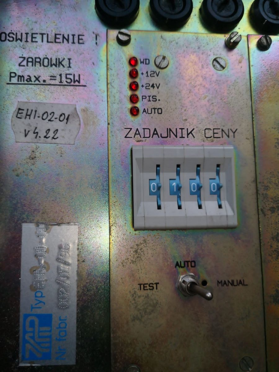

  • Manual control wiring for Nuovo Pignone dispenser
    #20 20579264
    mmin
    Posts: 12
    In my distributor with the Italian Nuovo Pignone pump (semicircular pump connected with the motor and fed from the top)
    I connected in the first box from the left, 3 phases on the left side (continuous power supply - in others through a contactor) and the upper right side (W1) control (I have a remote control relay) on the lower ones, from what I remember, the current appears after removing the gun - to the bulb or contactor but this must be checked.
    If the dispenser is from fuel, it is probably in automatic - computer mode, the cash register allows you to start it. you need a remote control with three buttons for the rs232 connector and reprogramming to manual control description, manual on the internet new remote control ok100 PLN
  • #21 20580187
    pal-dys
    Posts: 76
    Help: 5
    Rate: 38
    W1 electronics power supply. W2 lighting. Q pump contactor control output.
    Added after 5 [minutes]:
    In the picture above there is a price selector and an auto-manual switch below it. Manual runs without a cash register system.
