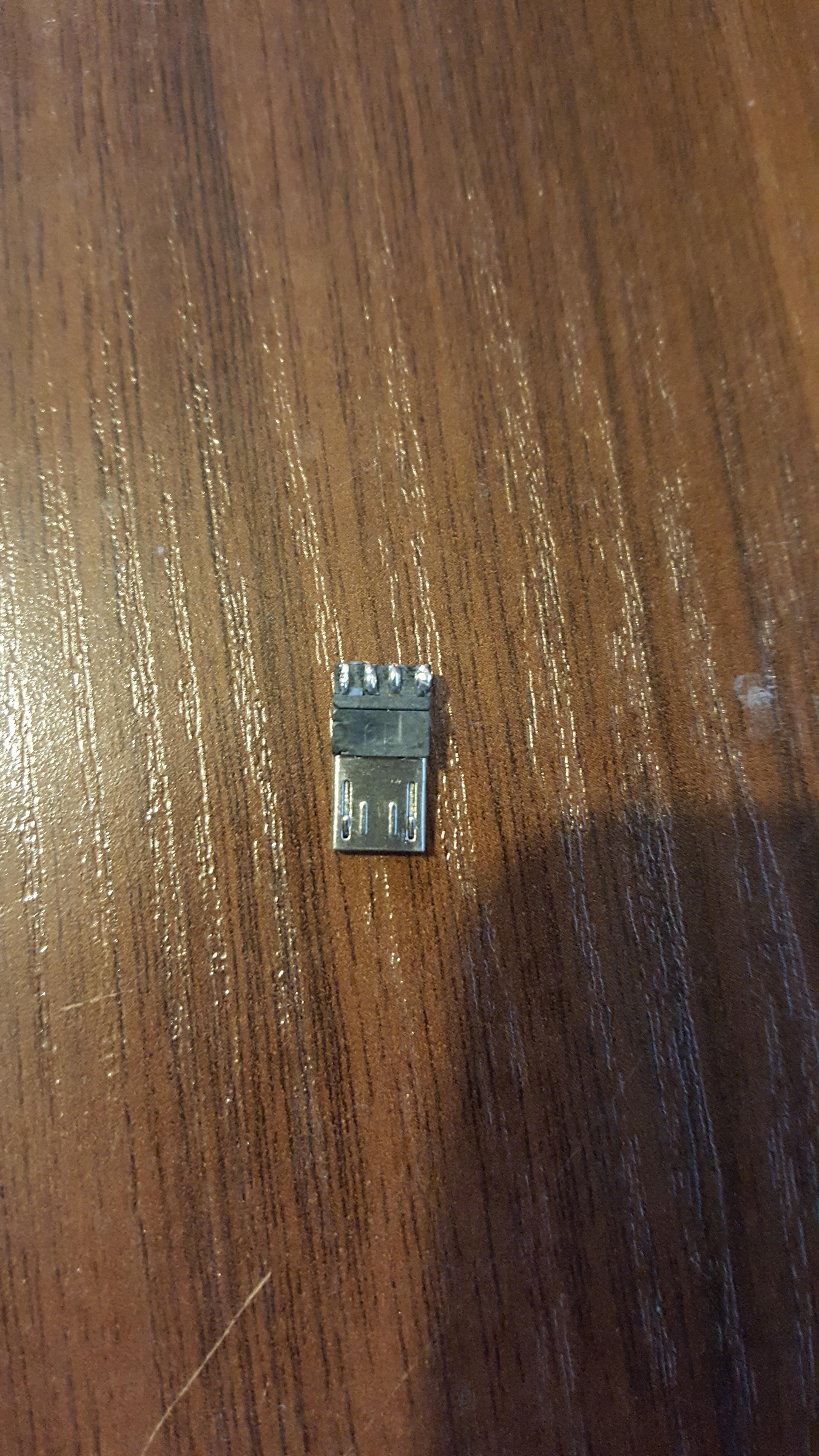

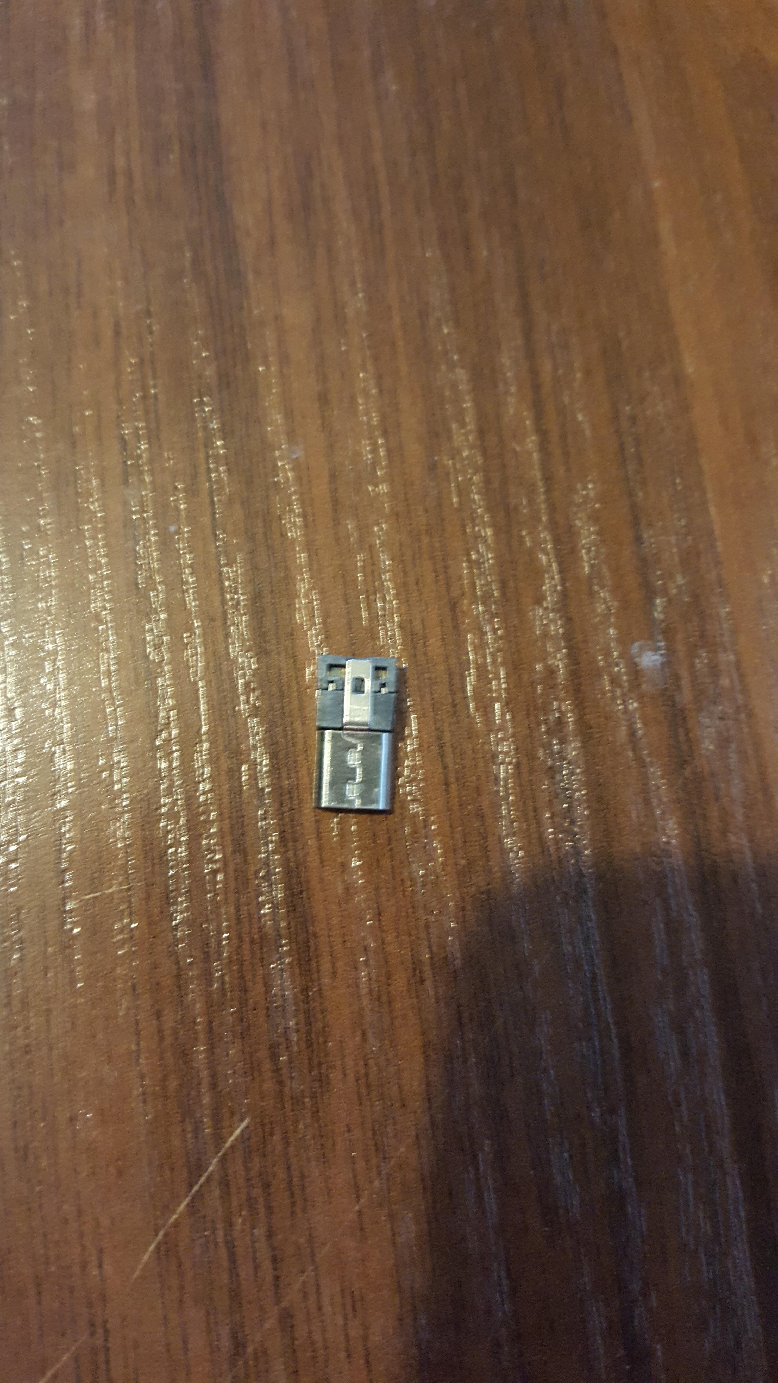

    I am sending you pictures, but my plug has only 4 pins, I should close 4 out of 5 (connect) so that the LED lights up.

    The stairs begin at this point. How do you have a phone, look at the microUSB socket against the light, how many pins do you have in it? You should have 5 pieces. Standard.
    Also check how many pins you have in your socket. See, because I met once or twice that these two pins were shorted directly in the microUSB socket itself.
    I will ask a stupid question, are you sure what you put in is microUSB? Pictures are blurry for me, just asking.

  • #9 16382194
    marci4
    Posts: 1290
    Help: 169
    Rate: 177
    The plug that you showed in the photos will not be suitable because it is only adapted to the data transmission configuration, where the device with the MicroUSB socket is a Slave, not an OTG.
    You need a MicroUSB plug with all 5 pins available.
