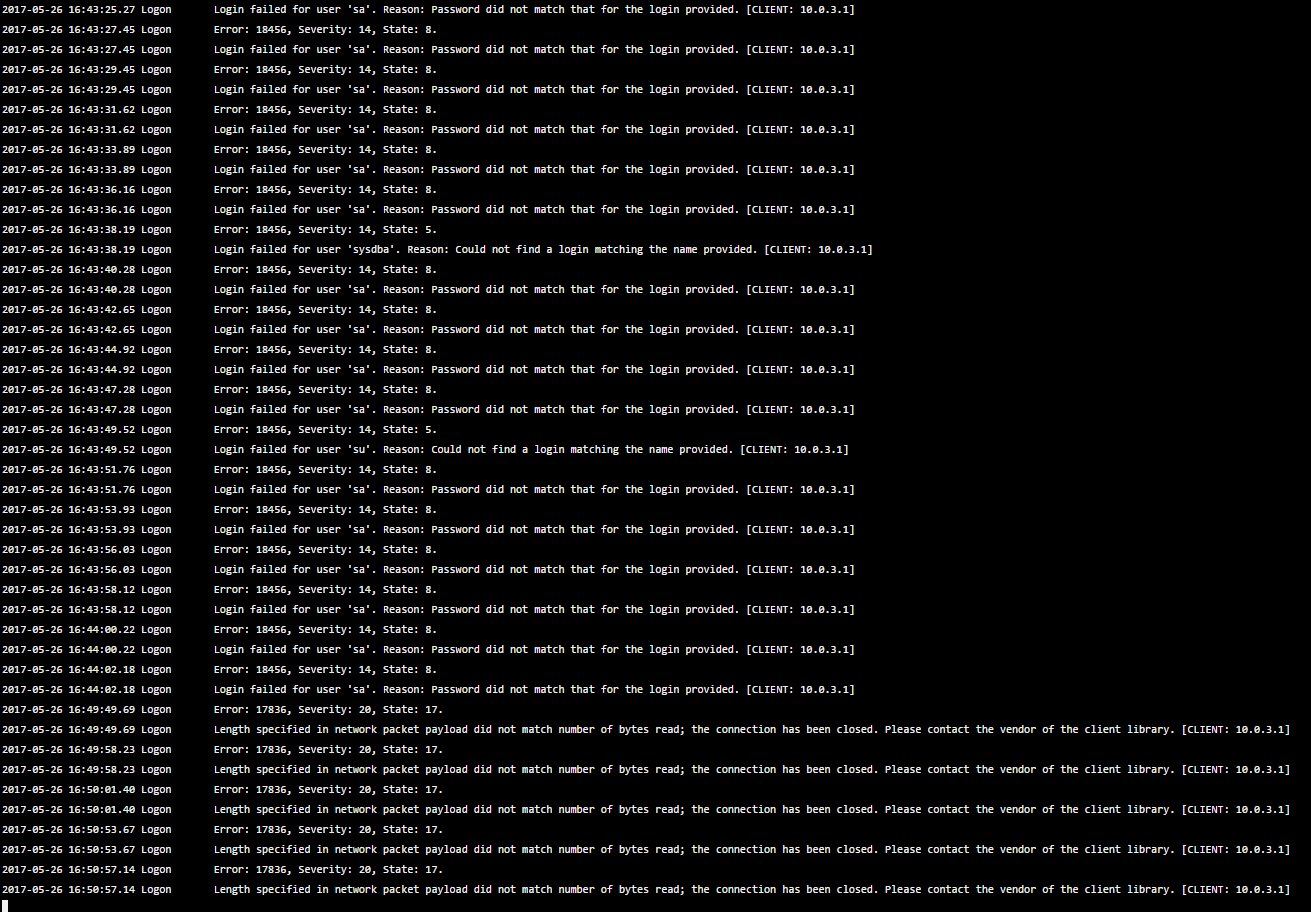

    Hi, I have an idea but I don't know how to implement it. I use the ELISOFT FAKTURA invoicing program which uses Microsoft SQL Server 2012 Express. Currently, all data is saved locally on my computer, I cannot use, for example, a laptop to issue invoices because I do not have a connection to the database on my desktop computer. My server on which the website is located does not have Microsoft SQL Server 2012 Express.
    I am a happy owner of the QNAP TS-251 recently. I came up with the idea to create a virtual machine on it, e.g. with Windows XP and install Microsoft SQL Server 2012 Express, then create a database, copy data from a desktop computer and connect to the SQL database.
    I read that Microsoft SQL Server 2012 Express does not work on XP (I think) so what system do you recommend (as light as possible) for installation on QNAP and will it work at all?

    Hi, I buried further in the topic and I was able to put MS SQL server on QNAP. I used a ready-made Docker + MS SQL set for this. So far it is stable, although I cannot open port 1433 to the world so that the database can be seen from the outside (via the internet). It works great in LAN.

    OK, I was able to open the world after 1433 after changing the router to the one from UPC. Now everything works fine, although I have a problem because after setting up the server, login attempts with all possible usernames started immediately.
    Is it possible to somehow protect against it?
