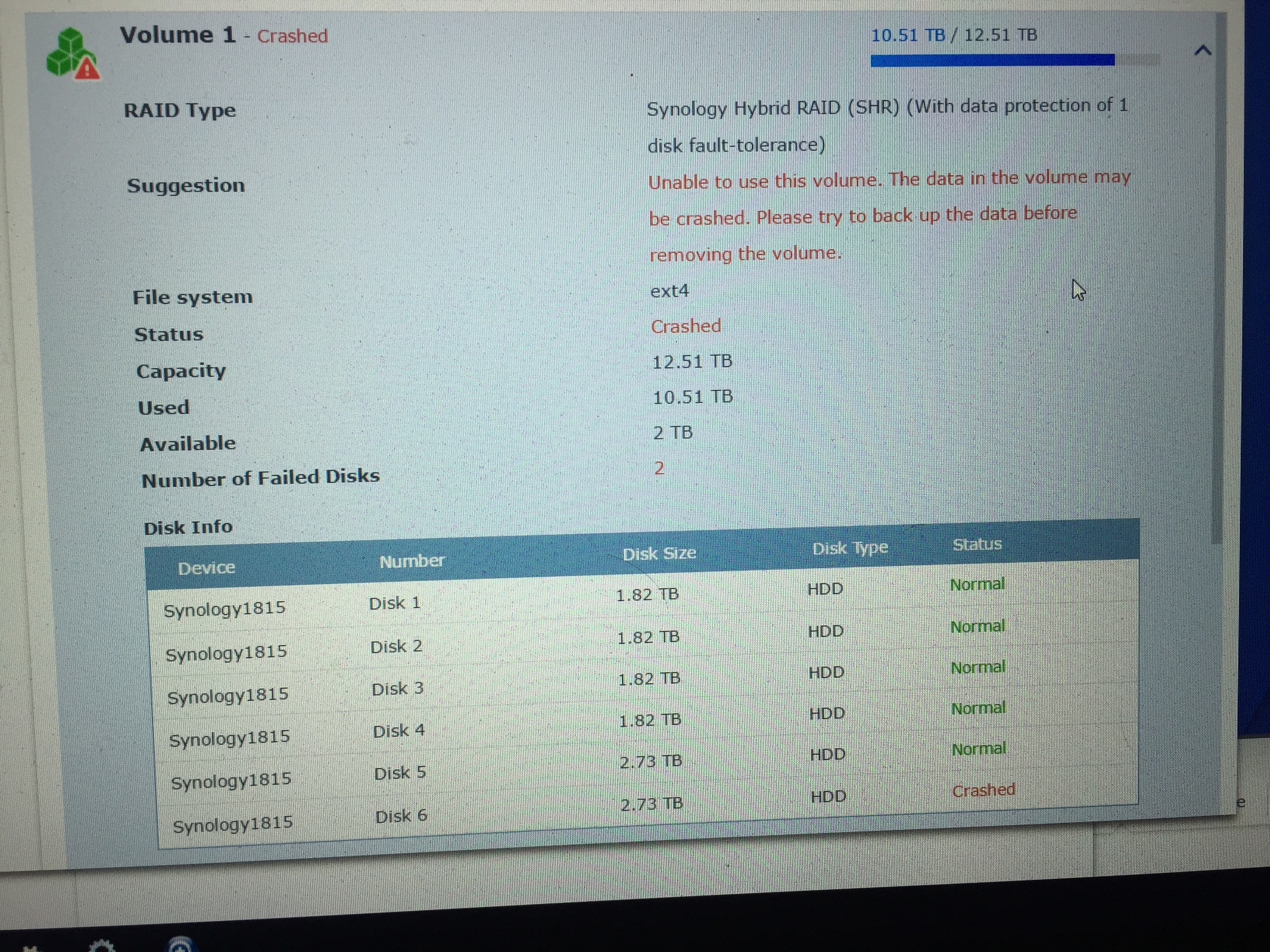

    It makes sense! :D I'll tell you how it looked from my perspective.
    I started with the simplest 1-bay server (Chinese), which I connected to the router with a cable - tragedy ... suspending / breaking connections, etc.
    The next choice fell on Synology J110, which still works today! The performance was decent, but there was a problem with lack of disk space (1 bay), so I bought another Synology 115J server and QNAP 219 IIP, with time running out of space ... Synology DS213 AIR (Model with WIFI) came. There is no space again ... so I thought once I was alive and bought 8-bay Synology 1815+, I packed 6 2-3TB disks (WD Red, which I will mention later) and fire everything beautifully for about a year - no space, I bought another RED 'a, I put in and expand the matrix (SHR, something ala RAID5) and zonk! New WD RED 3TB drive fell ... I replaced with new HGST this time and during repair / extension bang the next WD RED fell (2TB 6000 hours worked) :( , so RAID5 and 2 disks = data loss, luckily it was copied post-sectoral. I recommend reading reviews about WD RED in foreign forums (not in stores).
    Home NAS for Data Storage & Security: 2TB RAID 1, WiFi Connectivity, Cloud Backup, Streaming Movies
    Based on experience, I decided not to risk it and bought 4x4TB HGST to copy the most important data and I succeeded, I finally lost about 10-15% of the data. I also learned that maintaining an 8-disk server is expensive.
    As for sending movies to TV, most TVs have a 100Mbp / s interface. 10 MB of real transfer is quite enough for almost everything (a problem may occur with some 4K movies), I recommend Plex / Kodi cool applications for transferring movies / music.
