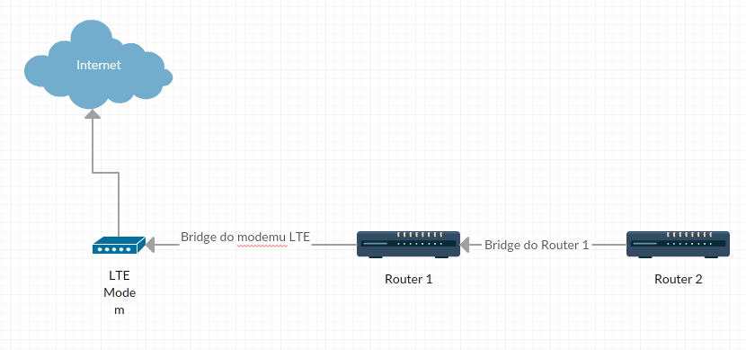

    I have a question.
    Now I have radio internet connected to one tplink router with wifi enabled and I have a second tplink router on which I set up a wifi bridge with the first one. On the first router I had to enter the mac address of the second router to make it go.
    I change the internet (I give up radio because it works poorly) to LTE. For now, I have a Huawei 5577 LTE router (or very similar, I do not have a model at hand now, but probably very similar.) As I have not seen the mac address to enter at the bridge in the settings, I have a question whether the bridge can be set up with this modem, as there is no this option, is this option just additional security in the tplink router?
    Overall, I would like to do this:
    LTE + WiFi modem

    Draw a toto.
  • #3 16395262
    gsawicki
    Posts: 107
    Creating a WiFi Bridge: Huawei 5577 LTE Router & TP-Link Routers - MAC Address Setup
    Something like that. Alternatively, I am considering the situation that both routers will be connected to the LTE modem (i.e. there would be 2 arrows to the modem) but I will have a problem with the location of the modem (somewhere between 2 routers) because the modem has a much smaller range than routers.

    Bridge over WIFI or cable? there is no problem with the cable any router with any router, with wifi much more difficult.

    Bridge over WIFI, both devices must support WDS.

    And what if the LTE modem does not support WDS, it is only possible to replace the modem, or buy a USB modem and connect it to one of the routers?
    #8 16395538
    bogiebog
    Posts: 24793
    Help: 2569
    Rate: 1530
    You can connect to the WIFI point (AP) by methods
    - WDS (bridge), requires WDS at the WIFI point
    - WISP (NAT)
    - AP client (almost bridge)
