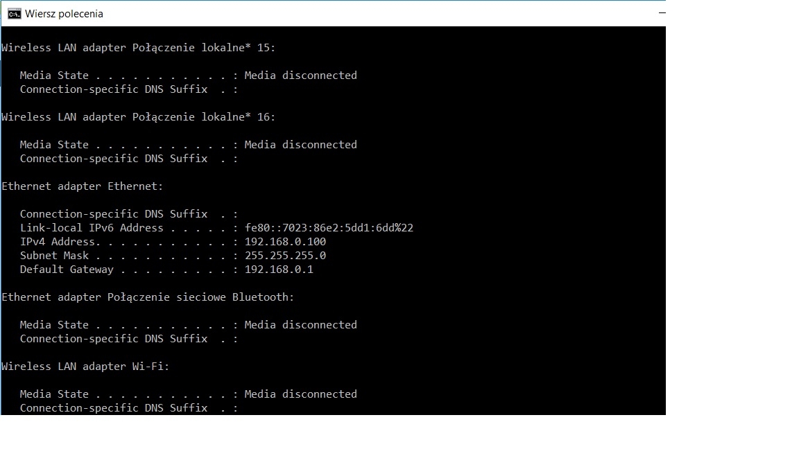

    I have a big problem with my home network. I changed the signal from radio to optical fiber. I got a new Huawei Echolite HG8546M router from the supplier. It worked until the technician left. WiFi problems started later. Sometimes it worked on all devices, sometimes on selected devices. Generally, the provider ignored the problem without solving the problem (I think that Huawei has a whack WiFi, and they are not obliged to provide the signal via WiFi only via the cable) and telling me to connect the existing router to Huaweia. I connected the TP Link TL-WR841N via the LAN port (because earlier on the radio they changed the settings so that I do not go to WAN). Everything was fine until I bought an iPhone that caught WiFi once and not - all other devices worked great.
    I wanted to change the settings, but I cannot get to the TP Link configuration panel in this configuration. I read somewhere that you need to reset it completely. I did it and now it turns out that I have neither access to it (I do not know the WiFi password on it), nor does WiFi work for me and I have to sit connected to Huaweia with a cable to have a network.
    I am asking for help how to connect these two routers with each other so that everything works, how to configure it, how to get to the TP Link settings connected to Huaweia, etc. Should I connect the TP Link to Huaweia via WAN or via LAN.
    I do not have access to Huaweia's settings because only the provider has them [/ B]

    I reset the TP Link, I connected my computer with a cable via LAN 2 and although I enter 192.168.1.1 or 192.168.0.1 or 192.168.1.0 I cannot connect to it. Every time I have a connection timeout.
  • #7 17378398

    Did you check if you got any address from the router's DHCP?

    And how to do it? Sorry, but I'm not proficient at all of this.

    Go to cmd and enter ipconfig.

    Configuring TP Link TL-WR841N with Huawei Echolite HG8546M for Stable WiFi on All Devices
    This is what I have now
    Added after 22 [minutes]:
    Okay. I changed the network cable and it went. I changed and works WiFi again.
