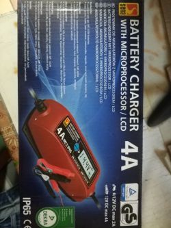

    Probably too little ampere, rectifier:
    A power supply for a car compressor or connecting it to a charger

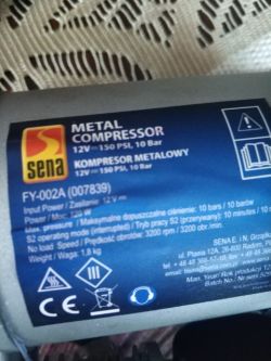

    And here's the compressor:
    12v
    120W
    I get out that he needs 10A?
  • #13 18557072
    398216 Usunięty
    Posts: 34295
    Help: 3925
    Rate: 9433
    I used to have a similar compressor to pump air into an airbrush. There was practically no load and the engine took about 4A. When inflating the balloons it can be similar - try to know.
  • #14 18557114
    majmajxD
    Posts: 56
    Rate: 17
    Exactly what I need for an airbrush.
    How to connect the charger to the compressor tip - cigarette lighter input?
    Plus to the lower "Dziubek" and Minus to the side gills?
    Will not burn the rectifier?
  • #15 18557190
    Manipulant5
    Posts: 91
    Help: 7
    Rate: 19
    Hello, buddy, MajmajxD, you will not connect any device to this rectifier except the battery, it is a microprocessor rectifier that needs a voltage output to run, and it is a bit awkward to connect someone to the topic, best regards.
  • #16 18557191
    g107r
    Posts: 5275
    Help: 810
    Rate: 992
    You need to read about the charger, what protection it has, and most importantly, will it work without a battery.
    I have an indicator, an ammeter, weakly active, but with a similar pump, just like the presenter wrote - it was ok 4A at ease ...
