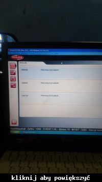

    Hello. The patient is Opel zafira 1.6 2000. The engine sometimes runs unevenly and falls off the speed. I will add that the coil is new. What are the codes?

    Do you have the opportunity to read this for Opel?
    delphi, autocom, wow etc can be wrong,

    I have seen such descriptions in Opel once in Delphi. Rather, it will apply to the detected random loss of ignition and loss of ignition on the first cylinder. If you want to confirm it, connect something else or you can still connect it with the same computer but from the main page via eobd. Does delphi see this live or does it show any nonsense?

    the problem was with the carbon deposits on the valves. I'm closing the topic
