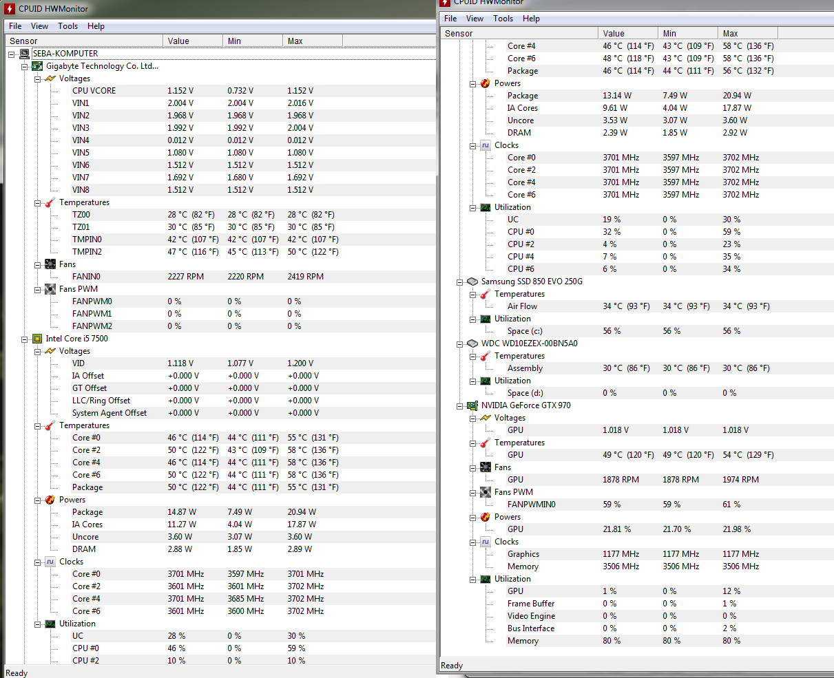

    I would have to check what the temperatures are. Will you advise which program is the best?
    Added after 1 [hours] 52 [minutes]:
    Games shut down by themselves. - The game starts and cuts out after a while
    While playing GTA V
    TEST DONE ON GTX 970.

    The temperatures are normal.
    What message is popping up on this BlueScreen?
    Check the event log if you see anything suspicious that may be causing this computer behavior.
