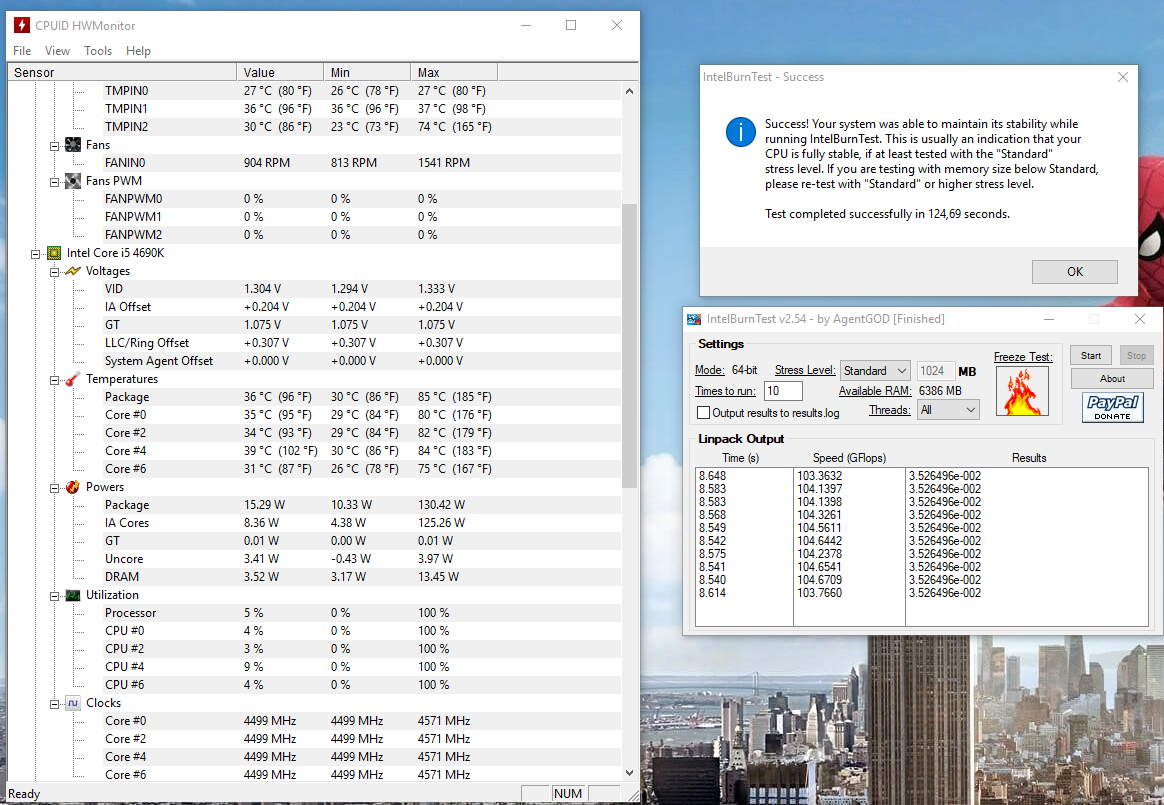

    Then do such a test. Install HWiNFO and run in sensor only mode.
    Do 15 minutes of tstu power supply in OCCT. After the test, give the HWiNFO screen of everything it monitors.

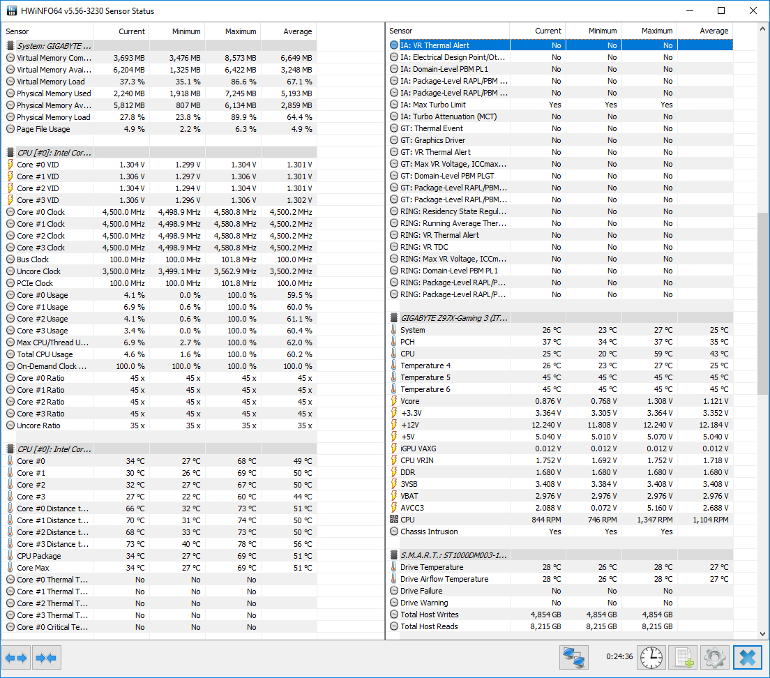

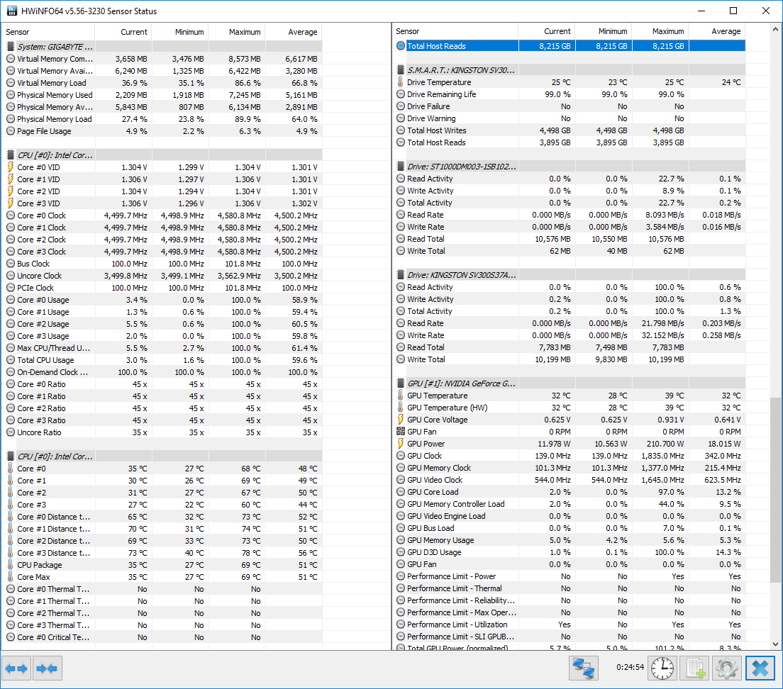

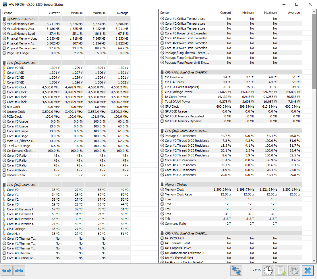

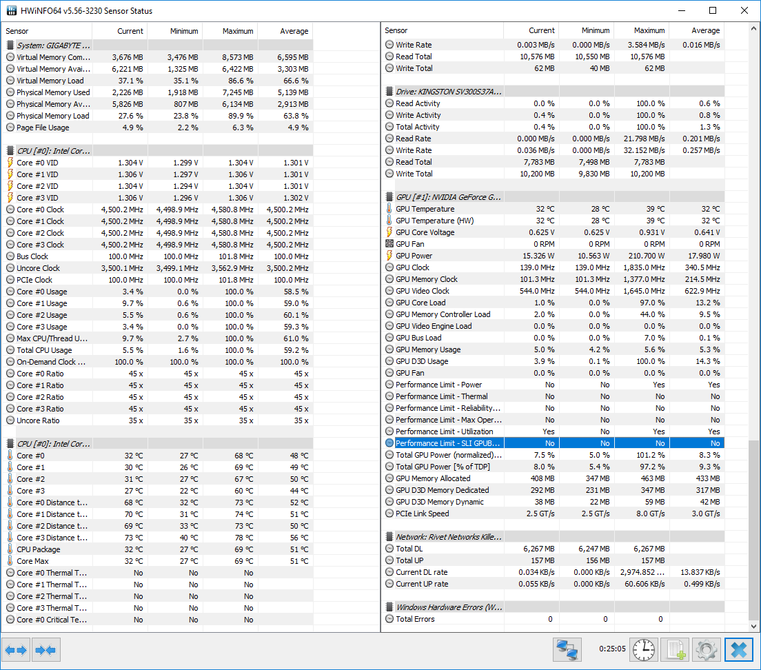

    Here you are. I changed the RAM to 1.68V. Currently, I have one 8GB cube inserted.
    Windows 10 - "Program has stopped working" in games Windows 10 - "Program has stopped working" in games Windows 10 - "Program has stopped working" in games Windows 10 - "Program has stopped working" in games
  • #6 16713030
    310artur
    Posts: 9002
    Help: 980
    Rate: 670
    Looks good. Measure the power supply with a meter to be sure because under full load it drops to 12V according to the program. I would expect more after this power supply. Over 0.4V drop, it may already mean that there are pulsations in the background. This machine is one bit of electricity it needs.
