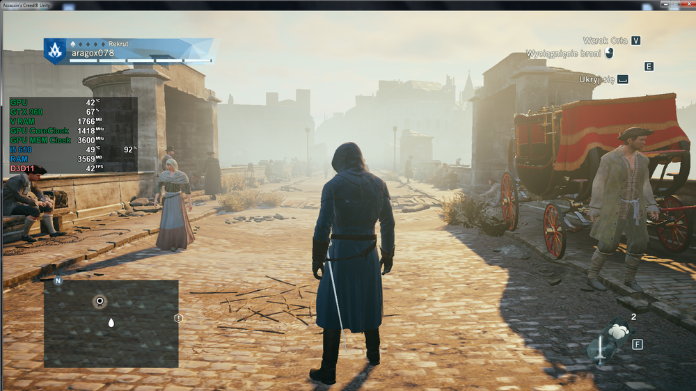

    Hello, I have been having a very strange problem lately. When playing, for example, Assasin's Creed Unity, it happens that the computer is turned off during the game. Also, recently starting the computer with the open part of the housing, I noticed that the fans of the graphics card do not spin, they are standing in place (while on the desktop). I set the RPM in MSI Afterburner and thought that with this option I would get rid of the problem. However, it did not help, it continued to reset the computer while playing. Hope someone can help me solve this problem. I also give a screenshot of the temperatures.

    • Computer Shuts Down During Games: i5 650, ASRock H55M-LE, GTX 960, Fans Not Spinning Issue 5cbc9b1bdae02_Beztytuu.thumb.png.9cf68d09b6386207804520aeb2c7457d.png (843.58 KB) You must be logged in to download this attachment.

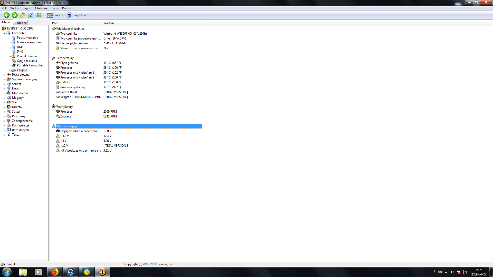

    Are these tensions about?

    Check in OCCT the power supply test if it also turns off, or do the remaining tests after 10 minutes.
    There is no need to measure voltages with programs, only temperature.
