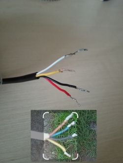

    Hello . I have a problem because I bought a lama for my trailer and I have a problem with connecting because the lamp wires do not match with colors and I do not know how to connect.
    Lamps have directions, position and stop if it is important. Please help me how to connect because I will have to go to one place and how without lights, I will not go. Here's how it looks like.

    Show the lamps inside as they have wires. But if according to beam colors and lamps are:
    white together - mass
    red together stop
    yellow left hearts to the green left lamp
    green to the green right lamp
    brown to brown lamp
    black to brown the second lamp -positional
    blue p.mgielne

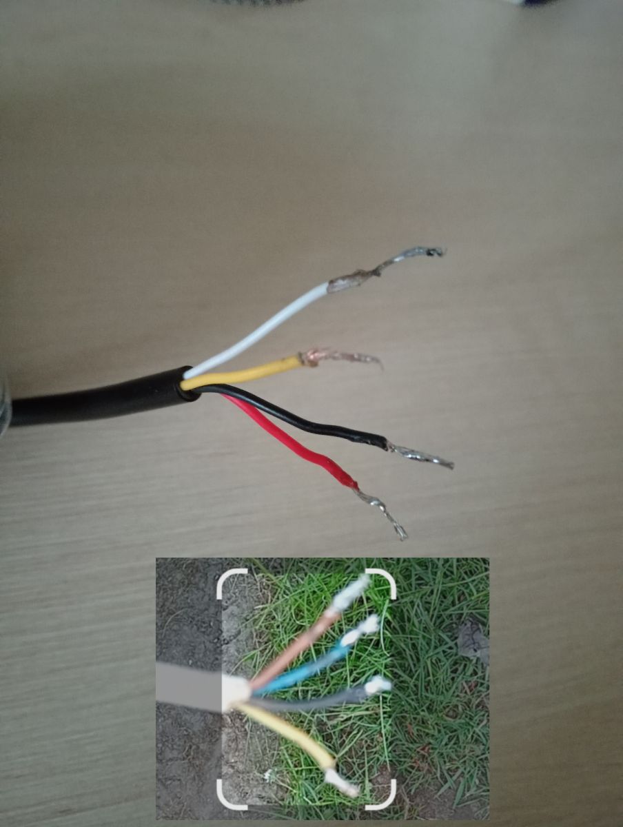

    >>16408293 .
    Close-up of wires with different color insulation and exposed tips; a comparison photo of other colored wires in the corner.
    Added after 1 [minute]:
    >>21555232 .
    I have this problem... How do I put this together?

    You don't have enough cables, a minimum of 7.

    This is the left lamp yellow indicator, black position lamp, white ground, red stop. The right lamp analogy is green indicator and brown position lamp. Plug arrangement you have 31 white,L yellow, green R , black brown 58 L and R. red 54.
    This is just a quick look at a typical connection. But things can be different in real life. Depends on what and who did it.

    But this is for one lamp.

    There are 4 wires per lamp.

    Ansylvia above you have a breakdown of the plug. To the lamp with the cables like a string. I don't think it can be any clearer. If you don't understand, contact an electrician. No one knows how you have connected the plug.
