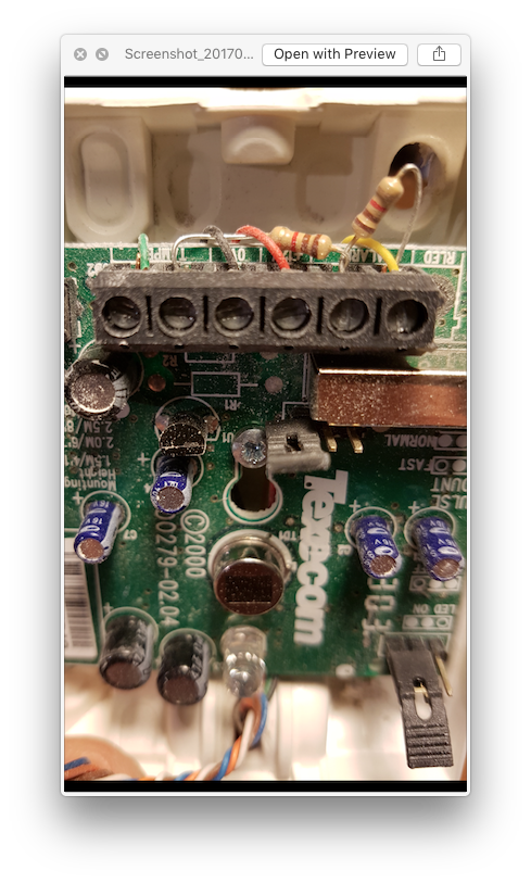

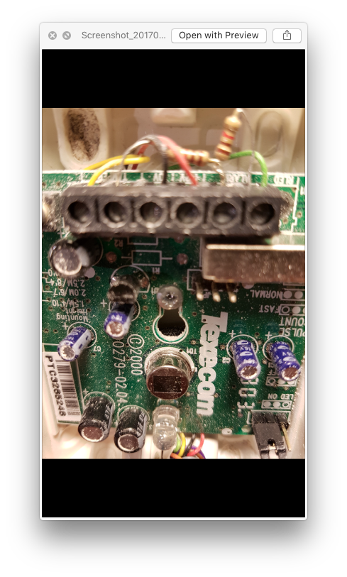

    momostg
    I unscrewed two detectors. theoretically they are connected in the same way except green and yellow ... unless it does not make a difference. does this mean that the connections are new and do not pay attention to the yellow and green?

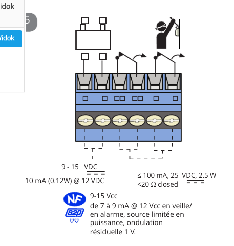

    I mentioned that I'm green in the subject. 1: 1 ratio does not work. The descriptions on the connections look like this. I am asking for the last hint

  • #7 16413561
  • #8 16413602

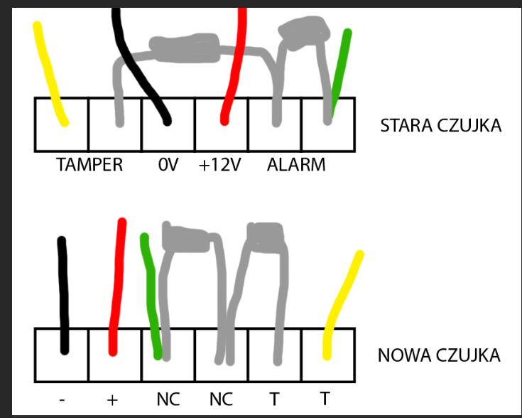

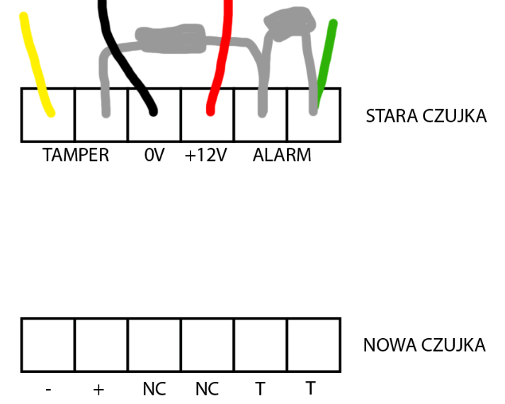

    momostg
    I understand ... I'm trying, I think. nevertheless, I want to make sure. is it to be postponed as in the diagram below? because the instructions are like this

    #9 16413612
  • #10 16413724
    momostg
    sharp wrote:
    You drew it well.
    success. it works. I bow low to everyone.
