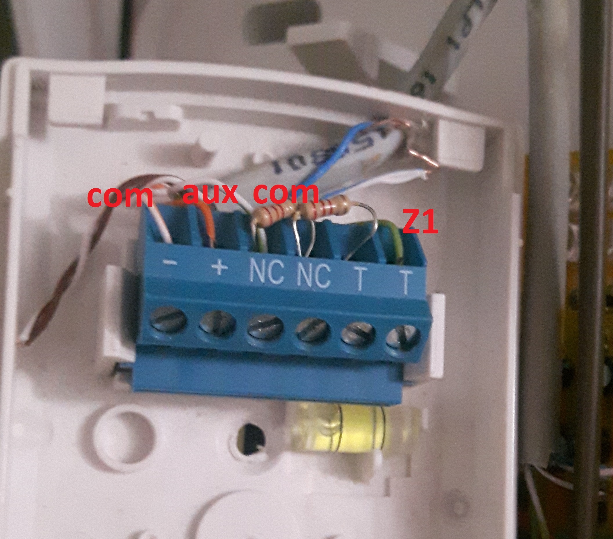

    I'm setting off my first alarm. Central control unit versa 10 Bosch sensors. I fired everything, connected the sensors in the NC option and everything is fine. I do it on the table to assemble everything where it needs to be checked. And now I have read and I came up with the idea to connect the sensors in the 2EOL / nc option and here I have a small problem.
    When I connect the sensors in this version, even if I have an unarmed alarm and go by the sensor, it crashes the zone 1 alarm and the name of this sensor.
    The alarm occurs only in the keypad, the siren does not activate. The program will erase the tamper of this sensor. I connect the sensor like this:
    Satel Versa 10: Connection & Troubleshooting 2EOL/NC Detector with Bosch Sensors (Zone 1 Alarm)
    Do I have something wrongly connected or something with the configuration.
    After connecting in this way, I select the 2EOL / nc detector in the program.
    I don't know what's wrong.

    It was 2.2 ;) I put in 1.1 and it's ok.
    It's that simple ;)
    Thanks.
