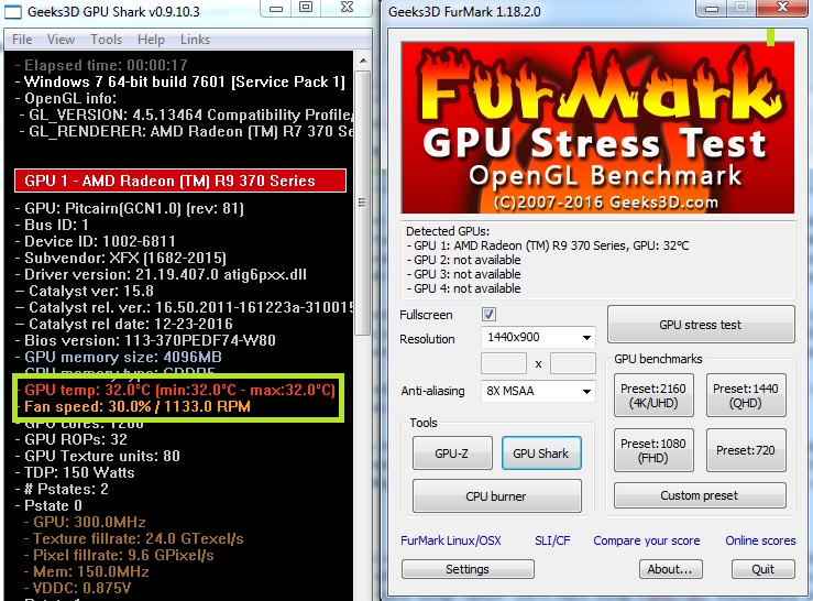

    I would check the GTX 1060 card and how to turn on the fans after exceeding the temperature, how they start and at what temperature (from 45 to 50 and from 55C after exceeding to 60C) you can observe in the program FurMark and using monitoring MSI Afterburner .
    - at a temperature exceeding 60C the fans should run at ~ 50%
    - at a temperature up to 50C for ~ 30% -40%
    The FurMark program presented above is being tested by loading the graphics card at 99% here you need to pay attention to the temperature, so as not to damage the card, requires efficient cooling !!!! The program has a bookmark GPU Shark , i.e. card temperature monitoring and fan speed in% and RPM.
    FurMark is a program for checking temperature and testing after replacing paste and fans up to 5-10min max.
