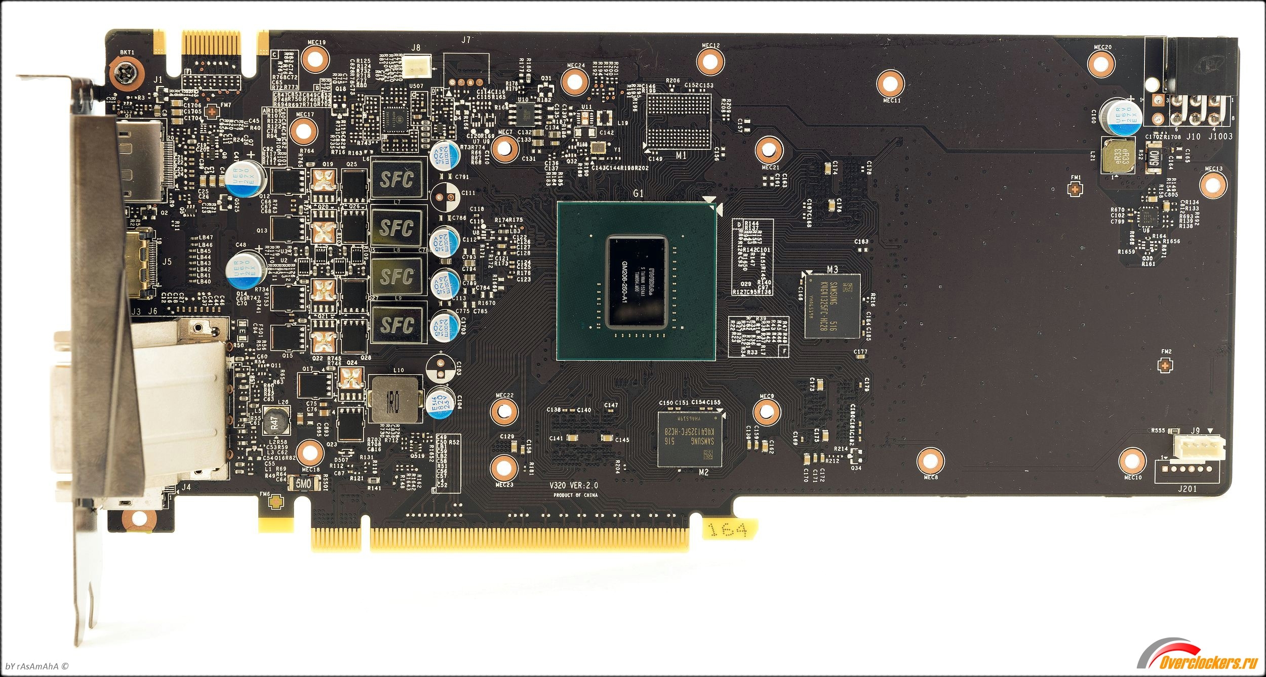

    Hello. I have a fairly serious problem. My graphics card fans are not spinning. So let's start from the beginning. My card is EVGA GeForce GTX 960 4gb. Well, calmly playing the game do not know why suddenly my monitor went to sleep at the same time issuing sound from the system (something ala pop-up window in Windows, not error.). I thought it was worth installing new drivers, but it didn't help either. Each time the game was fired, the image would crash and only reset would help. On the next few attempts, the computer started up but did not display the image. I had to wait a few minutes and only then fired. Then I came to the conclusion that something must be with the system, the graphics card may have a fine temperature, but the system reads that it is too high and the monitor turns off. The strange thing is that the computer still works, the sound is just the picture turns off. I decided to open the cover, remove the card, blow it and try to start the game again. And here it turned out that the fans from the card are not spinning. What could be the reason, or could it be the fault of the system? I have Windows 7 Professional, MSi H81M-P33. I'm counting on your help. Greetings.
    This disc has DVI and VGA output
    Without this GTX card, do you have a picture on both outputs?

    GTX 960 is a graphics chip (GM206-250-a1) / or (GM206-300-A1) NVIDIA BGA
    Something ala
    - Graphics card fans are not spinning.
    APL3516a, RT9018B (1.8V), GS7103 (1V)

    See if + 12V comes to the GTX card (fan supply)
    - comes through the addition zloty and PCI
    :?: you have RT8802A link
    - his pin.12 is 12V
    - and you have 3.3V, 5V, 12V
    Voltage monitoring on the card is (INA3221)
    DC-DC for graphic power supply NCP81174
