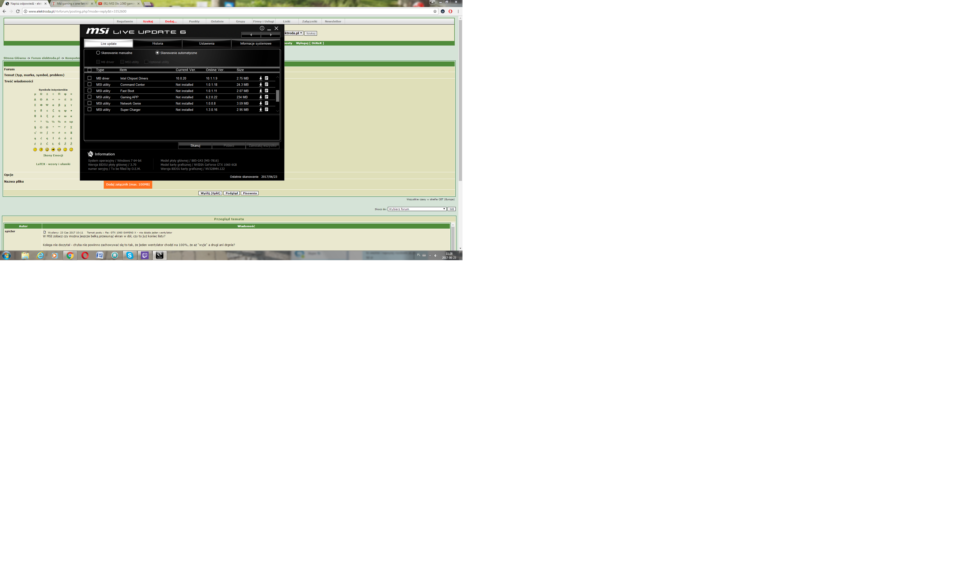

    I downloaded MSI LIVE UPDATE and I only found something like that
    GTX 1060 GAMING X: Non-Working Fan, Max Speed on Second Fan, Afterburner & HWMonitor Info
    I have improved the way of placing graphics. RADU23

    I don't know if I can add youtube video here, if not then delete it. Here it is shown exactly how it looks, it is identical with me, only that I did not play and did not turn the fan myself.
    https://www.youtube.com/watch?v=EOiX3QHFFQ8
    As for MSI, there is something to install below
    And at the bottom there are only some extras, nortons, etc.
    So then advertise this card or not?
  • #7 16549556
    spicter
    Posts: 601
    Help: 73
    Rate: 65
    I would advertise - absolutely do not interfere.
    Even if you gently turn the fan on and start moving, the situation will probably happen again soon.
    Even in this video there is a hint in the comments that this is not a normal situation and someone had a similar case in the GTX 970.
    Out of curiosity I checked my card and both ufff fans are spinning :|
